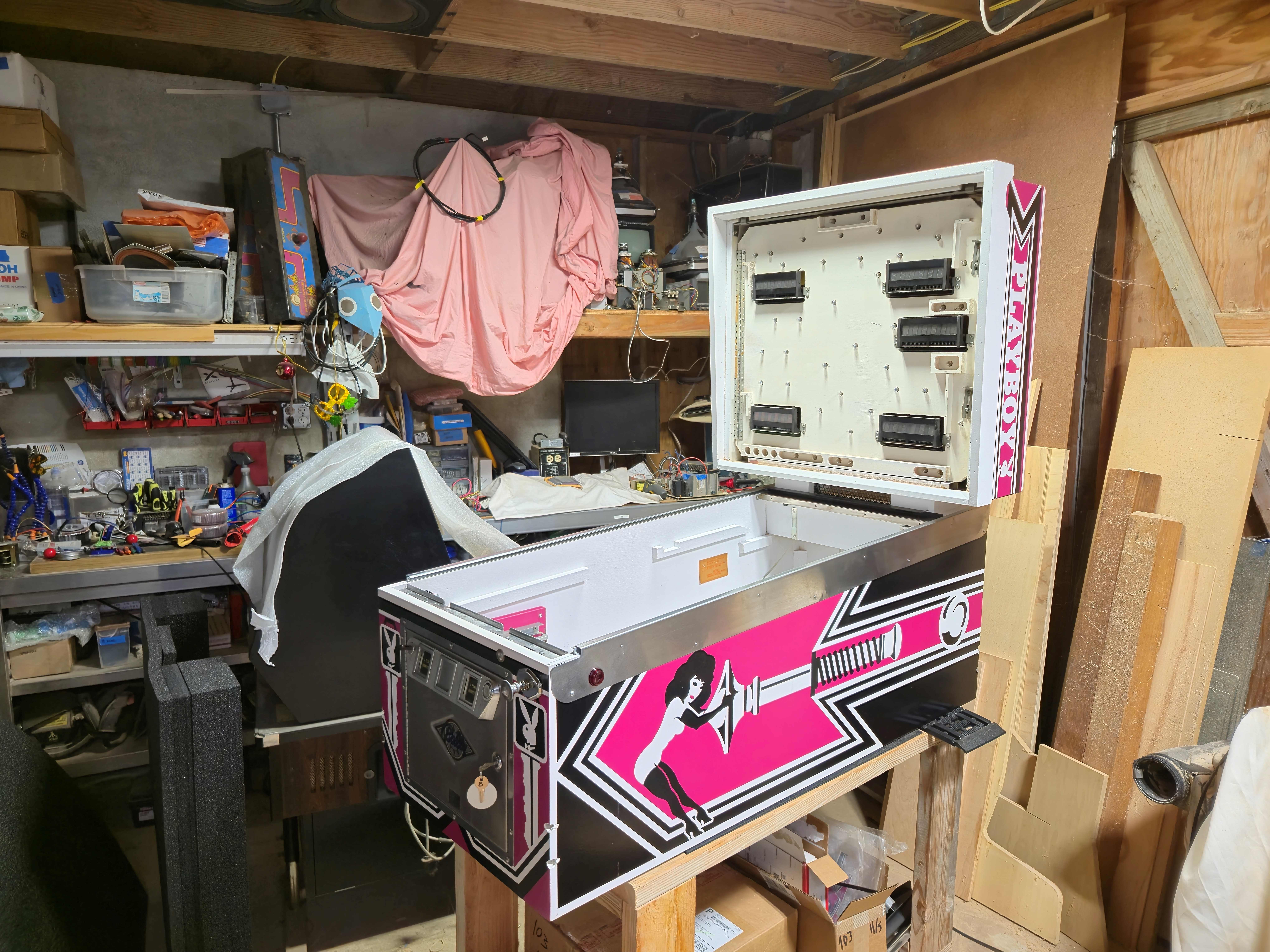

Termite eaten and sunburned of course, so I'm building a new box and got stencils.

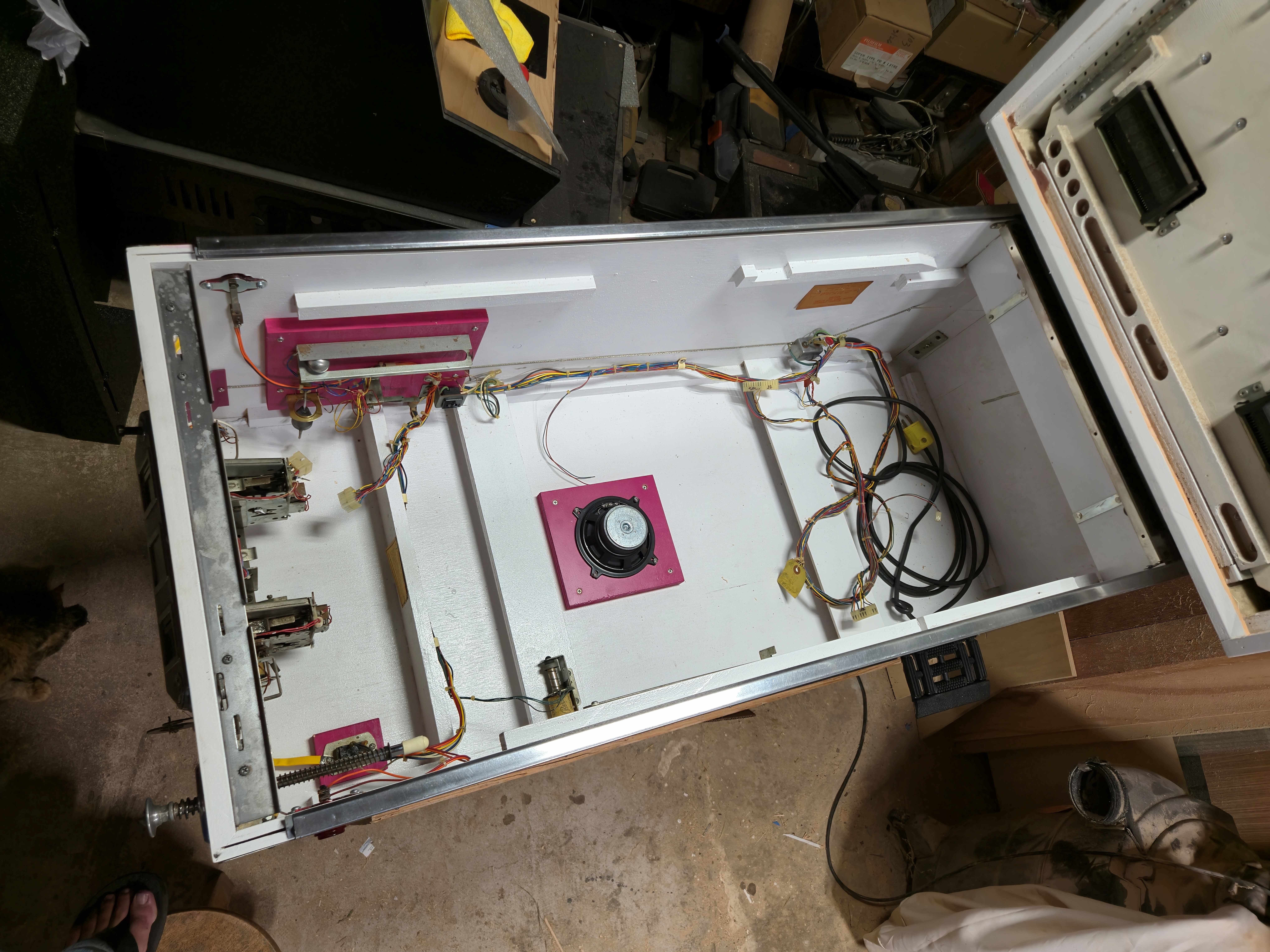

So I get the thing home and already I know that even though Guy had treated the thing for termites and there weren't any still chewing away at it that thing has suffered.
The bottom of the cabinet where the bottom dado was cut in was tearing off, the backbox support pieces were like paper mache' in spots, and there was enough termite crap that had spilled back into the coffin in transit that I knew the wood in a bunch of places was in pretty bad shape.
Well, ---steaming pile of meadow muffin---, it's only a box, right?  Has to be easier than a video game cabinet, no?
Sure, the magenta color is completely burned out of the cabinet art, but at least I have an original to work from.
Turns out, there are a number of interesting details to a pinball machine cabinet, epecially if you are going to re-engineer it slightly so that you don't have to buy a few really expensive router bits (and maybe you are a little impatient too.)
A little glue and head scratching later and...
But of course if I am going through all of THIS trouble then I can't just leave that nasty playfield (which it turns out has had a bunch of termite damage also) in a NEW cabinet, can I?!
And, the slippery slope steepens.

I finally (after 4 tries at the saw table last night) succeeded in milling out a new bottom channel piece for the backbox which carries the glass.  That seems to be the only part of the backbox that termites destroyed.
Man was that a pain in the ass to get right.
I also got another coat of white enamel on everything, which was easy on the new coffin but getting the layer of nicotine and latex crap that someone rolled onto the backbox off sucked.
I need to go roll out those stencils so they'll be easy to work with since hopefully this coming week I can be spraying that thing.
Maybe one more layer of white rolled and sanded out and then a last coat of white sprayed for flatness and should be ready for color stenciling.

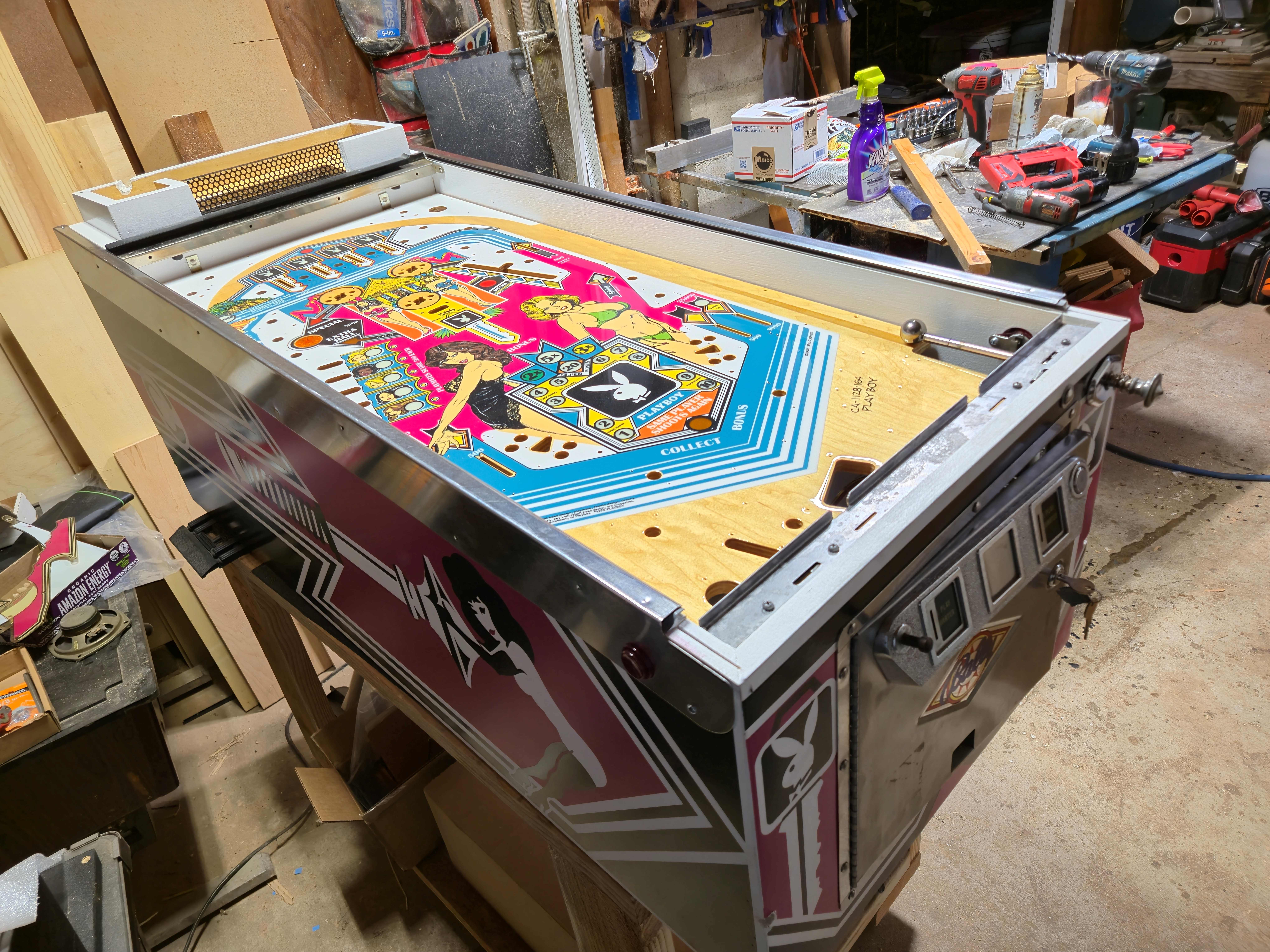

Today's unexpected excitement was working on the playfiled rails.
When I rolled the thing over to pull the screws out I discovered that... there were no screws.
Somebody had glued these things on at some point- which I suppose makes sense, given that they were probably as violated by termites as various other parts of this box.
And I thought I was finished with all the wordwooking for this project.
So I got the reproduce those silly rail pieces too.
Joy.
At least they came out ok and were an excuse to actually get to see this magenta colored paint in all its glory.

I also had gotten around to getting both of the rotisserie things built so I could get these playfields in a spot to start swapping stuff over.
I had forgotten that I really should seal the bottom of the new one with something so it got a really light coat of spar varnish.
Was afraid to roll it on and have gobs dripping though to the topside and destroying something so it got a really light brush treatment.
At least now MAYBE I can start pulling stuff apart now?

I finally got some color on this thing.
The extraordinarily irritating part is that I apparently hadn't ground enough of the old crap off of this thing and someone had rolled latex paint onto the thing it appears.
When I pulled the masking off it took a bunch of my base white with it.
 :banghead:
It looks decent from afar after the pink but the other side is the crappy one, and it happened even more after I did the black layer.
I'll be getting another set for the backbox since I will NOT accept this with all the damn effort going into this machine already.

The time this has been taking is making me nuts.
Waiting for paint to dry is irritating as it is (worse if you live somewhere that the humidity has been no lower than 80% for a while now?!) but the 60 hr work weeks have been beating me up.
The GOOD thing about this taking soooo damn long is that I have been forced to be more patient with the whole process than I otherwise would have been I suppose, and now that I am seeing the results of having actually taking that time I can see that a good end with this process requires serious patience.
And plenty of masking tape, a new razor blade and tweezers.
However...
This stuff looks badass when you're done with it.
Need to paint the other side (hopefully tomorrow?!) and then I'm finally ready to start swapping parts over and getting a bunch of space in the shop back.

With all the stuff that I thought was cool with video machine crap that I built THIS stupid thread gets more views than all my other trash.
Go bots.
And holy crap, did I wind up with a post that doesn't involve dumb aspect ratio twisting?!
Anyway, I have suffered enough that I have a fwe days off of work and it hasn't rained much again recently either so I'm not suffering too much grass torture.
Love getting time to get projects out of my way.  NEVER thought that this thing would be running into such a saga of time between work stints.
I had some issue with glue coming off the mask of my stencils but after working through practically every solvent I had in the shop I arrived at naptha or mineral spirits being good to get the glue off and not solubilize my lovely stencil work.
I also bought a fresh loop of ground braid and decided that if I was going this deep I might as well replace all the screws too and make the rest of it prettier than it was when I got it.
The only part that really freaked me out about getting all this stuff back into the coffin was making sure that the plunger was going to line up with the shooter lane properly.
I did need to bore out the diamond shaped hole the plunger mounts through to get it good but I think it will be fine once I get the playfield stuff all swapped over.
I took the time to clean up the harness and I only really need to repin the connectors and reseat a few wires that someone had bypassed previously (why I still haven't sorted out actually.)
Once I had all of that back together and succeeded in getting the coind door seated and swinging nicely I figured it was time to drop the backbox on it and see if those holes lined up too.
Seems to be coming together finally.
With all the crap I have ordered for this thing already you would think I could've remembered to get some cabinet protectors and new leg bolts.
Lord knows I'm missing other stuff that I will only remember the day after I order some more bits and get porked for some more Djibouti level shipping costs.
Ah... if pinball machines could sink then they would have the same all encompassing neuroses inducing vibe as boats.

So for the latest installment we have an entirely crap-tastic part of this machine that I had not previously been aware of because SOMEhow this freaking thing worked and I was entirely unfamiliar with the power supply for Bally machines this vintage.
Holy ---steaming pile of meadow muffin---.
Pardon the aspect ratio thing I can never sort out will happen or not, but...
I can't believe this machine ran with this trash in this state.
And people wonder why these machines have problems.
I spent (once again!) more than I should on connectors and a replacement board (the backside of it is even worse) to get rid of this roasted piece of fiberglass and parts.
Yeesh.

Between a lot of work chaos through the end of the year, the holidays in general, and a long-term house guest who was an entertaining distraction I had less than zero time for machine work- but now maybe I can make up for it!
Finally got back to working on the perverted pin.
John and Chad helped me get the new coffin upstairs so it cleared the space needed down in the shop to get going on the playfield swap for real.
I spent a bunch of time agonizing over the order of business with doing this and after sitting and staring at it for too long I said screw it and just dove in. I figured as I was looking at stuff I would figure out the ways I could screw it up and then try to not do any of those last swcond epiphanies as I went.
Can't recall if I posted anything about buying a few table saw run out devices that I hacked into temporarily being rotisseries but they are working out.
One of the points of contention was how much of this crap I was going to desolder along the way.
It was obvious that I should pull the wires off the coils and make it easier deal with all the heavy ---steaming pile of meadow muffin--- and swapping the flipper, slingshot, drop target bank, etc. over wound up not so bad.
Lining all those things up was easy as a result and I was glad I listened to the CPR guys about not just drilling out their singe marks willy-nilly and hoping for the best since almost none of those were good for my parts.
After I starting pulling GI bulb holders and other crap it occurred to me that since the bare wire here still looked perfect that I might just be able to get away with cutting the bazillion staples in this thing and transferring the entire rat nest over in one swell foop.
I took a metric crap ton of pictures for when I screwed it up but holy ---steaming pile of meadow muffin---- this stupid idea appears to be working.
As long as I don't get the bare stuff crossed up when I staple it back down this may actually work.
