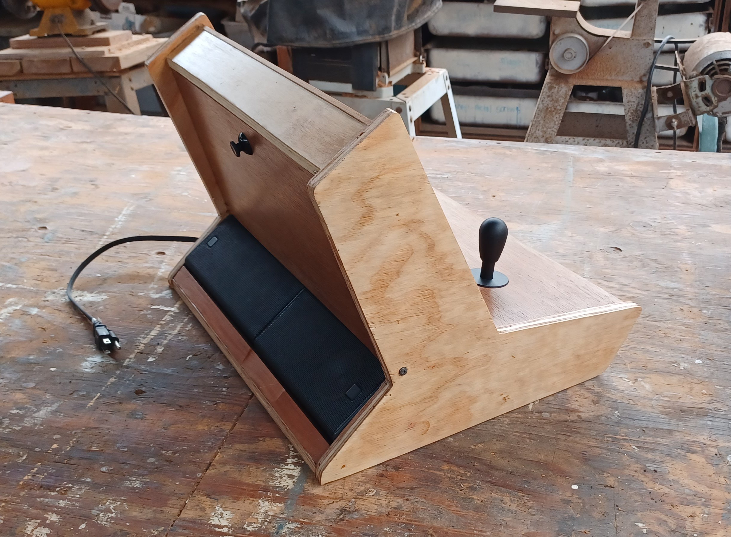

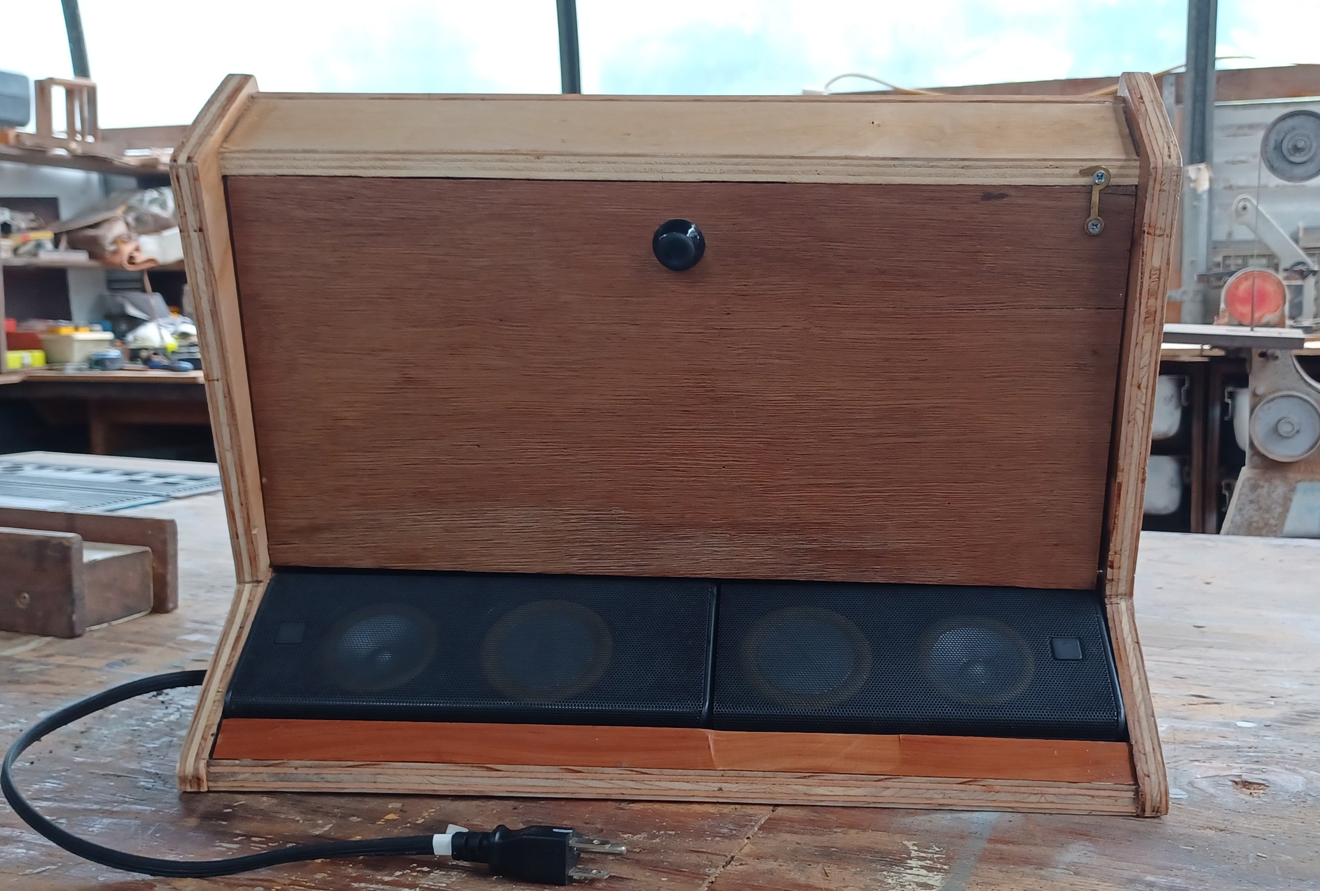

The audio amp, i/o ports and internals can be accessed through a service door in the rear. The door pull is one of the thumbsticks from the Xbox 360 controller used for the controls hack.
An old 4-port USB hub with one dodgy port was used for admin i/o (keyboard, mouse, USB thumbsticks, etc). The hub is not visible in above pic but is located directly below the HDD seen in the center. Audio amp board with volume controls is in the lower right.

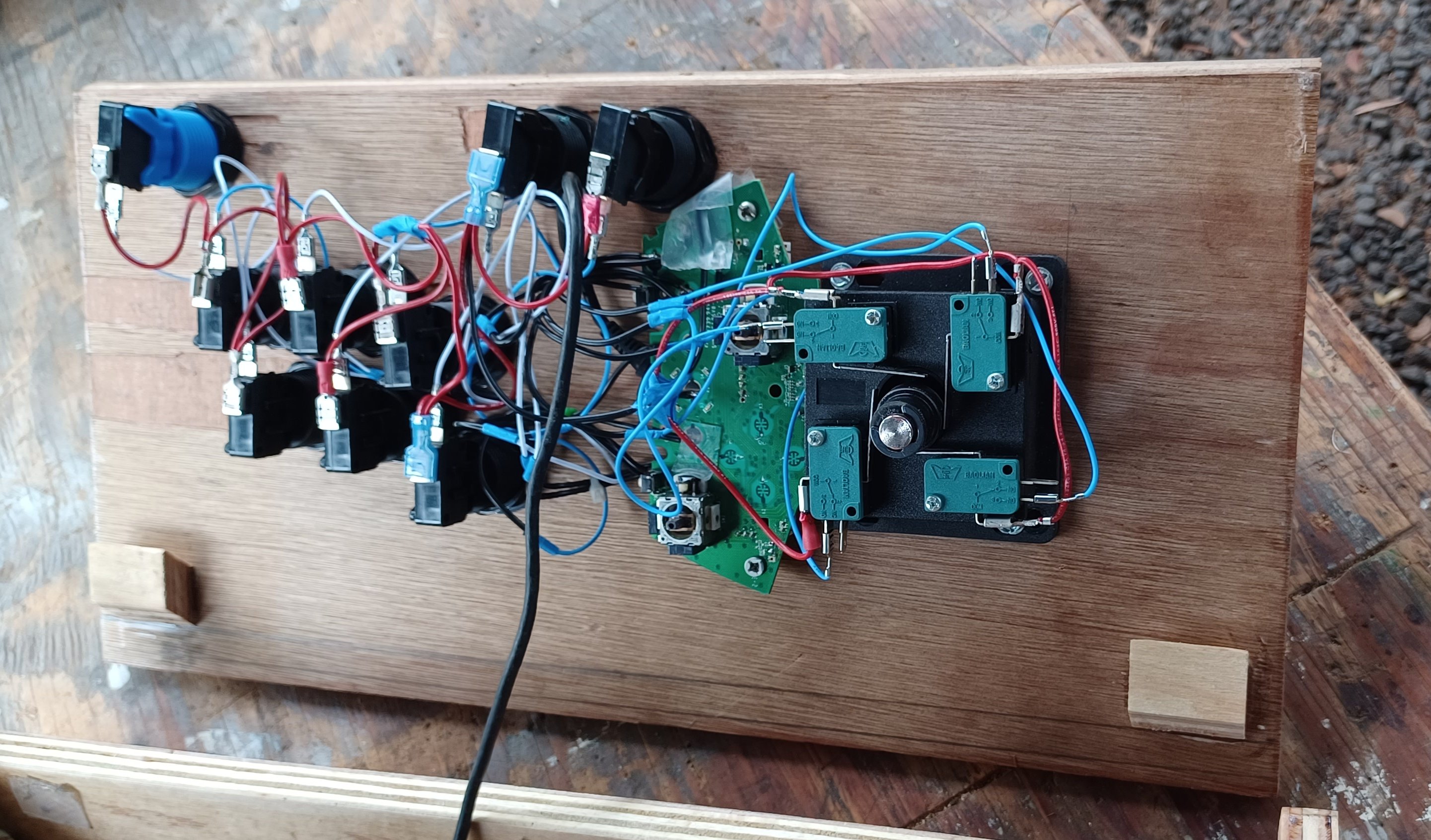

Xbox controller hack mounted to underside of control panel. It's ugly, but it works. I'd never bother with a pad hack again, and wouldn't have for this one except that I had decided to really lean into the 'recycled parts' nature of this build as it progressed.

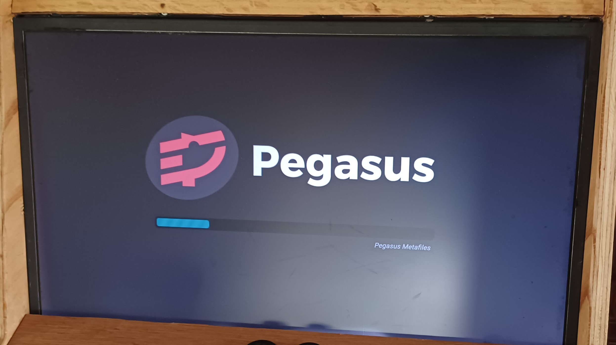

This is the loading screen presented to the user as Pegasus frontend loads from boot.
...And this is the game selection interface within the frontend. All UI functions can be controlled using the player controls, including system suspend, restart and shutdown. A single external arcade button mounted to the side of the cabinet is wired to the PC power switch, and puts the system into suspend (sleep) by default.

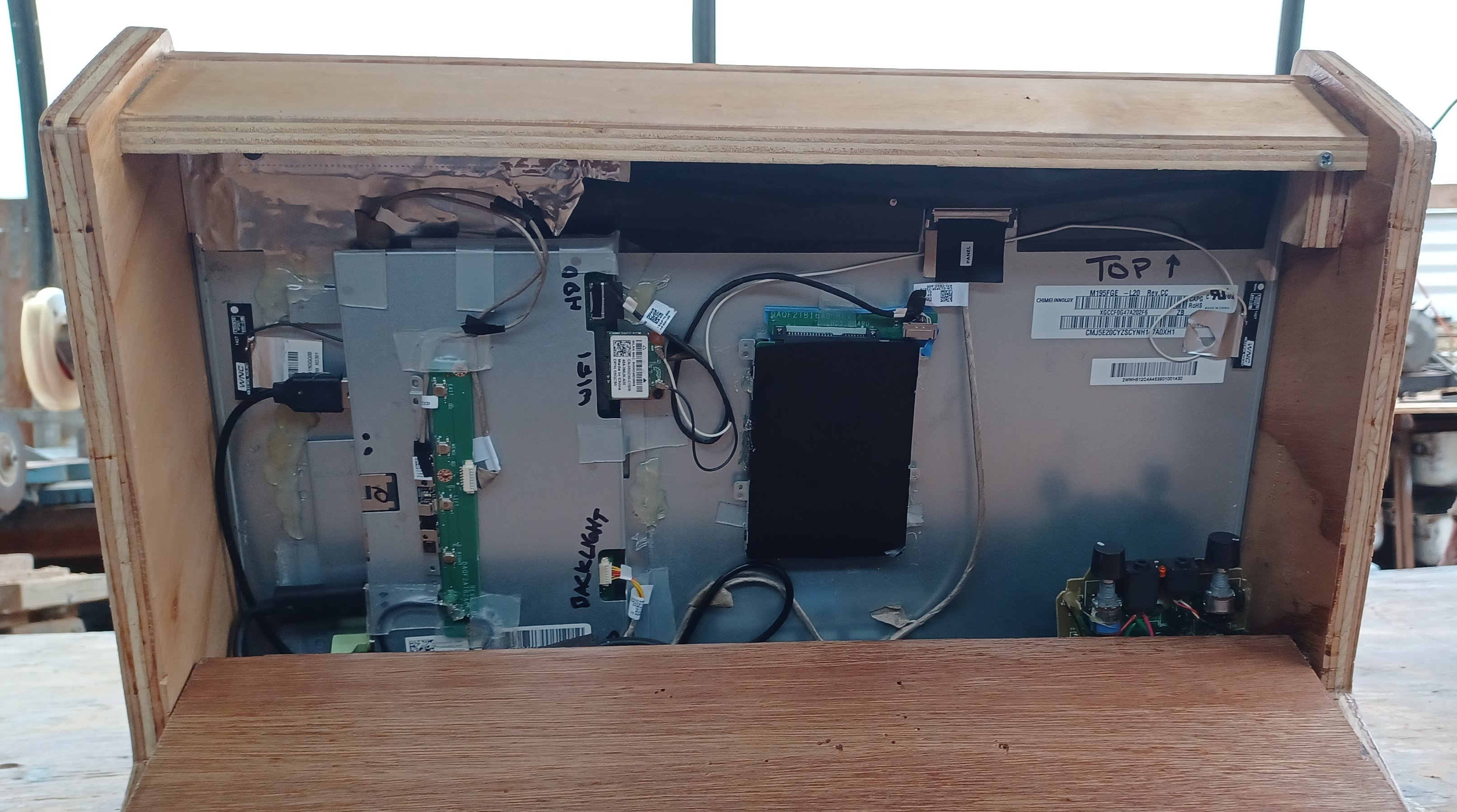

The Dell Inspiron Model 3043 computer with 19" 16:9 LCD. The monitor is marginal with backlight bleed at the bottom edge, and the onboard usb ports were very flaky with intermittent connection. The port headers were reflowed and that seems to have improved their reliability.
The computer was on its way to e-waste, but I decided that a bartop build might be a fun use of it on its way out. System was decased, and daughterboards + accessories remounted to the rear of the monitor case with hot glue and flex seal (lol). All (DC) electrical connections which needed to be modified are soldered and heat-shrinked.
Decased Logitech speaker system. This model uses a 10.6V AC transformer which was mounted into the base of the cabinet and ganged to the AC input for the computer's small power brick. The power switch for the audio amp is part of the rotary volume control, so in combination with the computer's internal monitor shutoff circuitry no relays or smart strips are necessary to power off the machine.

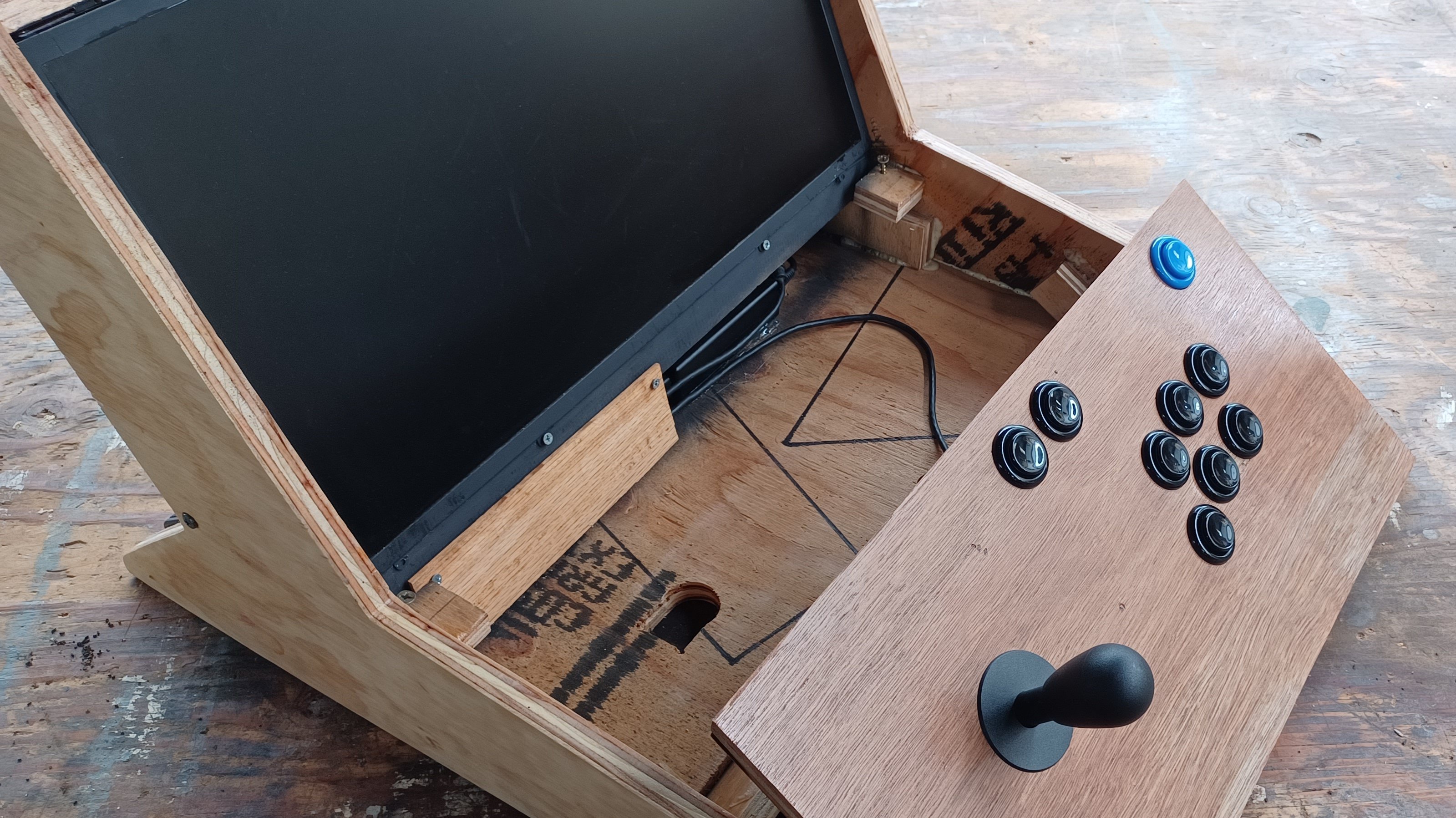

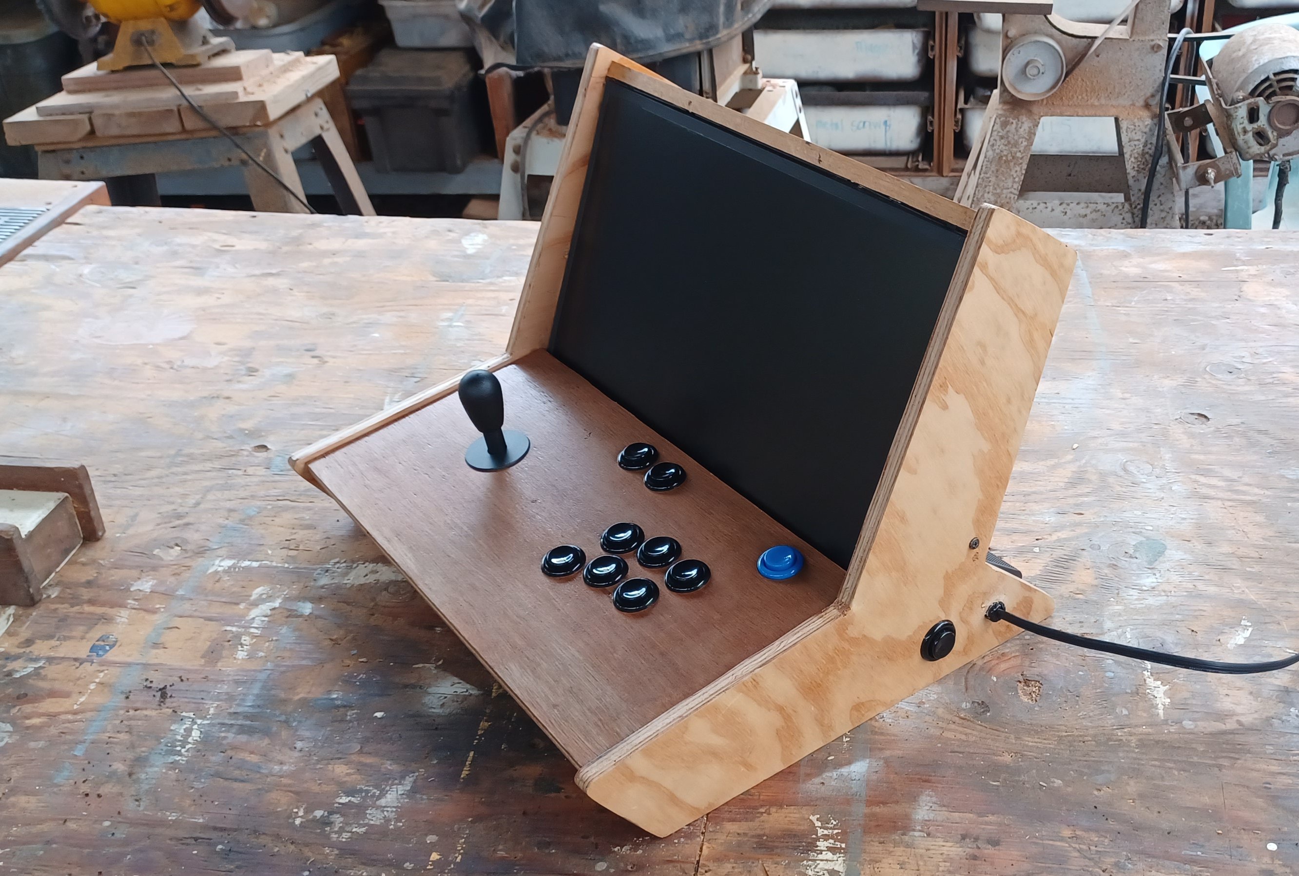

A rough cardboard template was made to establish the shape and I proceeded to make sawdust.

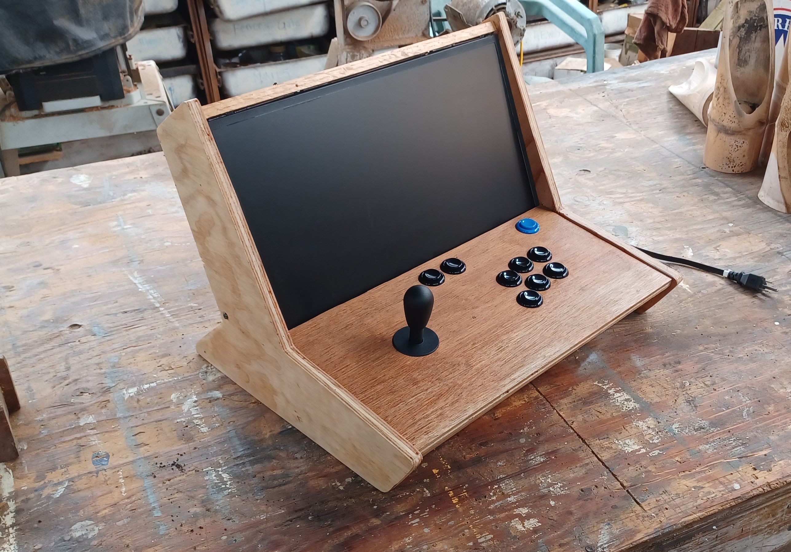

First mockup using wood cuts to check dimensional fit prior to glue up. All of the wood materials used are remnants and offcuts from other projects, but could comfortably be cut from a half sheet of plywood. For this build a variety of 1/2" and 12mm ply was used.
Final glue up of header bar above monitor. Minimal battens cut from ply were used to help preserve space for internal components. Crossbar in the middle is the monitor support, which also carries the audio amp, usb hub, and serves as a separator for the control panel cavity. The large hole in the exterior panel at the right is for the machine's power button, and the smaller hole behind it is the hole for the AC cord strain relief grommet.
The rough plywood wedges in the dogleg area are mounts for the speaker faceplates which carry the drivers, passive radiators, and speaker grilles.
The next steps will be to determine what sort of deco/finish I want for the unit (I'm leaning toward woodgrain vinyl wrap for the sides), application of 1/2" edge moulding (will be using adhesive countertop edging rather than t-molding), addition of rubber feet to the underside, and addition of acrylic overlays for the monitor and control panel (tolerances were planned in advance to allow for overlays).

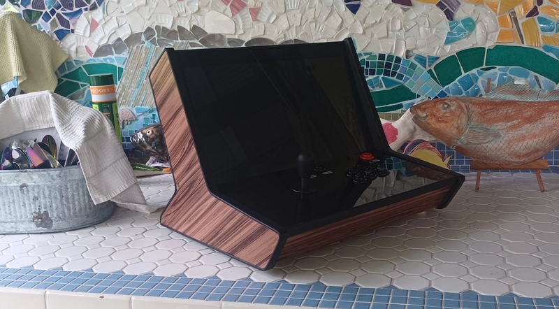

I got my hands on some .090" Lexan sheet for the control panel and monitor overlays. I transferred the holes for buttons and joysticks, and took the opportunity to adjust the joystick and button positions slightly - joystick was moved 1.5" closer to the center, and tightened up the spacing for the --BINGO! Either that, or I was attempting to say "before" but it was too many letters to type-- button to allow for a more comfortable Neo-Geo layout.
My original plan was to bend the polycarbonate so that I'd have a single continuous piece covering both the control panel and monitor. The only problem was that I didn't have a brake, and I didn't want to mess around with heat. In my race car fabrication days I routinely did cold bends with polycarb with fine results, so I improvised a brake mounted to the side of my saw table using some heavy duty hinges and 2x4 material. It worked great... until it didn't. I had drywall screwed a lever to the articulated part of the brake but hadn't realized that the tips of the screws were ever so slightly protruding from the brake surface, and they put a large gouge into my nice shiny lexan. I aborted on the bend process as I didn't have enough material to try again, but there was still enough material to go ahead and make two separate panels. So that's what I did.
I masked and painted the backside of the lexan to give it a nice glossy piano black fingerprint magnet finish.
I added some button labels for the 'Coin', 'Start' and 'Exit' buttons on the panel. The labels are Dymo printed and mounted to the wood control panel substrate, with tiny masked windows so that they show through the painted lexan overlay. This machine will be used by guests at community center events as well as at home, so I figured labels might be a good thing. The Dymo print is a little crude, but I figure it works fine within the context of the machine's build and the '70s industrial aesthetic I'm going for. I'll get better pictures soon.

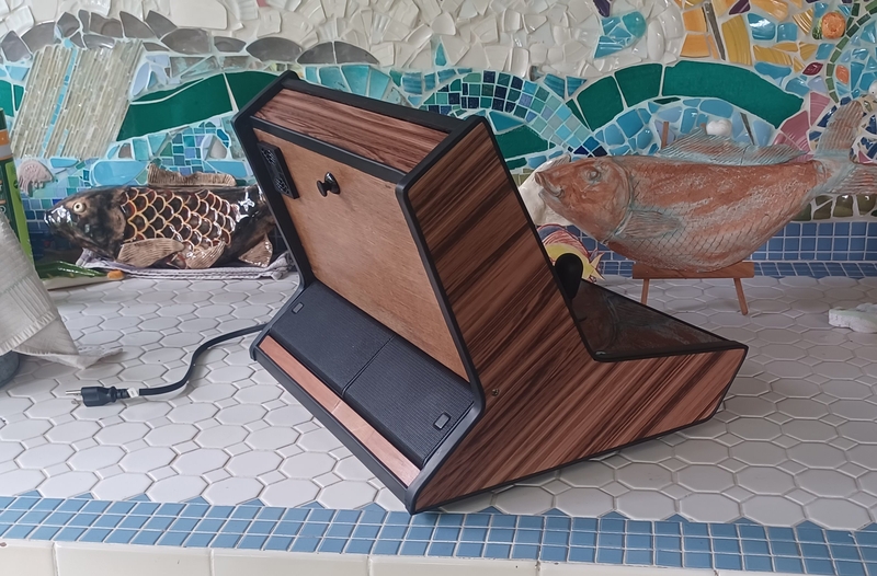

I added some woodgrain vinyl wrap to the cabinet sides, front fascia, and monitor header, and another little Dymo label for the power button. Nothing fancy here, but it does make it slightly more attractive than the CDX plywood did. Next up will be adding the edge molding, once it's arrived (I live on the Big Island of Hawaii so pretty much everything has to be shipped in if Home Depot doesn't have it).
Regarding the earlier discussion about cooling, I did spend some time looking for suitable power traces on the motherboard to tap for power supply for a cooling fan, but I think that I may be giving that one a miss in favor of ambient/convective cooling. The motherboard was definitely designed to a cost with very marginal power traces, and I just couldn't find a position that I was comfortable with adding a take-off. I'd hate to brick the thing by lifting a trace, which seems like it might be all too easy to do. I've added some ventilation holes into the base, and going forward will be adding some exhaust vents up high on the rear door adjacent to the mobo. So far it hasn't gotten any more than slightly warm, but I do really appreciate all of the thought and suggestions that you folks have made!

Finished! Cooling fan installed and operable, RAM upgraded, and software tweaked to contentment (for now).
