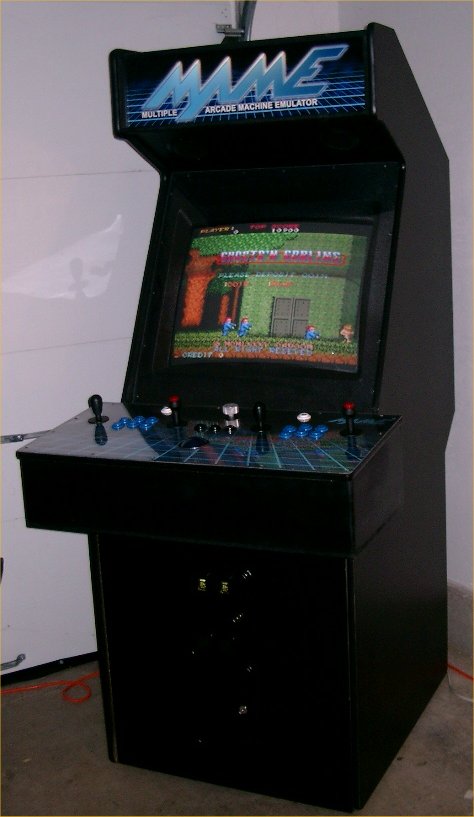

Greetings,
I have a MAME Cabinet built over 20 years ago that used to sport an old PC with a GPU that had S-Video Out to an old Sharp 25" CRT. The HDD was 20GB if that gives you an indication of when it was built, late 90's?
Well the cabinet is in great condition all wired up to an I-Pac and Opti-Pac but has been sitting in Storage and now in my garage with a cover over it for years. I decided this years winter project will be fixing it up and getting it working again. So I'm beginning the Research phase now. I started out buying a Beelink mini PC w/ Windows 11, loaded Hyperspin frontend on it and the specs for the Games I have installed run without any issues so I Would like to continue with the hardware only problem is it has 2 HDMI outputs and no ability to install a GPU.
I had a look over this long thread of information: https://www.aussiearcade.com/topic/76809-a-guide-to-connecting-your-windows-pc-to-an-sd-crt-tv-pvm-or-arcade-monitor/
And from What I gathered I need:
- Groovy Mame
- Tendak AV-107-BK
- crt_emudriver (If even plausible with Windows 11, might have to get te Windows 10 Install)
Though after that point I am going from Digital to VGA, the TV has S-Video Input as well as standard Composite Yellow Input so would prefer the S-Video do I just need a another adapter to move from VGA to S-Video? Is there a particular device that might serve better than others? Or am I way off?

Well got a snapped photo today, RGB done as well my friend added an Auto Power on Circuit to the TV :)
More photos to come!

Looks great!
Simplest way to add an "auto power-on circuit" to a TV is to put a capacitor between the soft power-on switch terminals. When connecting to power, this adds a short delay (typically less than 1 second) before closing the switch. This is usually enough time for the TV control circuitry to wake up, and then being able to register that you've "pressed the switch".
Am I imagining a soft shadow in the middle, between the blocks of red and cyan?
