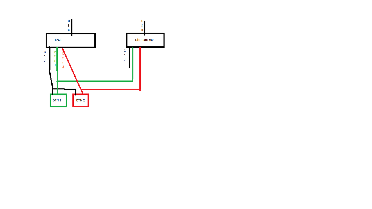

Hello all,
I am building my first arcade and i need some help with buttons wiring.
Let me first explain the setup and what i am trying to achieve.
I have 2 IPAC Ultimate boards:
Board 0:
Player 1 Sanwa Joystick + 12 buttons
Player 3 Sanwa Joystick + 6 buttons
Board 1:
Player 2 Sanwa Joystick + 12 buttons
Player 4 Sanwa Joystick + 6 buttons
Nothing special here, everything works great.
Here is the part I run into problem... or lack of knowledge how to do it exactly.
I have a Ultimarc 360 Analogue joystick that comes with USB cable and is visible in Windows as a separate (from IPACs) joystick.
I wish this joystick to share the buttons of Player 1 (that are connected to the IPAC Board 0)
The joystick itself have a mini-USB cable that you connect to the PC and a 9-pin connector - 1 Ground and 8 buttons.
I can connect the button cables to the corresponding buttons of Player 1, but what to do with the ground wire?
Do I daisy chain it to the buttons as well and have 2 grounds per button - one from ipac and one from ultimarc 360 or I don't connect it at all?
The easy answer is don't use the U360 encoder for buttons.   :P
In most emulator programs, you should be able to map the U360 analog joystick and Ult.I/O buttons to one player's inputs.
If you are running a program that only accepts joystick and button inputs from a single device, you can connect one button to two encoders.  You only need a single daisy-chained ground since both the U360 and the Ult. I/O grounds are connected via the USB cable ground.  When you press the button, ground will be applied to both inputs which will trigger the related outputs from the U360 and Ult. I/O.

And there is no problem that the ground line comes from a different device?
I can use the ground that comes from one of the IPACs and just not connect the one that comes from the Ultimarc 360?

Is this what you propose?
There are a very few encoders like the ones from X-Arcade that use isolated grounds.
For all others, including any from Ultimarc, the saying "ground is ground" applies.
- I've used some odd ground sources like a metal computer case and even a metal heating duct :lol while testing some Arduino-based encoder inputs.
Your diagram is what I had in mind.
- It doesn't show that both USB cables are connected to a common ground, but they are.
- If it makes you feel better you can connect the U360 ground to the Ult. I/O ground daisy chain, but it's not necessary.

Thanks for the help. It is working without connecting the second ground. I will do some more testing to see how it will perform.
drfrancky
  • Posts: 12
  • Last login:November 13, 2022, 03:14:10 pm
Re: Two joysticks with shared buttons
« Reply #6 on: October 21, 2022, 12:53:48 pm »
Actually after some time it stopped working. The IPAC shows stuck button, and the Ultimarc 360 does not recognizes the buttons pressed.
This happens after some plug in/plug out of the USB cables of the controllers. Will have to dig further :-)

« Reply #7 on: October 21, 2022, 05:18:37 pm »
After some more digging i think i found the problem... when connecting and reconnecting joysticks the Ultimarc 360 thinks he should be in "output mode" and not in "input mode" and stops recognizing incoming buttons. For now, the solution is to unplug and plug them back in the correct order - first Ultimarc 360 and then in few seconds to plug the IPAC. This is actually not a solution because i need it to work regardless of the order you plug the cables.
