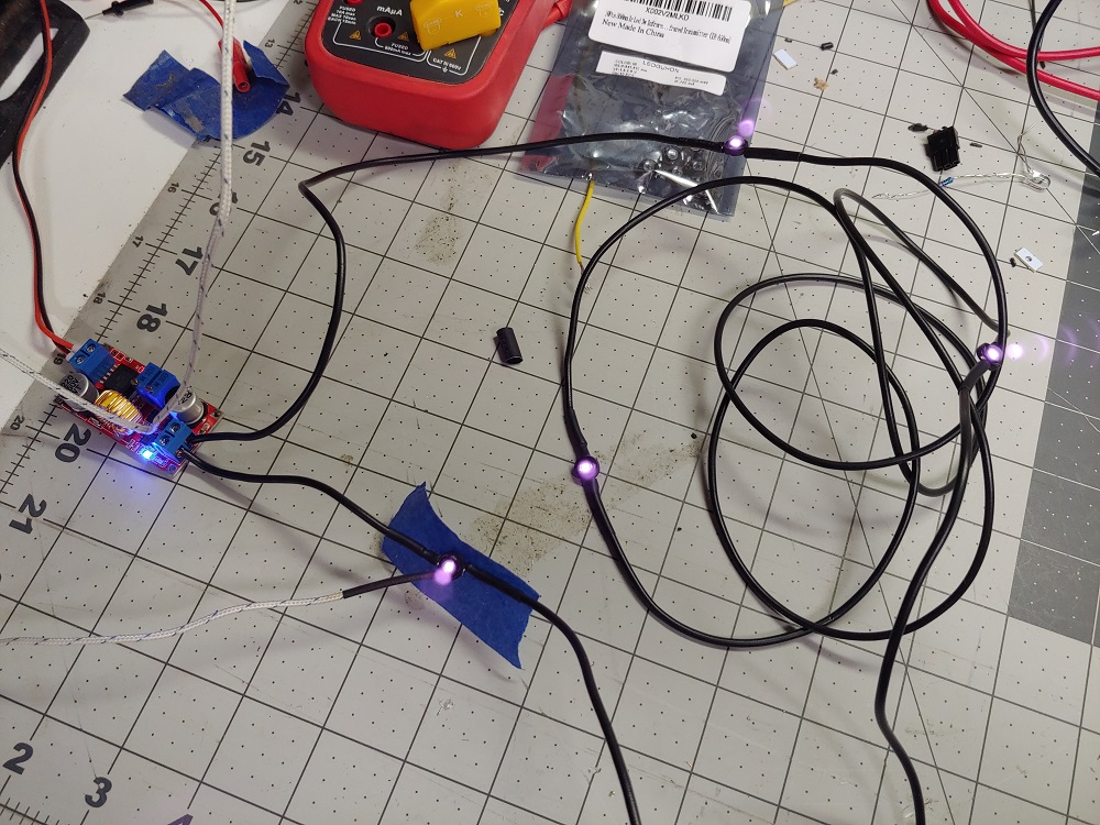

I found a bag of LEDs with 940IR scribbled on it.  No idea of the specs and haven't messed with LEDs in a while, but a youtube video says 15mA to be safe, 20mA max.
Hooked up a 5v power supply (probably too much) and swapped out resistors until I got up to 19mA.  Nothing got hot.  They (or maybe the power supply) lasted about 20 minutes.
I made it far enough to verify that the guns connect and see four LEDs, but didn't make it to the point of aiming.  I could redo it using these LEDs with higher value resistors or run them in series, but the beam on them is so tight that they have to be pointed right at the gun.
Not wanting to wait for AliExpress, I ordered what I could find on Amazon without spending too much:
3w 850nm IR LEDs with 140 degree lens built in
a constant current buck converter
To keep the cost to a minimum until I know it works, I didn't buy the pcb and housing they recommend.
For a heatsink I plan attach them to a short piece of round aluminum stock with thermal glue.
If the aluminum gets too hot I can make it longer or add heatsinks to the other end.
So not much to report yet, but I am working on it.

I made a wiring harness today for the LEDs and tested how warm they get.  They are 3 watt, but I think I can get away with no heatsink if I run them like 1 watt ones.  The $7 current limiter is definitely the way to go.  Adjustable and no messing with giant resistors getting hot.  I am running the LEDs in series at 6.5 volts and 300mA.  The package says they are rated for 700mA, but I am only giving them enough to get the job done.  Once they are in the cab behind smoked plexi, I may have to turn it up and add heatsinks.  I used fairly thick wire, so that is probably helping wick heat away.
The wide angle lens incorporated into the LED is also definitely the way to go.  The old LEDs were only visible straight on.  These are good from any angle and it's a very small package without the big lens and housing recommended by the author of the software.  I will post links when I get back to a PC.
My ancient bluetooth adapter wouldn't stay connected to both guns just like the old glovepie days, so I bought a new Asus one.  The first gun connects easy, but the second one takes multiple tries.  Once connected they stay connected, but the process has to be repeated every time the software is launched.  I might have just not gone far enough yet, but I don't see how this could be incorporated into a front end.
All I have to do is tape the LEDs to the monitor and I'll be ready for testing.  Might get to it tonight.  If not tonight, tomorrow.

LEDs are 850nm 3w with built a in 140 degree lens.  When they are powered, there is a bit of red visible to the naked eye.  It is subtle and not distracting, but 940nm ones would probably work just as well and have no visible light.  I like that I can see that they are on.
These are the ones I used: https://smile.amazon.com/dp/B08XQDLS8L?ref=ppx_yo2ov_dt_b_product_details&th=1
I am not saying they are the best for the job.  I primarily bought them because I could get them quickly.
They were ran in series 6.5 volts and 300mA.  This is less than half of the rated current, but it keeps them cool enough to not use heatsinks.
This is the buck converter/current limiter I am using: https://smile.amazon.com/dp/B07G446KHJ?psc=1&ref=ppx_yo2ov_dt_b_product_details
(Not sure if it is a good one or not.  It took a while to get the voltage adjustment working.)

I just wired them in series in a loop (+ in then - to +, - to +, etc ).  (That is a thermocouple taped to the first one to measure temps)

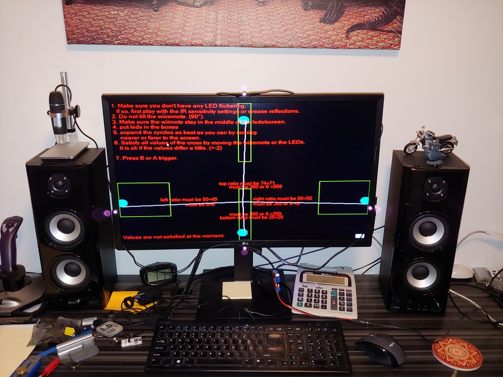

It could just be that I'm inexperienced with it, but I found the calibration screen difficult to do holding the gun by hand so I ended up holding it with a phone mount on a tripod.
With the gun stationary, I could move the LEDs to get the correct numbers on the screen.  The side ones ended up needing to be moved inward closer to the edge of the screen while the top one needed moved off the top of the monitor.  I am sure this will be easier once I wrap my mind around everything, but it felt a bit overhelming trying to get it right at first.  I am sure I will be able to explain it better after doing it again on my cab.
Once the LED locations were calibrated I tested the gun as a mouse.  It was drifting a bit toward the edges.  I played around with the offset calibration to correct this.
I thought the offset calibration wizard was going to be helpful as it has you get close enough to only see two LEDs, but in the end I didn't find it useful and preferred to play around entering my own numbers.  Basically playing the high low game until I found the value where the mouse pointer was dead on with the gun sights near the edges of the screen.
So gun calibrated I launch MAME and learned how much I've forgotten.  No fake mouse input in MAME.  So I switch to the vjoy plugin and it doesn't work because I don't have vjoy installed on this PC.  So after getting vjoy and MAME square away, the first thing I notice is that the on-screen crosshairs in MAME trail pretty bad.  It doesn't cost me to miss any shots, but not ideal I guess.  Luckily there is a setting for this in Lichtknarre.  Under "More Settings" next to each player is a "Step" setting.  I double it and the trailing is pretty much gone.  Not sure at what expense, but the games were perfectly playable without crosshairs at the stock setting.
In mame with vjoy, the offset near the edges still seemed a bit off.  I am pretty sure it could be adjusted or corrected in the games original service menu, but I didn't want to get into that yet.  Using the sights on the gun, the shots were close enough to count as a hit in all the games I tried, but it still felt like it could use some tuning.

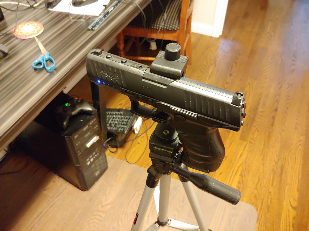

I started off with House of the Dead 2's service menu.  After playing some HOTD2 and Maze of Kings, I moved on to Sport Shooting USA.
This is the game to test guns on!  I took my time to dial in the calibration in the game's original service menu.
How well do they work?  Watch the video below.  I am aiming using only the gun's sights from 40 inches away.  You can see that the shot doesn't always correspond to the mouse pointer.  That is the game's original arcade calibration at work.  For the second round of shooting, I managed to get some decent footage from behind the gun.  The next to the last shot misses and you can see that I had the gun turned.  When I straighten it, the shot lands.  EDIT:  I also want to mention that the camera on my phone messed with the wii camera despite having the light disabled.  It would make the crosshairs jump to random places.  I put tape over the LED on the phone and the crosshairs became stable.

It took a while to get both guns connected, but when I relaunched the program and pressed the sync button on them, they both immediately paired.
On these guns, it seems that I only have to press the sync button, not hold it down.  I think holding it down before was actually preventing them from pairing.
If you have wii guns, it is definitely worth it.

About your setup.  Visually, and based on the position of the blobs, I think your LED positioning was at least initially incorrect.  As I stated earlier about the calibration explanation, assuming your monitor image fits perfectly to the frame, my gut feeling is that the LED's need to be an equal distance from the edge on all 4 sides, and at the positions indicated by the positioning calibration lines image you posted earlier.  From your photo, the top and bottom LEDs are outside the frame, and the left and right are inside, with one of them appearing to be closer to the screen edge than the other.  Those lines connecting them should be a nice, straight cross pattern, and I believe that what it may be showing you is the positioning error.  Even though you got it to work, I think the position of the LEDs made it a lot harder than it should have been.  Again, just an observation, I wasn't there.
And one final comment is the speakers.  Maybe it's not a problem, but with the wide angle of the LEDs, I have to believe that at some angles, you are going to get reflections off the sides of the speakers which will impact the accuracy of the system.  Depending on how the code is written, this can affect not only stability of the cursor, but possibly also tracking speed, as some of the jittery values caused by this could be seen to be "out-of-reasonable-range" and discarded as error, causing the system to be waiting for something more reasonable to arrive to be averaged into the position data.  To get a good test, I would think that at minimum, the screen should be brought out past the front of those speakers.

I am stepping down from 12 volts.  My cab has a 12v power supply in it for the monitor rotation that I plan to tap into.  They will eventually be turned on and off via software.  I also might need to up the current to make them brighter behind the smoked plexi on the cab.
The package the LEDs came in said 1.5-1.8V .700mA (which I assume is 700mA, so who knows if these are correct.)
I started with the LEDs an equal distance from the edge of the screen.  Where they are now is where they ended up through the calibration process.  It's all about their relationship to each other so all four could be moved down, but the sides would still be right on the edge of the screen while the top and bottom aren't.  Getting it this good was not easy.  You will see, lol.  Hopefully the cab will come out better since I have some experience now.
The speakers are behind the front edge of the monitor.  Pretty sure what you are seeing is lens flares.  I was wondering if they were as bad for the Wii camera.
This was just a temporary taped on setup to see if it worked well enough to bother with.  It does.
EDIT:  ahhhh.....the autofocus.  Makes perfect sense.

I was still trying to get my brain to swallow the LED positioning (sorry for being a dingbat).  But I think I get it now.  The horizontal line of the on-screen LED position screen is only useful if you are able to position the top and bottom LEDs at exactly the points to which they intersect with their respective screen edges.  I think what needs to be done to simplify this is to make this a multi-step process with either some extra code or a small external app.  The way I see this working would be:
1: A vertical line is shown on-screen as a reference to center the top and bottom LEDs, maybe with some verbiage to place them as close as possible to the active screen edges to keep the shooting distance reasonable, due to the camera's limited vertical FOV.
2: Put up a couple of input boxes for the user to enter the measured distance from the center of the LED or cluster to the active screen edge for top and bottom respectively.  Then from those two values, calculate a vertical offset to achieve the proper ratio.  I have to think about this more to come up with the formula, but I don't think it's too complicated.
3: Show a horizontal line on the screen at the position calculated in step two, with some verbiage to place the side LEDs in-line with it and to maintain equal spacing from the active screen edge, which should keep them equidistant from center.
Does this sound remotely correct?

The white bars and the ratio number display should be the indicator so that the ratio is properly maintained. The problem here is that the program never knows where exactly the screen is. Whether there is more space on the left, right, top or bottom. The Wii simply cannot see this. Therefore, only the imbalance can be shown by the currently white lines.
http://forum.arcadecontrols.com/index.php?action=dlattach;topic=164992.0;attach=392263;image
It is also very difficult to calculate that the other way around, as multistep. If there would be a new screen where the program tries to calculate this the other way around, then the program does not know which ratio the screen has, if it would assume that the user has put the LEDs directly to the screen.
Also:
It is possible to have correct aiming also at the edges. Simply start to test at the left and increase/decrease the left offset in small steps and test inbetween. Continue with right offset. I will try to make a video about it in the near future.
https://geekonarium.de/en/what-is-ir-offset-and-why-do-i-need-it/

As a side note, my Nyko "Perfect Shot" gun shells showed up today.  They feel great in the hand, are not bulky at the forward part and the trigger action is excellent.  They even have a port pass-through extension which brings it down below the grip.  I have another style on order as well, but the Nyko's will be tough to beat.  My only complaint with them is the lack of a bead on the clip in front, which you really can't fault them for.  The Wii never really had good line-of-sight aiming, so it wasn't really necessary.  I think a small, well-placed divot, a BB and a drop of superglue will take care of that nicely.  Now just waiting on the LED modules :)

I couldn't help myself.  Based on my earlier ramblings, I made this small app for myself to try when the time comes.  It might work, or I might have just wasted my time.   :laugh2:
BadMouth, if you feel like it, go ahead and check this little program out and see if the result points to where your LEDs are stationed.  If not, then we'll know it's useless and I'll delete it.  Otherwise, it may help a bit when it comes time to move your LEDs to your cabinet.  It's resolution agnostic, but should at least be used at the native aspect ratio of the display.  Also, at low resolution some of the screen elements might trample each other.  Outside of that, it's been tested and based on the test measurements, it looks like it does what it should.
*edit* Software used some bad math.  Will update in a later post.  :-[
If anyone else wants to run it, feel free.  But it's not too exciting :)
Randy,
Since the LEDs were already in place I used your program to see if the line would end up where my LEDs are.
It ended up above my LEDs by the amount of the top offset.
Top offset: 11mm, bottom offset: 11mm, distance between LED centers: 346mm
Not sure if it's an error in the program, but I can't move my LEDs very easily at the moment.

Plenty of people may have used the program, but how many of them are old codgers who grew up with accurate CRT light guns.  :D  :oldman
At any rate, it works perfectly with the offsets applied.
RandyT
  • Posts: 7024
    • GroovyGameGear.com
Thanks for bearing with me.  My calculations were bad and I used it for the software without verifying.  Where's the self flagellation emogi?   :angry:
@BadMouth (and whoever else might be following along), please delete that first version and try this one. I think (hope) this is a keeper.
  • Posts: 9286
Still a tad above, but since I have the oddness of larger offsets than expected, I wouldn't bother trying to revise it until you set your own up.  Might be something weird on my end.
I still have to wire the power supply into the cab and transfer my gun gamelist from my old setup.  But as far as test screens and windows mouse control go, the guns are working as expected.
