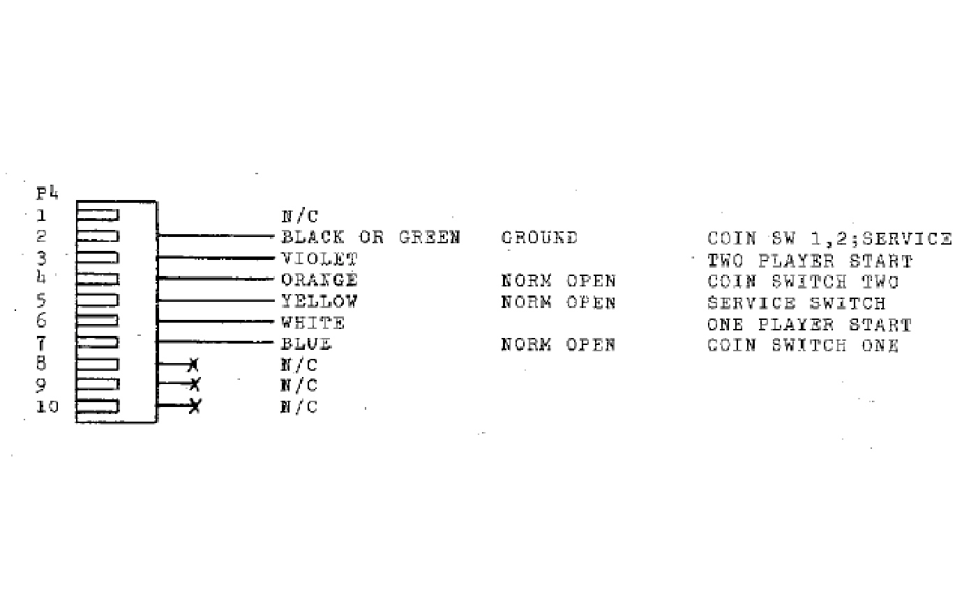

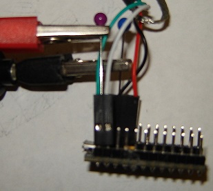

OK, didn't get very far.  I'm not sure how to remove the ribbon cable that is connecting the two boards. Do I just pull on it?
  • Posts: 9752
  • Last login:Today at 02:35:06 am
Re: 3.6v Tadiran Lithium Inorganic AA Battery
« Reply #23 on: August 28, 2022, 04:02:15 pm »
I can't tell from the photo if there are latches holding the ribbon cable IDC (Insulation Displacing Connector) on the PCB.   :dunno
Avoid separating the IDC connector where the ribbon cable passes through or at the strain relief.

Thanks Scott, well, I cut the old one out and crimped the new one in. I know that's not the right way.... I'm getting 4.60 on the multimeter now. Still not saving stats though. I think I need to clear out all of the stats, I'm trying to get to the service menu (I had trouble the first time, took like 10 attempts). I'm 50 attempts in and I can't get in. When I was in the first time I set it up fo free play. The routine you need to do to get in to the menu is: While in attract mode, 1- Hold down player one button. 2 - Press and release the service button. 3 - Release player one button.  But now as soon as I touch the one player button it exits attrct mode (I'm guessing because it's in free play mode  :dunno).... Is there a work around this situation? Is there any other way of getting into the service menu? Also, is the service button supposed to add credits? Thanks.

Any ideas on any other ways to access a service menu?
  • Posts: 9752
« Reply #28 on: August 29, 2022, 11:02:47 pm »
I don't see anything else in the manuals mentioned in this thread.
This might be a sign that you have poor/intermittent contact on the P1 Start and/or Service button switches.
- This is where having an analog multimeter can be helpful because the sampling and smoothing on a digital multimeter can sometimes mask this type of issue, but a twitching needle won't.   ;)
spisi
  • Posts: 257
  • Last login:February 26, 2026, 05:36:58 pm
« Reply #29 on: August 30, 2022, 09:41:51 am »
So, replace the buttons and try again I guess. One more question and I'll leave you alone LOL. What is attract mode exactly? Is it just when there are no credits and the game is going through various screens. Or is there a certain screen? Thanks yet again.
  • Posts: 9752
« Reply #30 on: August 30, 2022, 12:04:47 pm »
Power off the system and do a resistance check on the button switches.
It's not likely that they are bad, but it is posssible.
"Attract mode" is the time between gameplay sessions when the game shows a loop with the title screen, a short scoring/gameplay tutorial, and/or a sample of gameplay to attract the attention of passers-by and convince them to drop in some quarters and play.
The manual didn't specify a specific screen or sequence during attract mode so the menu button press sequence should work if you start it when a game is not in progress.
The menu button press sequence won't work if you release P1 Start (or the connection breaks) in the middle instead of at the end of the sequence.
If you want to eliminate the switches and wiring harness as possible problems, you can insert straight pins into the P4 connector housing so they make contact with the sides of the wire pins then perform the button presses by shorting the straight pins with alligator clip jumpers.
- P4 Pin 2 is ground. (black or green wire)
- P4 Pin 5 is Service. (yellow wire)
- P4 Pin 6 is P1 Start (white wire)
- Connect one end of two alligator clip jumpers to the ground straight pin. (black or green wire)
- During attract mode, connect the other end of the first jumper to the pin 6 P1 Start straight pin. (white wire)
- Connect the other end of the second jumper to the pin 5 Service straight pin. (yellow wire)
- Disconnect the second jumper from the pin 5 Service straight pin. (yellow wire)
- Disconnect the first jumper from the pin 6 P1 Start straight pin. (white wire)
- You should be in the game menu now.

Boom!!! That did the trick!!! I'm a super happy guy right now!!! Thanks everyone, especially Scott! You're a freakin' genius!!!  :applaud:
