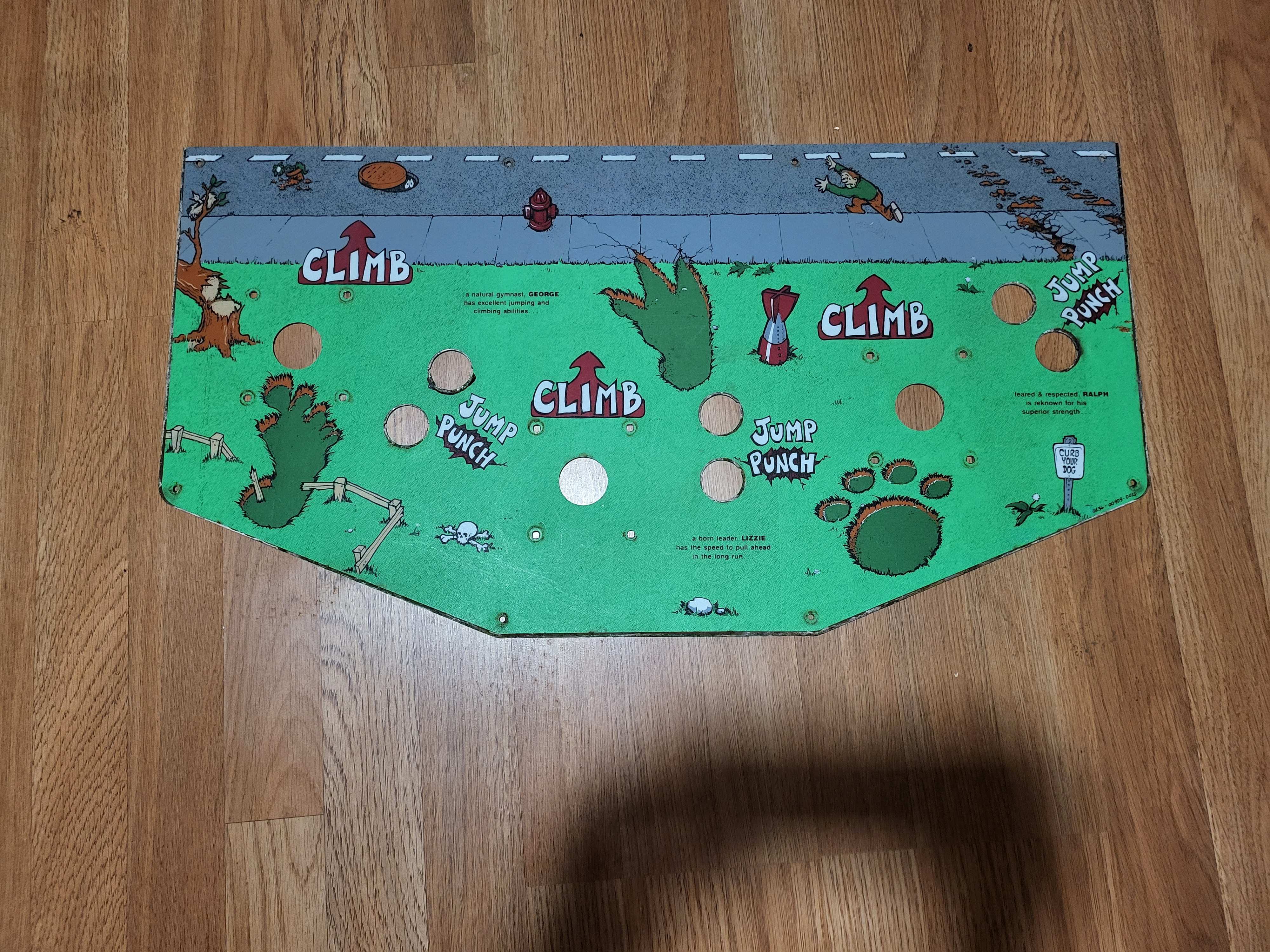

A few interesting parts here to have the speaker panel and grill capture both the marquee and bezel glass at the same time.
The metal part of the control panel is not really that bad (although the joysticks are little rust blobs and will require a lot of work and maybe parts replacements) but there is some rust on that too.
Anyone have any experience with ospho on these things?
I figured it would work but no clue if it will destroy the overlay on the other side if I get any leaching through.
Would prefer to keep the original overlay on this if possible.
If I get cooperation from the universe tomorrow I will be painting this baby.

Definitely re-use what you can, you might be able to use Ospho and keep the overlay. Do you need to use it at all? I would be inclined to take a sander to it and spray rustoleum over it. That might be kind of ghetto, but... it's the underside of the control panel.

I think you're right about the sanding and Rustoleum for my CP.
In between I think I will just lightly brush it with ospho instead of flooding it and see if it looks like it is helping.

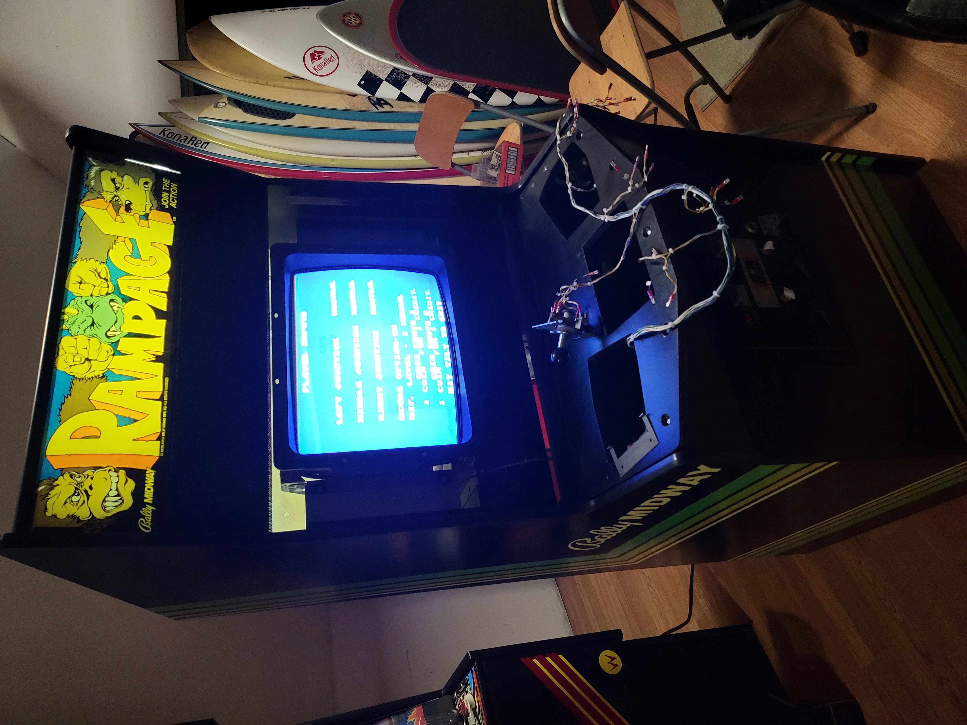

Rampage cabinet got a second coat of black today.
It is remarkable how much even semi-gloss black shows imperfections.
The texture you can see here is barely noticeable with your hand.
In the past I have been doing ok with using mineral spirits to thin my paint but I tried Floetrol this time around and I am a huge fan.
It takes a bit less of it to get good viscosity, it mixes in easier and the gun seems to lay it down nicer too.
Haven't decided if I will sand this and give it another coat or just run it as is.
I got the side art stripes and T-mold here so I'm getting kinda antsy on making it pretty.
No matter what I know the Sounds Good board needs help (which I am clueless on,) the joysticks need a ton of work too and my harness is in Canada for that matter, so I really should just be patient and make the finish even flatter.

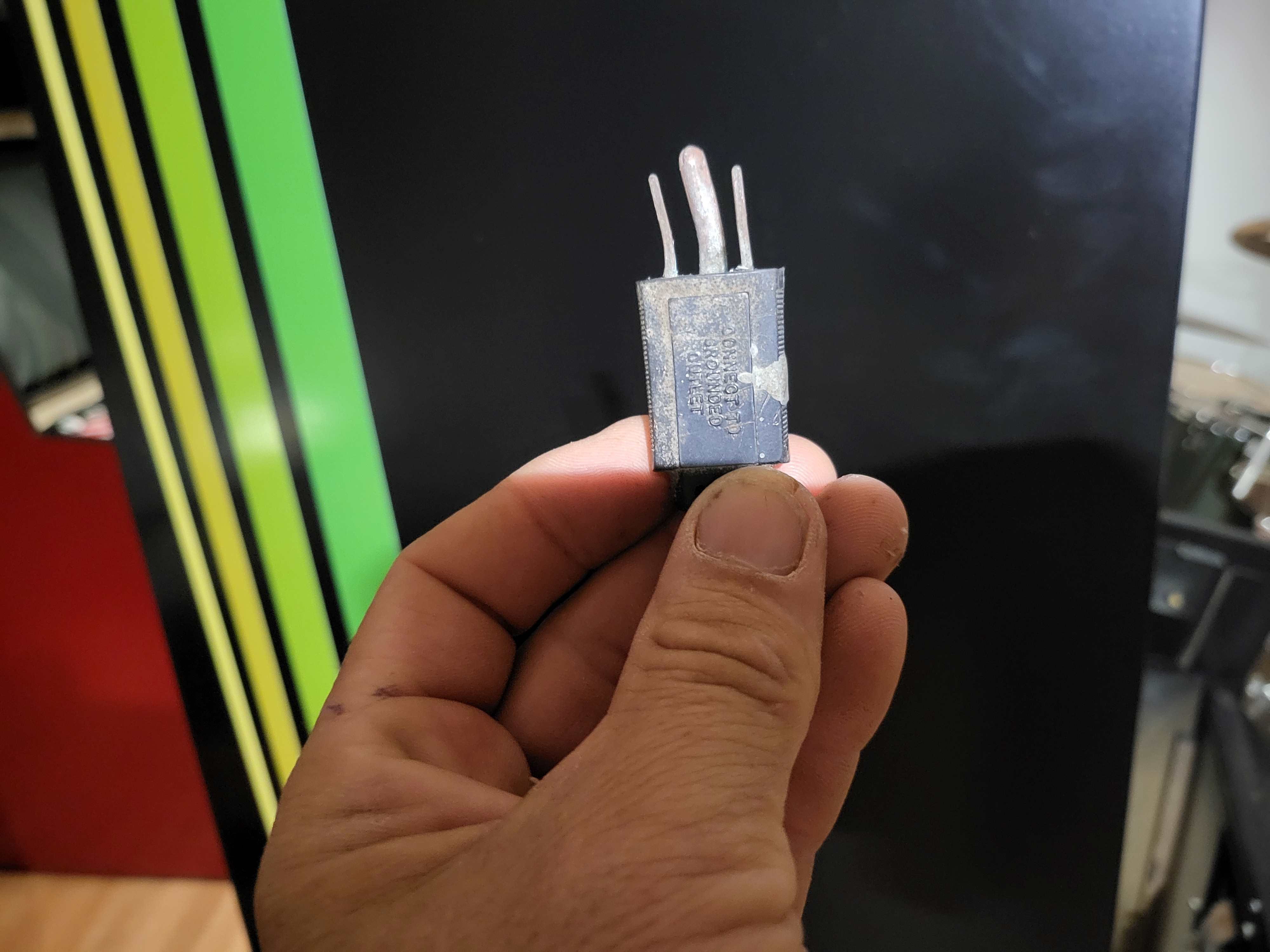

Got to spend more time on this after dinner which is fun since the crescendo is palpable at this point-
I was brave enough to turn it on again, but felt that I should replace this thing first.
Between the corrosion and the Dee Snider nature of the thing it was making me nervous.
Once again I got it turned on and it rolled immediately into a test screen.
Props to Todd at TNT for his brief aside in a video about the screen rolling from the harness connector on the monoboard being off a hair.
I thought I might have some sync drama but I reseated the connector and got a stable picture this time around.
Whew.
And so I tried to go through a bit of the test scenario with a half-assed joystick connection and then read the fine print:
Hit slam switch to advance through test menu.
Well who would've looked for the existence of a slam switch?  Especially when there was a big lock hasp screwed to the door where the damn switch should be?!
Turn off machine, remove stupid unnecessary lock hasp and try to find a slam switch in pile of detritus from ridiculous basement raid like a year ago-
Amazing...
Install switch (was the fact the ground was just cut open have something to do with the coin switches not working?!) reconnect harness and then get...
Nothing- still.
What a mess all this other crap is.
At least it is just swapping some pins around.
Gave up on coin door for the moment so that I coulsd get some controls wired up.
The sticks were a mess but I got them back to functional with some love and bleeding.
Best part of the rebuild activity is how silly all of the art is.
The control panel is nearly as good as the bezel in sheer silliness.
My local hardware joint didn't happen to have black 3/4" 8/32 carriage bolts and since I can't wait for ordered ones to arrive I needed to improvise because I am sick of just looking at this cabinet and not playing it.
I had only marked the joystick signal wires so I had no idea which buttons were "Jump" and "Punch" so it took a little bit of messing with it running to sort out.
Once I had done that however...
It runs- and all the controls work the way they should.
Still to sort through is the coin door and sound system.
I hear some white noise, but only through the right side speaker so the sound amp needs something.
And I see no lights at all on the Sounds Good board and have no game sound at all so that needs work too.
Have a stack of caps and IC for the Sounds Good but will need to see about rebuilding the dual amp.
Closer still!
