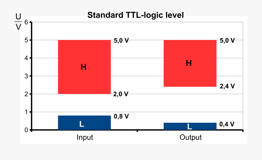

This is going to be in an old DB9 joystick for using with old Ataris/8-bits/Amigas, and I really don't want to damage the vintage hardware!
This crucial detail might change things a bit.   :banghead:
At first glance, the good news is that computers from that era typically used 5v logic levels, not 3.3v like many newer consoles.
The bad news is that some of these systems might use "active high" inputs (5v triggers the input instead of ground) so you'd end up tying the retro system 5v directly to USB ground.   :scared
To be safe, you'd need to check the system schematics and component datasheets for each system's inputs, and it wouldn't hurt to also confirm with a multimeter.

hmmm- I just put a LED inline with one of the controller inputs and it works the way I want with my DB9-USB adapter on the PC. When the switch is pressed, the light comes on and the control is detected on the computer.
On the MIST, the LED comes on, but the MIST does not detect the input.
« Last Edit: August 03, 2022, 09:48:58 am by thomashenry »
  • Posts: 9749
  • Last login:Today at 03:07:08 am
Re: Help with basic electronic circuit
« Reply #20 on: August 03, 2022, 12:29:31 pm »
Sounds like the voltage drop across the LED and/or resistor is keeping the Input Port on the MIST at a voltage above Logic Low.
When the switch is pressed:
    Black text = Ground/Logic Low
    Red text = Higher voltage than ground that might not register as a Logic Low
Don't wire it with an LED and/or a resistor between Ground and the Input Port like this:
    Ground ---- Switch ---- LED ---- Resistor (?) ---- Input Port
Wire it with nothing but the switch and wires (they have almost zero voltage drop) between Ground and the Input Port like this:
                                       |---- LED ---- Resistor ---- Pin 7 5v
    Ground ---- Switch ----|---- Input Port
