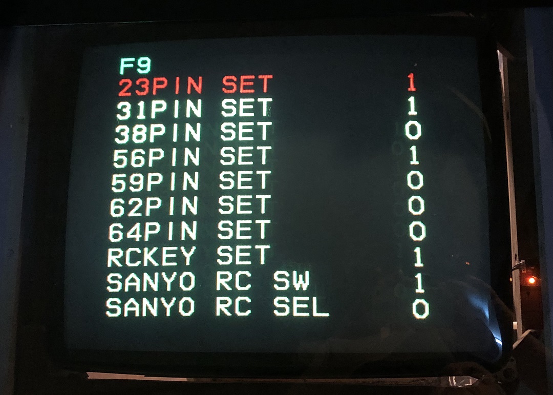

« Reply #96 on: September 13, 2022, 05:07:43 am »
Before mounting the door, I was going to fit a slightly larger CRT. Previously there was a 20", new CRT is 21".
I component-modded this TV one evening, two or three weeks ago. I was very impressed with the picture quality, so wanted to use it. The modding went exactly like this thread I wrote up late last year.
This new TV, like the old one, will be powered by a GreenAntz transcoder.
First thing to do was to make some new holes for the T-nuts. The new holes are approximately 1.25cm away from the old ones (1/2 inch).
You can see here why I prefer to support the CRT with two wooden brackets, top and bottom. Because they are separated, I can slide them up and down to match the CRT.
Hopefully you can also see here why I prefer to make the brackets with an angled inside edge about two inches long. This gives me the flexibility to accommodate tubes of different sizes. Having said all that, this 21" tube is about as big as I could ever fit into this cab.
You might notice that I have already fitted a 12v 3" fan in the back. I got this out of the way first because, after I've fitted the CRT and the speakers, I won't be able to get in there to install the fan.
After taking these photos and mounting the CRT, I realised that the top of the screen was now too high, it was going to sneak up under the speaker panel. So I had to lower both brackets by around 1.5-2cm. This was pretty easy though, I just had to unscrew them and slide them down.
You can see the remote control board for the TV mounted on the right side. It is convenient for now, but may go somewhere else once I get a bezel on.
You can see here how I put the screw in the T-nut the wrong way (deliberately). While I'm sorting the cab out the CRT may come out for various reasons, so I prefer to leave it like this until I'm done working on the cab. When done, I'll switch the screws back and bolt it all down.
NEXT: DISASTER!!!

The TV chassis had been sitting on my electronics workbench for a couple of weeks while I was sorting the paint and other things out. So I grabbed the CRT and chassis, mounted it all into the cab and fired it up, but ...
It wasn't working right. The TV wasn't switching into YUV mode (which I need), and in fact the TV/AV button on the remote was not working at all. Some buttons on the remote did not seem to work, or worked only intermittently. I went into the menu, then I saw this (below/left):
The menu did not look right, and furthermore there were these garbage characters along the bottom line.
I did manage to get into the service menu and was looking to see if there was a reset or something (there isn't). Then I was at the screen you see (above/right), and changed the value of "64PIN SET" from "0" to "1" (default value, according to manual), and about 2 seconds later the TV just turned itself off.
That was it. The TV wasn't coming on anymore. Off on holidays.

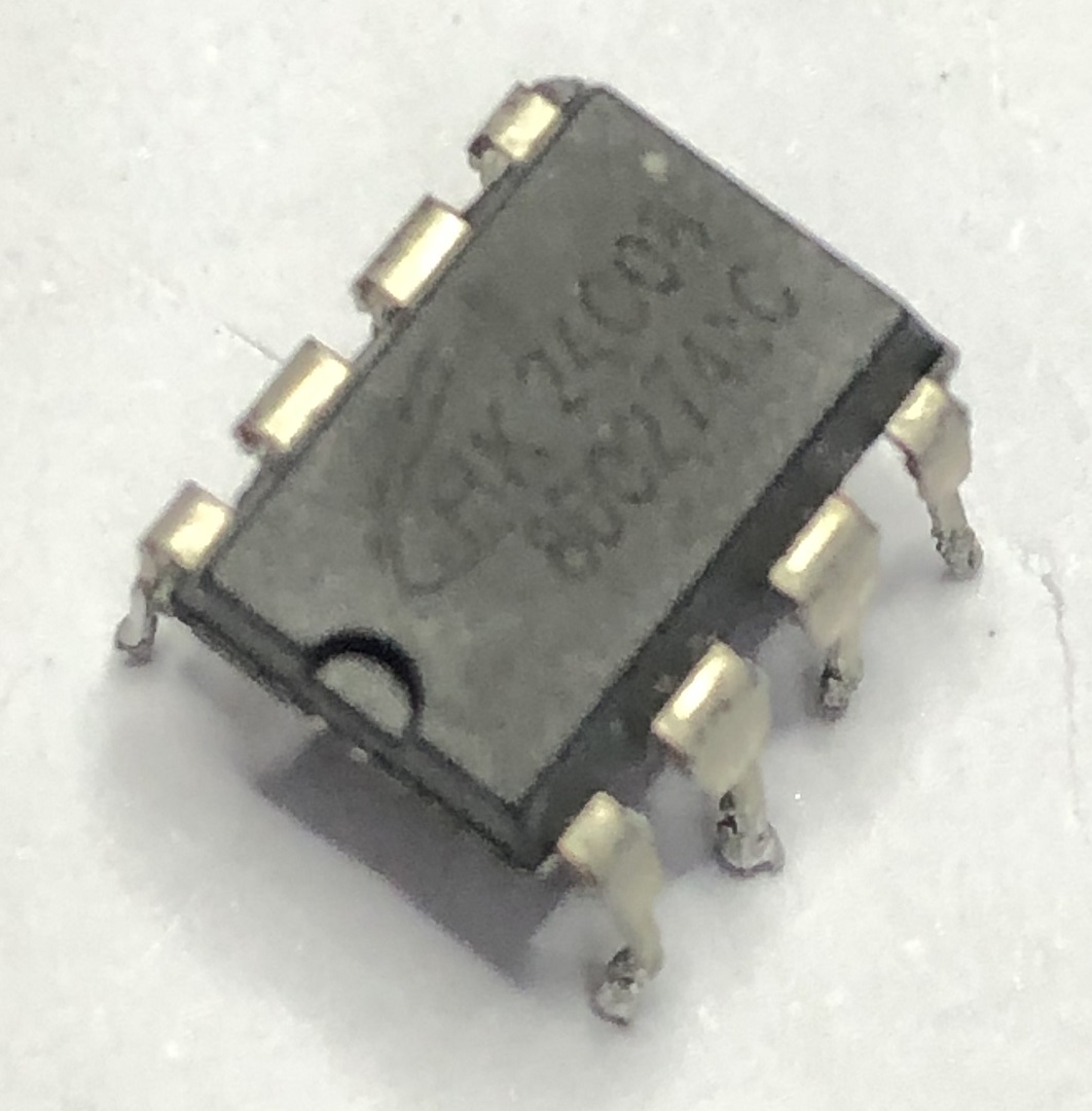

I spent a day looking through my other CRT TVs to see if there was one suitable for this 21" tube, which I liked and had already mounted. After going through about eight TVs, but there was no easy match.
My first theory was that the 64-pin jungle chip, which controls the remote among other things, was either dead or corrupted. This is not a good thing, as changing a 64-pin chip is never easy.
The problem with that theory is that the jungle chip doesn't actually store any data. So how can it get corrupted? The more I thought about this, the more I thought there must be something else going on.
So I had another really good look at the chassis, and finally noticed this little 8-pin IC sitting quietly in a corner (circled in yellow, below). I had no idea what it was, initially I thought it might be a video amp as it was near the cable that takes RGB up to the neckboard. So I looked at the numbers, "HK24C08", and googled it.
Turns out HK24C08 is an EEPROM chip! It must service the jungle! I confirmed this by finding the traces to jungle chip serial data lines.
Unfortunately no way to properly test the IC. Corrupted data != shorts.
So, I took a huge gulp, girded my loins, and removed the chip. I replaced it with an identical chip I pulled off a currently not-working but nearly identical TV chassis. I fired up the TV again aaaaaaannnnnndd.........
It worked!!!!!
That is probably the most ballsy repair I've ever done. Pure hunch/theory.
I had to spend half a morning rejigging a lot of values via service menu, but now it is working and looking 100% again :D
