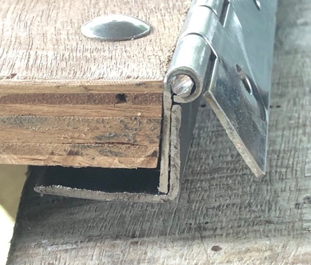

One complication to my plans was that I required the CP to be hinged. With a hinge, it is easy to open the panel and access switches, wires for servicing.
So I sourced some piano hinges. These came in lengths of 2 metres each. Then I cut a piece to the required width (53.4cm) with an angle grinder. The thing to be aware of here is to cut the hinge so that one half comes to the outside at both ends. That keeps it together. Otherwise the hinge halves can tend to come apart. I don't know if that all makes sense, but I'm not sure how else to explain it.
Here is a pic of the uncut piano hinge. Unfortunately I didn't take any separate pics of the cut hinge.

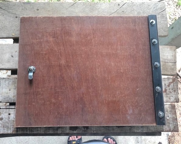

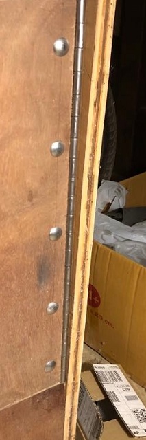

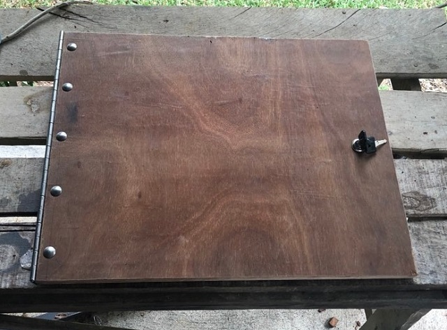

What I did first was to use gaffer tape (cloth tape) to temporarily connect the hinge onto the bottom of the panel and installed the right-angle bracket onto the cab. Then I was able to roughly put the CP into place, to see how it would sit.
I did a fair bit of trimming to size with my angle grinder, a file and some sandpaper. One thing to be aware of is sharp edges on freshly cut steel - so a good idea to grind them back too. Very easy to get a nasty cut otherwise.
Probably a good idea to wear proper shoes and eye protection when doing this, as it generates a lot of sparks. I wore safety goggles but was only wearing sandals, and a tiny piece of red-hot steel landed in between my toes. Not fun, very ouchie, but fortunately no permanent damage ;)
Interestingly I'd recently commented on another thread that I should probably wear better footwear in the workshop. Oh well.
I also cut the holes for joysticks and buttons because I wanted to work out where to put the clips (see below).
Eventually I was ready to go off to a local welder. I don't do welding, and I'm not about to learn. Very worthwhile getting someone who knows what they are doing for this part. I just explained what I wanted. The hinge metal is relatively thin and is easy to damage with improper welding technique. I went with my brother-in-law who knows more about welding than I do.
I got them to weld the hinge to a) the main CP and also b) to the right-angle bracket. Then asked them to cut 2 pieces about 5-6cm long each from the 1cm wide offcut (remember I collected this from the metal shop earlier?), and then bend those pieces into a "C" shape. Finally they weld those pieces onto the underside of the CP. These are clips that the clamps with grab onto when securing the CP.
Anyway, here are the results.

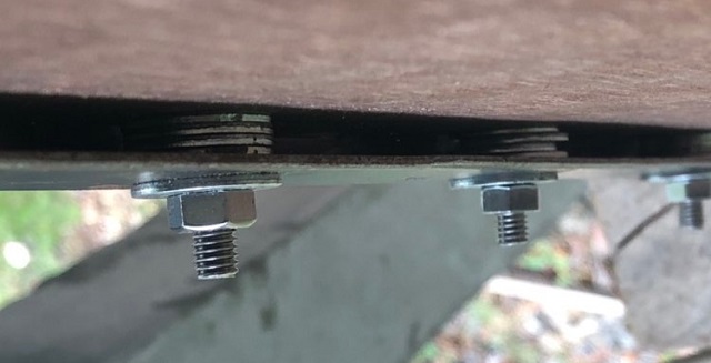

Fitting the control panel
Fitting the right-angle bracket on was pretty straight-forward.
I needed to add an extra piece of plywood underneath the CP, so that I could mount the clamps below. This plywood also provided a flat solid surface to the CP to be clamped down to.
Now I realised I'd positioned the button holes maybe 10mm higher than I should have, because the plywood now partly occluded a couple of buttons and part of the joysticks. So I got busy with my hammer and chisel to make some more room.

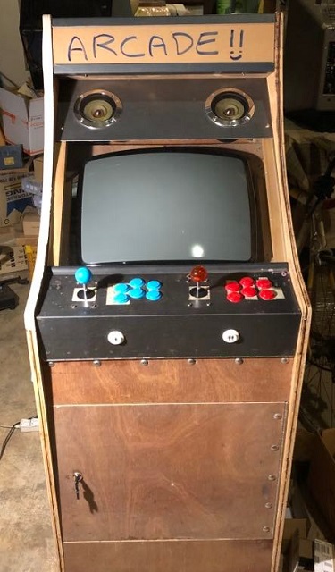

And here is how it looks when it all comes together.
Those with keen eyes may notice that I made a mistake when drilling holes for mounting the right-angle bracket. I drilled 6 holes for mounting M5 bolts, but one hole was 10mm out (I must have slipped the ruler without noticing). So I'll have to get busy with some putty and sandpaper later. Eventually I will replace the hex-head bolts you see here with carriage bolts (smooth domed head), but I need to paint their heads black first!
In general I'm quite happy with the way it has all come together. I was worried about there being a gap between the wood and the hinge, but there is really no gap at all. I can barely get the tip of a fingernail in there.
BTW, the paper tape on the left side of the cab is there to protect the T-molding groove from my aforementioned brother-in-law's wandering hands. He had a habit of running his finger down the curve while walking past, which was making the wood start to flake away from the unprotected edge. So, tape.
The CP also feels very solid. I'm sure I could pick the whole cab up by the CP, if I was stong enough. The panel in recessed from the wood edge by at least several millimetres, and once the T-molding is applied it will be perfect.
Speaking of strength, I did the last parts of this (assembly and installation) with my left arm in constant pain, and only roughly 25-50% capacity, from cubital tunnel syndrome (Ulnar nerve entrapment, at the elbow). So it took a while. My arm still has the problem, but has improved somewhat since with massage/rest/exercises.
Obviously the cab still has quite a way to go, but this is an important milestone. Next I'd like to get some glass done, mount some speakers above the monitor, and make a front door with a recessed mini-control panel (for credits/pause/admin/volume etc). Then some finishing and some art.
Speaking of art, I need something to cover the control panel. Currently it is just bare metal! I was thinking about using some 6D carbon-graphene vynil used for automotive detailing. Or maybe just black paint. I don't want anything too fancy. Suggestions?

I got the front door fitted today. I also fitted a simple panel to close up the back (not pictured). As a tribute to yamatetsu, I got the magic marker out :D  8)
While I was there, I changed the hex-head bolts for the control panel for carriage bolts, to match the ones used on the door. In case you are wondering, I used a small chisel to carefully square the top of the bolt holes.
I am starting to think I will leave the carriage bolt heads chrome, instead of painting them black like I was thinking a while back. Once I put a bit of colour on the door/sides, I think they will "pop" nicely! A little bit of bling doesn't hurt.
You can see here how the door hinge will just sneak in below the T-molding! More on this in a moment.
Here is how the door looks before installation:
FRONT:
BACK:
For the door hinge, I used the same technique as already used on the control panel - and welded an L bracket onto one half of the piano hinge. This got a little trickier though, because I used a larger piano hinge for the door.
The large hinge, and needing to sneak it in under the T-molding, created some issues. The L-bracket came out too far from the door! Of course, this only became glaringly apparent after the welding.
Another issue was that the welded hinge was a little off a proper right angle. So I fired up the table saw, angled the blade very slightly to match the angle of the hinge, and shaved a little off the end contacting the hinge.
To pull the hinge in, I used some washers to "shim" out the hinge, at back, to the right position. You could also cut a piece of wood to size, but throwing the washers in was easy. Oh, and the carriage bolts I bought were too short now, so I had to buy longer ones! Ah well. I got to use the shorter carriage bolts for the control panel anyway.
Now this may shock you - I plan to cut a hole in that door! I want to put a mini-control panel in there, maybe about 4" x 6", which will accommodate credit/pause/admin buttons, a volume control and USB ports. Maybe headphone port too! More on that later.
Nice! Next time, use a neon marker to give it that 80's vibe...

Hm. I guess my sneaky pic was a bit too sneaky. Or not worth a comment. Oh well.
Zebidee
  • Posts: 3499
  • Last login:February 03, 2026, 08:27:25 am
Re: Aussie lowboy with hinged metal control panel
« Reply #27 on: June 21, 2022, 08:34:28 pm »
:lol I love it of course. I just hope that is a heart <3

I was concerned about what the image on the screen might be, but was more concerned that if I said something that the real answer might give me bad dreams.
Errrm, no. I looked at the speakers and the monitor and saw a face going 'O', so I added a tongue sticking out. I guess it isn't as obvious as I thought.

Cranking up the silliness a notch.

Crikey! Now I get it.
I was only slightly concerned, because I thought it looked a bit like a butt. Butt (sic) then I thought a "heart" was a better interpretation.
If you look carefully at my pic of the amp, you can a faint heart there. That is because I plopped it on top of a swim lesson plan I'd done earlier (breaststroke). The heart (or is it a butt?) is to describe the shape of how you move your hands/arms for the pull. When teaching, I prefer to think of it as a heart, so that is where my mind was at :D
There you go, a bit of Freudian interpretation to enlighten your day.
