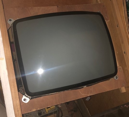

I have a 32" SONY I just finished RGB modding to use for an arcade cabinet. I imagine this is not what most people use since the thing weighs around 170lbs, but the image quality is important and I'm planning to use it for a 4 player cab.
ATM I have it mounted in 1-1/2" angle iron frame I fabbed to keep it from getting damaged while it was being modded and with the thought I could put it in the cab this way. This tube is so hard to handle because of it's weight and tendency to want to flip onto the screen. The metal frame tilts it back a bit and balances it's center of gravity better.
I need the cabinet to be able to make it through a doorway. Also, I want it down on the first level of my house so it'll have to go down stairs. I was thinking of building the cab in stages to be easier to get to where it needs to be. So maybe plywood boxes, basically, that stack to form the center of the cabinet and then two sides to give it the side profile of an arcade cabinet. The control panel can be a separate box on the front.
The framed crt could set in the middle "box" section. Realistically, only the bottom would need to be a box and strong enough to support the CRT and everything above that doesn't matter so much. Just the marquee light and a speaker above the TV.
I think the conventional way of assembling a cab probably won't be enough to hold a 170lb CRT not to mention getting it in there without busting a nut in the process.
If anyone has any suggestions or experiences I'd be interested in them.

Conventional method for mounting the CRT in a cab will work fine. I've done it with 27" Sony PVMs which must weigh at least as much as your 32" (because of all the extra electronics and shielding) and yes, the Trinitron tubes weigh more than normal tubes because they use an aperture grill instead of the (lighter) shadow mask.
To mount the CRT "conventionally", all you need are four pieces of decent offcuts from a strong wood like 3/4" plywood, which incidentally is what I prefer to make cabs out of, so there is always plenty lying around. The four wood offcuts only need to be maybe up to 3-4 inches wide and a bit longer than the side of your monitor
The first two wood pieces are just for blocking. They just need one straight edge and are screwed into the side of the monitor bay at the angle you want the screen to be.
The other two wood pieces will bracket the CRT, and the weight will rest on top of the blocking pieces. To let the brackets snuggle up to the CRT corner pegs, cut part of the wood straight at roughly 45 degrees (like shown below). This will give you some wiggle-room, as the angle will always come to the corner pegs optimally. You can then just slide the two pieces to the tube so that they always fit perfectly.
This design has another advantage - if you cut the 45 degree angle part long enough, say up to two inches, it is easy to swap out the tube for another one of similar size. You just slide the wood brackets up and down to find the right spots for the CRT pegs and drill a new hole
The CRT in pics above is resting very happily there, even though it is not bolted down!

I'd really prefer to do it your way, but honestly, I don't think I could maneuver the tube into place without breaking something. Granted making it in a metal frame makes it big and cumbersome, but I can grab ahold of the frame and stay away from the delicate neck.
My frame has a pivot and if I drill new holes in the side straps, which are made from 1/4" aluminum bus-bars from some recycled switch gear, I can angle it however much I need granted the neck doesn't hit the frame in the back. If I go much further than it is my PCB  won't fit nicely under there and I'll have to get fancy.
I'm still up in the air as to how far I want to tilt the tube back. I'll probably make the base I was talking about and set it up there to get an idea of how it will look. If I was doing a vertical shooter I'd definitely have it more plumb, but I feel like a lot of horizontal fighters look better at an angle.??

I mounted a 36" vertically in a KI2 cab using the factory mounting hardware for the 25" CRT, the square thingies from Midway.
http://forum.arcadecontrols.com/index.php/topic,97260.msg1025567.html

I have added an orthogonal strongback of plywood on the backside of the brace that Zebidee shows for tubes 24" and larger and it has added the sense of security of a metal frame.
If you can weld and drill and metal though then have at it!

It doesn't look like much, but I figured out how to get the tube on the base. I laid it all on it's side and bolted the frame to the base. Then i could tip the whole thing up. Me lifting the tube alone wasn't going to happen and I don't have friends to help because I'm too busy with projects to have friends.
Right now I'm figuring out where everything is going and routing wires. I changed my mind about airbrushing.  I would love to but I have two other large projects I'd like to finish this winter plus im going to school four days a week and working 45+ hours a week. So I think I will just be staining the wood since everything in my house is very 'woody'.
My sides turned out ridiculously tall unfortunately.
Contemplating cutting the top down and just making a flat marque in that space over the tube..

Zebidee
  • Posts: 3499
  • Last login:January 07, 2026, 10:22:02 am
Re: Ideas on mounting large crts?
« Reply #44 on: January 06, 2022, 06:46:27 am »
Yeah, I vote for that idea. Would look tidy then, rather than overbearing.

I probably should have waited to get the tube up on the base before laying out my silhouette but you know how it is..
Edgecrusher
  • Posts: 71
  • Last login:November 17, 2023, 04:01:16 am
  • This is the way
« Reply #46 on: January 17, 2022, 06:44:45 am »
Well it dawned on me all I had to do is bring the screen up more and it fit my silhouette better. This is no small kiddie cabinet. Just thought I'd share my progress. I have it apart now trying to paint the pieces which is hard to do indoors in the winter, but I'll finger it out.
