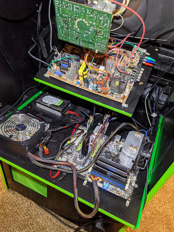

I believe I'm getting a ground loop hum coming from my CRT monitor. I didn't really notice it up until now because I was doing some troubleshooting with a second LCD monitor attached to my graphics card. And what happened was I plugged the LCD monitor into an external outlet (Not the power strip in the cabinet) and as soon as I plugged in the DVI connector the hum went away. I experimented a bit and as long as I touch the dvi cable to the connector on the graphics card, it goes away. If I unplug the LCD monitor from the wall and try it, the hum is still present.
So I'm guessing I have a ground loop somewhere. Question is should I have run a ground to everything (My PC is de-cased and mounted on a wooden board) and would I pull that ground just from a ground on the powerstrip itself? Should I have the monitor, PC and PC power supply all grounded externally to the wall power supply like this?
Thanks All!!

Thanks for the reply. I'll attach a couple pictures, hopefully they can clarify.  The CRT is a de-cased Samsung TV, so yes it only has a two prong outlet.
Would I ground the board as well as the CRT chassis you think? Probably same to one of the PC motherboard standoffs?

Cool build.
Find a ground point on the TV chassis and also some metal part of the tube assembly and bond that to your power inlet ground and you should be good.
A regular arcade monitor chassis and tube is tied together groundwise through the frame and then linked somewhere in the cabinet to power supply ground- but a TV setup is lacking that of course so you have to make it.
In theory the motherboard should already be grounded through its power supply but if the noise continues then you would want all those components grounded to a single point.
Make sure that you are connecting DC ground to DC ground - never try to connect a CRT ground to mains power ground. This is because CRTs use DC rectifiers and/or isolation transformers to make a completely separate circuit from the mains. Also, some of the metal shields around TV chassis are actually active B+ voltage (e.g. the HOT). So check with your multimeter first for connectivity between your possible contact point and video ground at the inputs.
Try connecting to PC ground via a spare power connector, or even sliding the wire in behind one of the main ATX power connections. This will give a more direct return path. Even assuming the standoff pads are connected to circuit DC ground, it would mean a longer path and more interference.
Of course your hum could be a funky connection somewhere, so check all your CRT video connections again too, especially grounds. If you are using a transcoder (I see component inputs to TV there) that also means more connections to go funky, so gently wiggle/twist your cables and tap on things.
You could try a line filter for the TV power input to clear up noise from the AC.

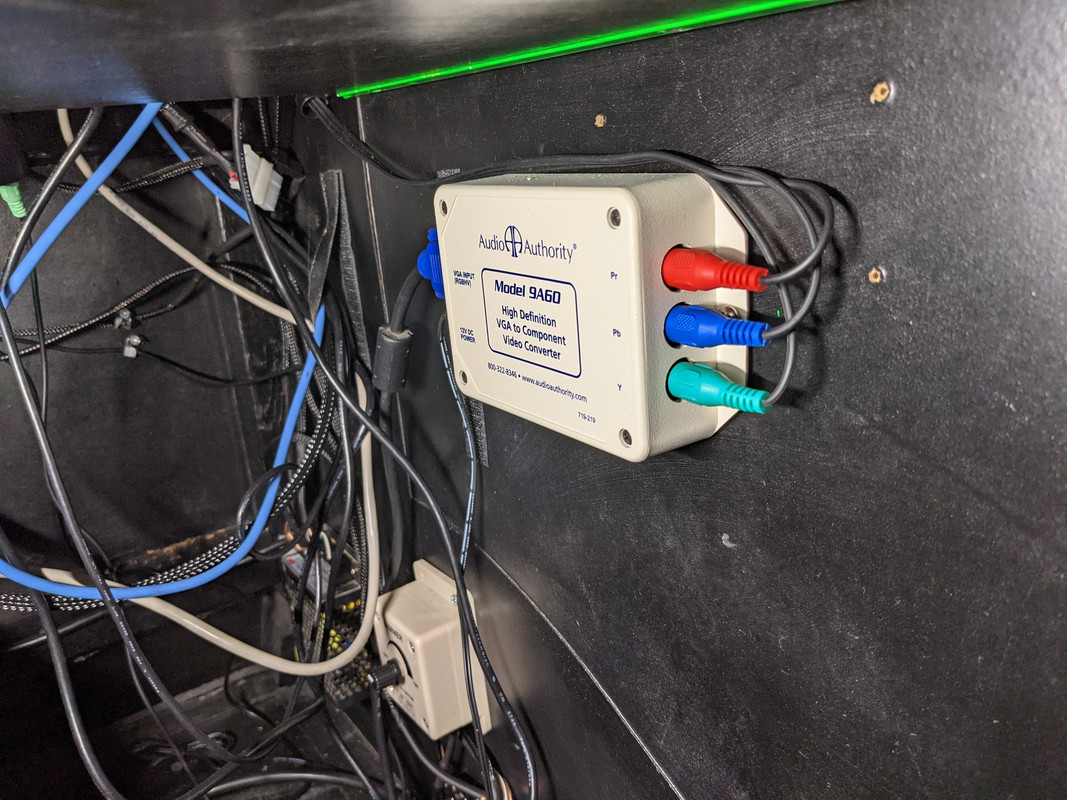

How exactly are you getting component out from video card to TV?

Copy that, I'll use one of the molex connectors on my power supply to pull DC ground.  What about the crt frame? Should I bother with a ground for that? Should that be an earth ground? What about any other metal parts, such as the coin door while I'm at it? Should that be earth grounded?
I have an audio authority converter for component.
