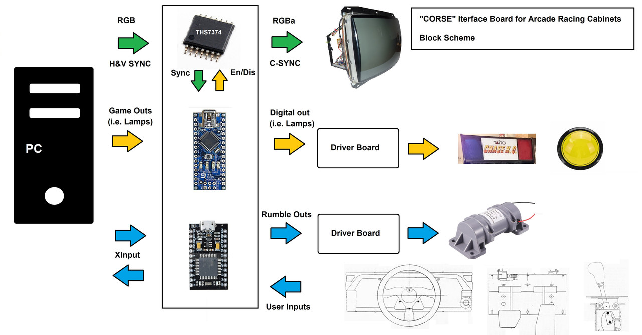

To reassume the project, this PC-to-racing cabinet interface:
- aims at the simplification of the convertion of a "pseudo-jamma" racing cabinet to a MAME/PC racing cabinet
- aims at maintaining the cabinet CRT monitor, with block of potentially dangerous out-of-sync signals and on-board video amplifier for a better picture
- aims at maintaining the cabinet factory controls (wheel, pedal, shifter, buttons)
- allows you to play any game/emulator supporting Xinput
- can handle game outputs (2 rumble signals and 8 generic outs, i.e lamps, additional motors, etc.)
A block diagram of the whole project could help figuring out what the interface is made up of:
Hardware
The hardware maily consists of two arduino boards and a video amplifier. Arduino's are a pro-micro (ATmega 32u4) emulating an Xinput device for user inputs and rumble, and a nano v3 (ATmega168P, 5V) for sync frequency check and lamps outputs. The video amplifier is a THS7374 SMD IC, most commonly used in consoles hacking.
I have not included an audio amplifier here so that one can choose the right amp for the cabinet is use. The same is even more true for driver boards (even if I designed a set) as their selection is strictly related to the load to drive.
Separate horizontal and vertical sync signal coming from the PC are turned into composite via a (very simple) onboard circuit.
