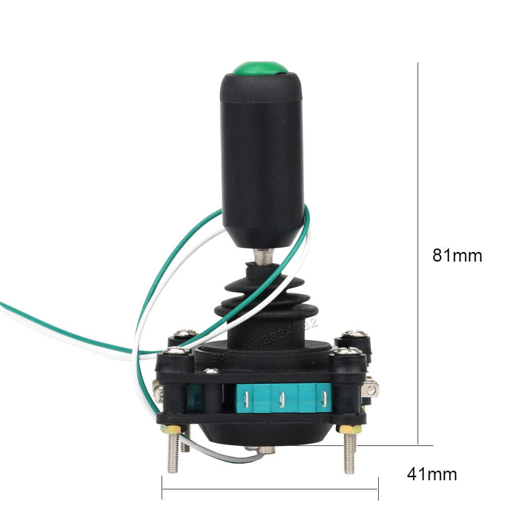

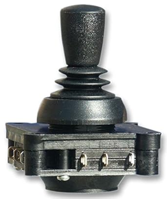

That analog 3-axis joystick won't work with the microswitch-only IPac4 encoder.
- You would need an analog encoder like an A-Pac, a U-HID/UHID Nano, or a 32u4 Arduino (i.e. one with A/D converter inputs) running a firmware like KADE miniArcade 2.0.
For small microswitch joysticks, use search terms "240v joystick" in Amazon and you'll find ones like this one or this one.
- Both use the same size base, switches, and restrictor plates.
- The second one has a taller handle with a green top-fire button.
There's also this one from Apem with a slightly different handle shape.
You should be able to put yaw/pitch on one stick and roll/throttle on a second stick if you want a 2-stick, 4-axis setup.
