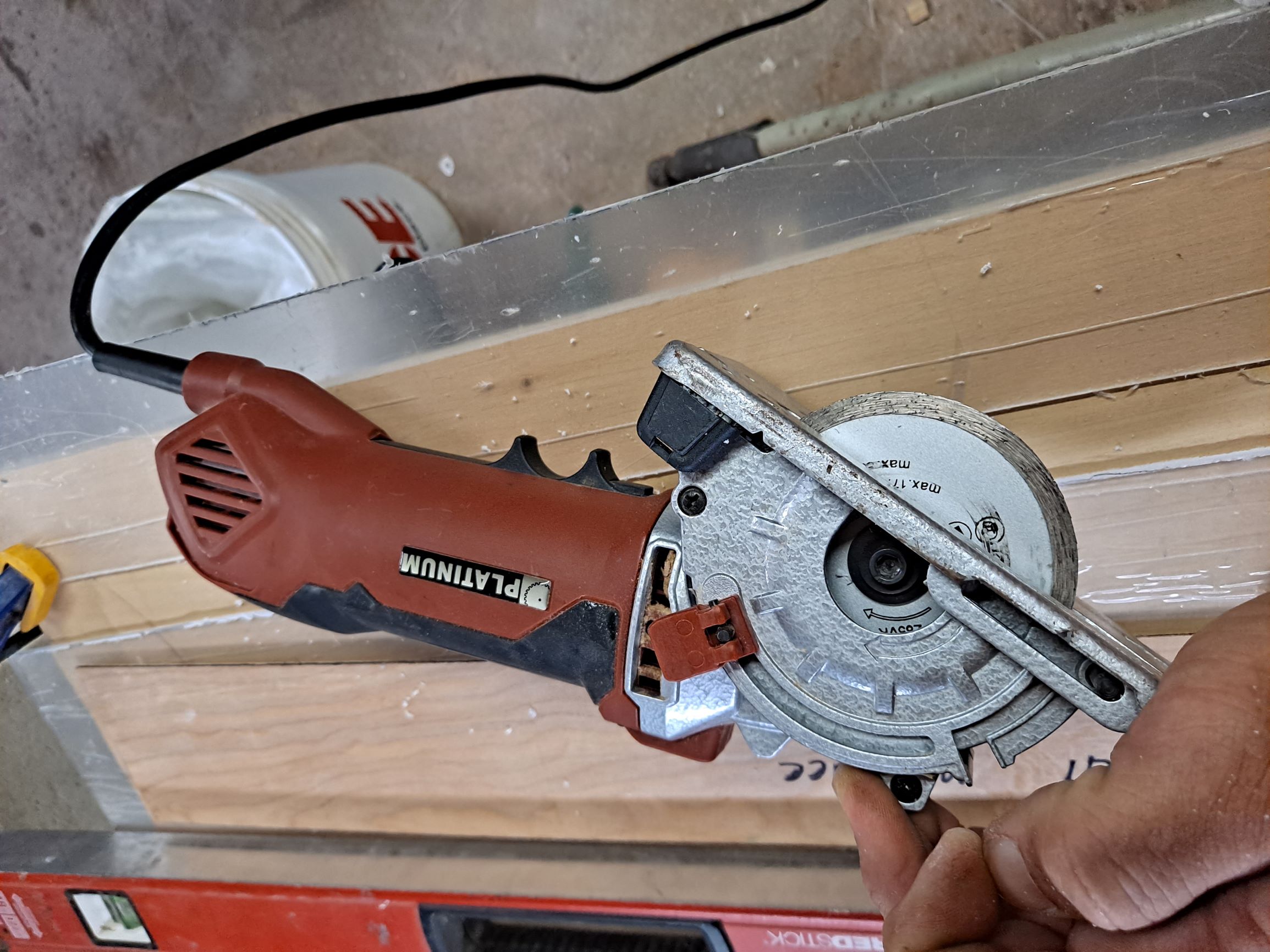

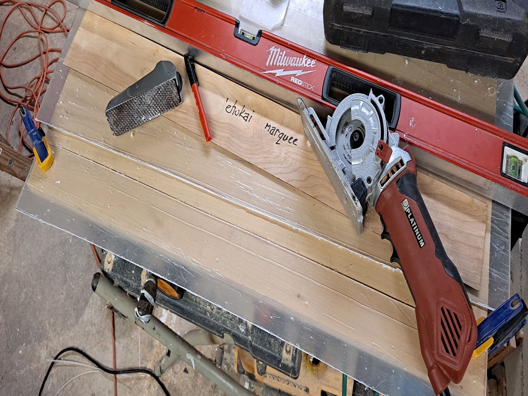

Found a piece of "shattered ice" milky plastic stuff in small sheet form at Home Cheapo while shopping for a job so figured I would give it a shot.
I was guessing that having this layer underneath some regular clear stuff could give the desired effect (eventually)
Not hard to cut with the template I already made- and the proper blade.
One might think that a diamond blade would be overkill for cutting plastic- but since it doesn't have teeth it doesn't tear or crack anything!
And this small form circular saw is great if you go slowly enough to cut clean lines.

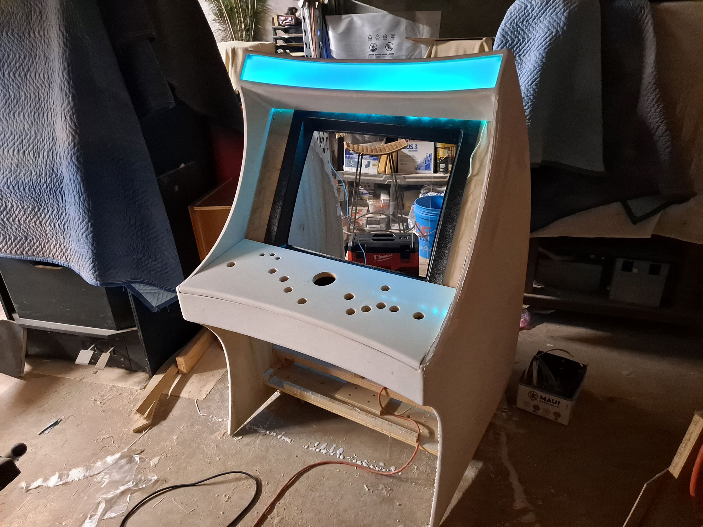

I layered the pieces into the marquee zone to see if they would fit.
They slide into the upper slot enough to clear the bottom panel and then drop into place quite nicely.
Finally got to use these LED rgb strips that the lady of the house got me years ago.
Using two separate units to get a color mix that looks like the ocean out here on a sunny day, and...
Viola!
Now if I can get some Schwepps style effervescence into this whole get up it will be just what I wanted.
Any suggestions on bubbly or foamy light motion are quite welcome!

I know you were worried about the marquee being too small, but I actually think it looks perfect!
I can really imagine this placed in a fish 'n' chip shop down at the beach! <sniff> <sniff> Is that a salty sea breeze I can smell?

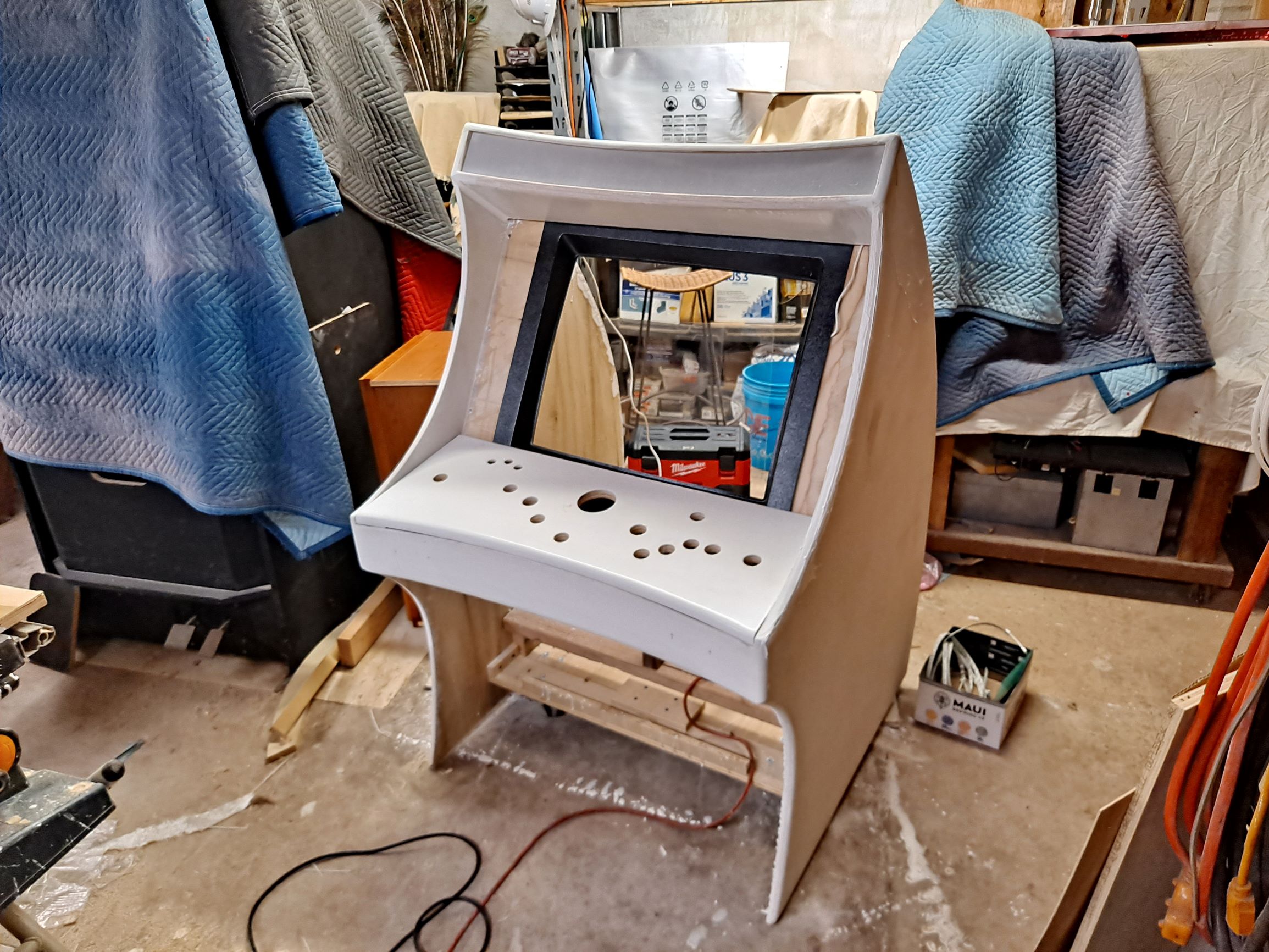

Straight to the meat with the bezel from hell.
I nearly didn't work on this tonight, but I'm glad I decided to go look at it.
After some nervous measuring, trimming to width with my teeth clenched, and a bit of height adjustment (since this has about half the flexibility of the real plastic one) I got it.
And it fits!
And with the bottom corners cut out to clear the control panel supports on the cabinet, it even gets in and out the way I intended
Whew-  :notworthy:
Gave it what should be the last fill coat to sand out for a nice smooth finish and then the last bit of white again and this part at least is done.
This endeavor alone is the only argument necessary for ownership of a vacuum table apparatus!

In spite of our 100% humidity I got some work done.
I knew from the get go that I was due for a good corn-holing somewhere with this cabinet because of the whole "want a bunch of curves in it" spec (say that with a good nasal whine for full effect-) and so it has arrived- the back panel.
Figured the only way I was making something to work was layers of 1/8" ply that I somehow molded to shape and then glassed to fight the spring-back.
And so, a lot of Titebond, drywall screws, and some added weight?!
I let it sit for a day and holy crap, I think it is going to fit.
While I was sorting out getting the first layer of cloth onto that I figured I may as well try for last coat of pigmented resin on one of the main body sides.
For all the freakin bugs that decided to come party in my nice smooth layer I may have to rename this damn thing Beetlemania.
5 of the little ---daisies--- committed suicide in my work tonight.   :angry:
That irritated me enough that I decided I deserved a reward and should sand out the control panel as I had already given it two hot coats of clear yesterday.
Got through wet sanding and first round of compound at least.
With one round of polish left to go I am always happy to see that the self flagellation of working with glass does have a reward.
