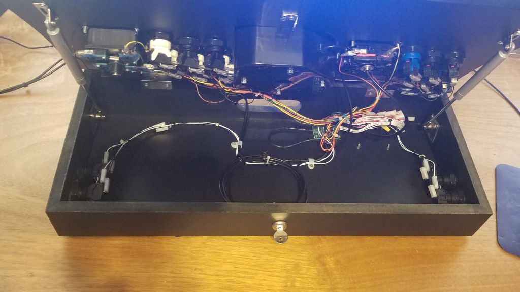

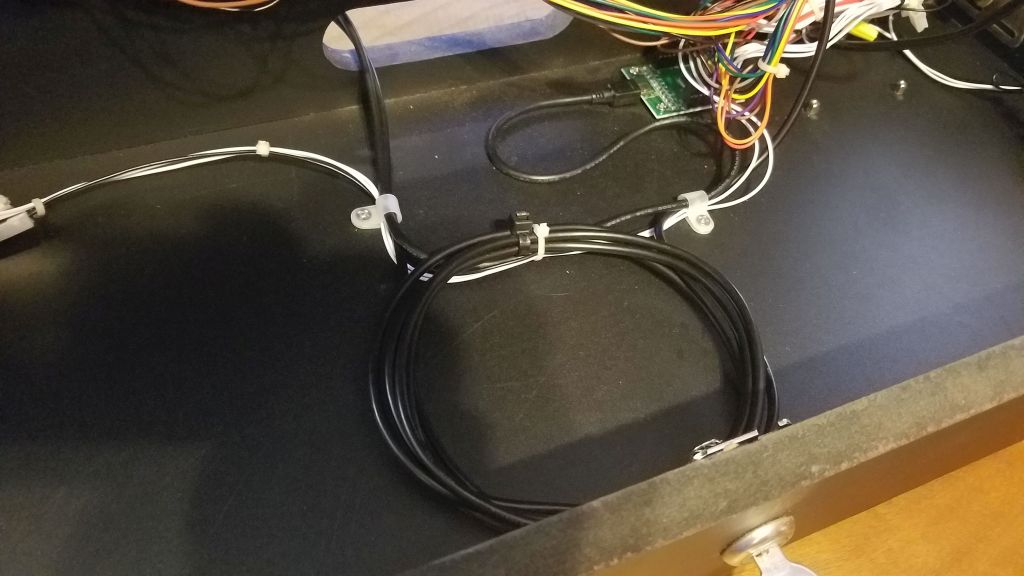

Very professional and clean wiring:
There are 2 support struts to hold the top open, and you turn
a key in the lock to open it. Which makes it incredibly easy
to mod, or diagnose any issues.
The wiring is very clean, and there are 2 connectors going
to the controller board. I didn't alter or mess with any
of the wiring.
There is a yellow LED that lights up when power through USB is used.

As your picture shows, there is a fourth model.
Dual, no PI - $120
Dual, PI - $150
Dual, Trackball, no PI - $150
Dual, Trackball, PI - $200
That last one seems like a ripoff, if the PI is identical in both PI models.

Re: Atari - Twin Joystick and Trackball with USB [REVIEW]
« Reply #34 on: January 30, 2021, 10:18:12 pm »
I received mine yesterday, and figured I'd answer a couple of my own questions and offer a few observations.
Adding flipper buttons to this unit may be tricky, as the little pneumatic/gas struts which prop the control panel open fold into the areas where you might normally want to place flippers. There may be enough room below the centerline of the strut to allow button placement in the lower sides, but I won't know for sure until some of the extra buttons I'd ordered arrive (I don't feel like disassembling any of the buttons currently installed to test fit; I'll be going through the panel once I've got my new parts in hand). The stock wire harness does include pre-crimped leads for ~7 additional inputs per player (input is handled by a XinMo board which outputs as two separate game pad controllers) and the leads do seem to have enough length to populate buttons just about anywhere in the case.
The trackball does have a pigtailed cable end, with the USB connector at the terminus and a PS/2 connector ganged on about 8" from the end. The trackball encoder is internal to the unit. It does seem subjectively better to me than the one in the Tankstick, in that it is smoother on all axes and the ball is fit more closely within the trackball case, such that it doesn't chatter under hard input like the X-Arcade unit I had did. I haven't noticed any issues with backspin or resolution in MAME on PC. It's still much coarser in feel and nowhere near as smooth as a real arcade unit (my benchmark is the one Atari used in Missile Command), but it's serviceable for what it is and does seem to be improving as the bearings break in.
On that same note, the sticks, buttons and switches (all Baolian-branded) are serviceable but not great in my opinion. The sticks are more stiffly sprung than the IL Compact models they copy, and have some pretty noticeable interference in their pivots in certain spots - some cleanup and lubrication of the pivots may help. The size of the circular gates and positions of the microswitches make diagonals a little bit inconsistent, and it seems like the engagement range is not completely symmetrical on the cardinals. The microswitches fit to the sticks and buttons all have a fairly heavy actuation force; I'm guessing that they're north of ~50g. Very stiff and clicky. I much prefer the lightest action possible on microswitch buttons and sticks and usually use 20g switches by preference. The button plungers are typical of IL clones - spring force feels fine but a little sloppy in terms of lateral movement. It all works reliably at a basic level, but there is definite room for improvement.
One other minor issue is that there is no strain relief in the cabinet for the USB cables, which combined with the large oval cutout for cable passage which @thatpurplestuff pointed out could cause eventual fatigue issues with the micro-usb cable header on the XinMo board.
With regard to the joystick axis mode switch discussed earlier in this thread, what the mode switch does is change the reported axis from 'joystick' to 'hat switch' in Windows. It doesn't have anything to do with analog/digital switching. There is no button installed for the purpose, but the function is available by pin header if desired.
All else aside I agree completely with @thatpurplestuff in his review above. The product is a good value for what it is, and probably more than fine for its intended audience. I'm not unhappy with it. For the BYOAC crowd in general you may find the controls to be a little under par when compared to genuine articles, which is probably not a surprise to most here :)
jeremymtc
  • Posts: 252
  • Last login:February 14, 2026, 05:36:37 am
« Reply #35 on: February 20, 2021, 02:17:54 am »
Added flipper buttons to my Micro Center stick. Space was really tight due to the aforementioned prop struts, but with some mocking up and measurement was able to get them situated.
I also installed a mini-grip flight stick on P2, and have been tweaking and modding it to work a bit better than it did stock. Tightened up some rotational slop in the pivot, shimmed up the centering spring a bit to give it a little preload, removed the external spring from the topfire button, filled the handle with lead shot to give it some extra mass, and swapped out the switches with lighter-action units. I am on the lookout for a stiffer centering spring (and a dustwasher that fits properly), but beyond that I'm happy with the trigger stick now. I can finally play Battlezone without fumbling for a fire button with my thumb or the edge of my palm  :applaud:
I did some wire management as part of the flipper button install and added some strain relief for the USB cables. The cable for the trackball is much longer than the one for the digital encoder so for now it's just coiled and secured; eventually I'll probably cut the cable to length and resolder it. I bundled off and zip-tied the extraneous leads for all the unused Xinmo inputs so the interior is a little bit cleaner, but I do kind of wish that the manufacturer had only harnessed the wires for the inputs actually installed. Not much of a fan of these generic daisy-chain harnesses and their attendant wire clutter  :banghead:
I've decided that the stock Happ Super-clone stick and buttons are going to have to go, and will be replacing them with an Omni2 for the P1 side and better buttons + switchgear from Randy soon. These clone parts just aren't doing it for me - the quality just isn't quite there. Disregard the skittle-barf appearance of the current button colors, they're temporary and will be going away soon. The skittle-barf appearance of the cp artwork will probably remain for a while though :lol
