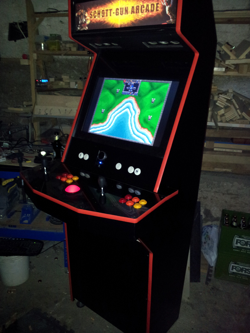

« Reply #25 on: October 28, 2020, 07:22:31 am »
I agree with everyone!
Personally I don't really like the modular panels, as they don't look as good.
However having lots of panels means buying some things many times, storage, more work etc...
I went for the multiple panels idea, but slightly differently.
First of all, I wanted to build a panel that would do almost anything, in case it took me a while (or never) to build the next one.
So, having put all the generic controls (coin, start, power, mouse buttons) off the main panel, I made the top of the panel using quick clip hinges (think they are called euro style hinges in US) and connected everything with parallel printer cables.
For golf, it needed the ball to be much further back from the screen, so I made the panel on rails, and it all slides out about 20cm.
So the concept is.  Slide out, open the top of the panel (just the top part, not the whole thing) like a car bonnet / hood, take out two printer cables, click off, and click in a new one.
The joysticks are 4/8 way adjustable from the top.
What I added later, and you can't see here, is a spinner just above player 1 button 3 (yellow), where the spinner can be removed and a small 20cm steering wheel added.
this covers 95% of games
So I never made another one.....
If I did, would they get used?  I agree with comments above, if friends are looking through your games, and say "do you have XXX", and you look up and say "yup, I'll change the panel, won't take a minute", they just say "it's ok, we'll play some donkey kong instead..."
Most of the time, people, including me, play short bursts of many games for nostalgic reasons only.  So build a panel that covers as much as possible.  But it doesn't have to be a frankenpanel.
I would like I guess
2 trackball for ramparts - would get used 30 mins a year.
4 player eg gauntlet - would get used 1 hour a year
Tron specific, probably good for after burner and some others - might get 4 hours a year
Driving games that have shift, pedals etc... there's so many different ones - but this one might get regular use
firing joysticks for tank type stuff - might get 30 mins a year.
So it's not ever been worth it, there's plenty on there to keep us all happy.
There is a USB hub underneath, so I have added steering wheels with pedals, light guns, usb joy stick capability for those odd occasions...
Hats off to those who are dedicated enough to build either modular panels, or multi-panel systems, maybe one day I will join you!
