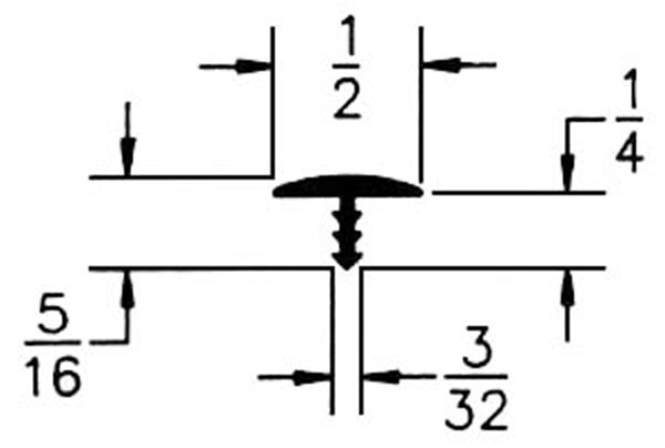

what size slott cutter should i use for 1/2'' mdf for the T-molding slot?
The seller should list the correct size cutter to use with their T-molding.
For example, you would need a 3/32" wide cutter that's at least 1/4" deep for this 1/2" molding.
https://www.t-molding.com/1-2in-black-t-molding.html
