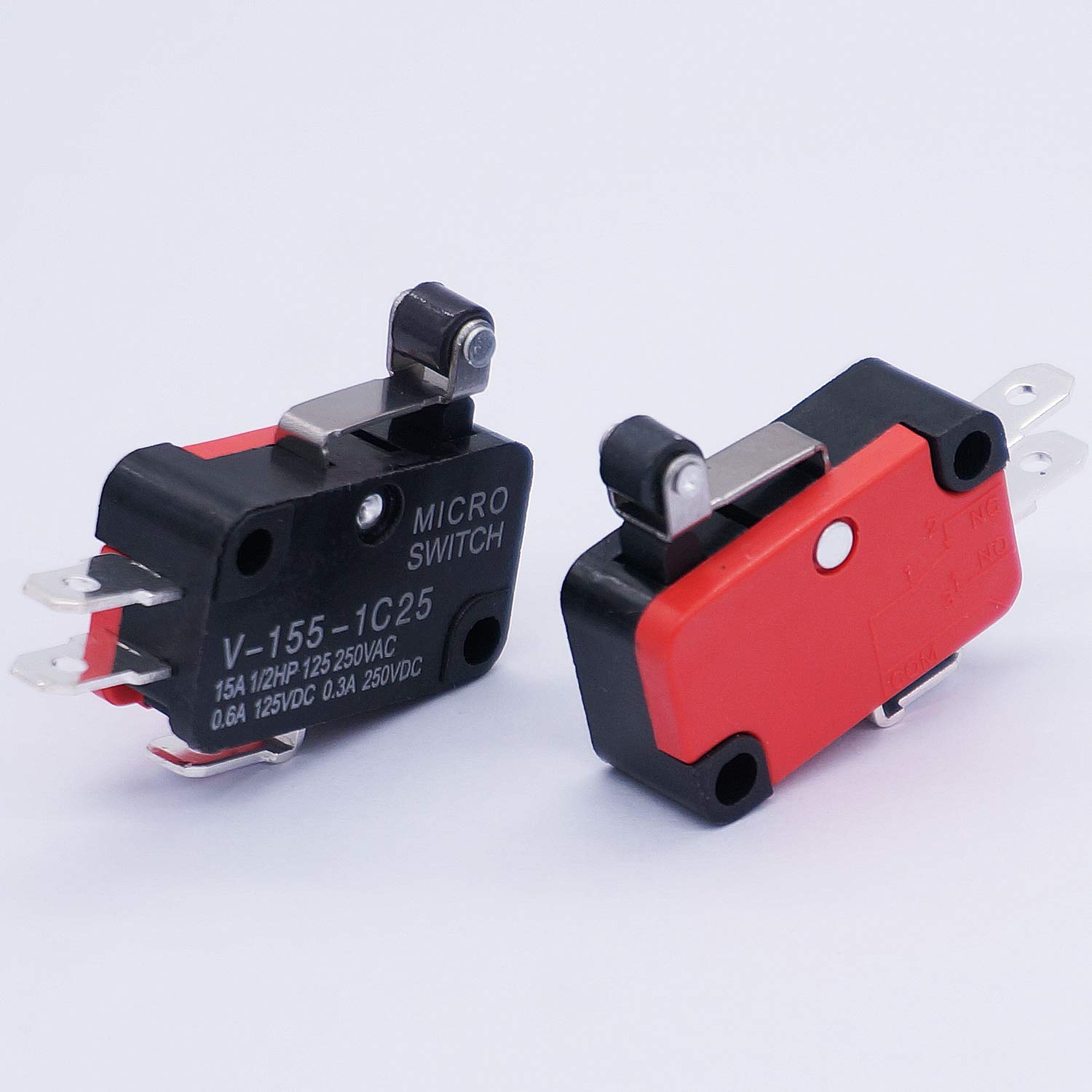

If you need to design your own from scratch, here's a preliminary design with the basic math for the actuator cam:
- I'd update the design to use short roller-arm microswitches like the Taito pic above.

Thanks for the info, I can definitely work with that. I was originally gonna try to do a true reproduction, but honestly there's a lot of stuff I'd change about the original design anyway to reduce the amount of parts. I'll just need to find the estimated amount of travel of the roller switch for my difference in radii and I should be good to go, the rest isn't really much of anything. May also try to machine the gear and cam as one solid piece and broach a keyway through the whole thing to save myself some time, can't really think of a good reason they need to be separate. Also yeah, I actually commented on one of that guy's YouTube videos and got a reply, I may end up going with one of his full-size models if/when he puts them back up.
