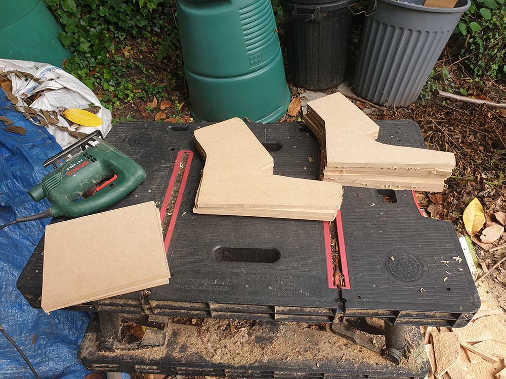

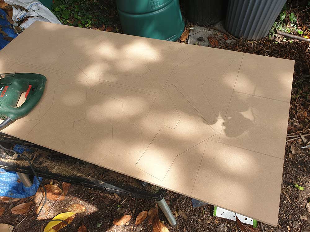

Update 1: Making the sides:
I’m making 3 initially so I got some 12mm MDF to cut the sides and the support panels. Rather than cut lots of small furring trips I thought it would be easier to have an ‘inner profile’ which was secured to the outside. This means for each cab I need to cut 2 profiles (left and right sides) and 2 inner profiles to support the top,back,base,speaker and CP areas.
Here’s some wood before cutting
And after (ones in the middle are the outside, right are inner profiles. Left side are what I’ll be using to house the LCDs)
And flush trimmed against a template I made earlier
Some progress made. I've got a bit more done but I need to sort out some pictures for it. Oh, and this thing is really small. 12" x 12" x 9". But I made a mockup of this one including the cabling first!
