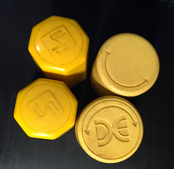

Now here's the thing.  As you know, ikari warriors and most of the popular rotary games used a 12 position switch.  The modern equivalent would be a 12 position rotary encoder.  Well those aren't super common.  What's common is a 20 position rotary encoder.... you can buy a 5 pack of those with knobs on amazon all day long.  I'm also going to write some software for an Arduino Uno to run everything, so a 20 position encoder would also work... I would just ignore the extra clicks, but you would feel those clicks when you turn the knob.
So I'm not sure where to go with this one as the end goal is to design a kit to allow people to inexpensively play the rotary games without much fuss.  Should I stick to my guns with a 12 position encoder, forcing people to go on a snipe hunt and pay 10 bucks shipping, compromise somewhat and design it around a 20 position encoder or just give up and use an old-school 12 position switch, which would really up the cost as they are more pricey, have the same shipping problem, and take up too many inputs, which would require two arduinos?  The other thing is that all three parts have a generic shaft on the end.  If I could find a common size shaft in all three styles of parts, that would be ideal as the shaft extension design could work for all three... it'd probably be best to look at some of the common 20 positions and go from there.

It's really close to a ls-30 rotary joystick and the fact that the ball-top comes off and the e-clip is roughly the same size as the plastic sleeve on the shaft makes it a fairly easy hack.  I was just going to design the top(s)
Already designed and tested the handle, eject pins, and handle top. (not shown)   :cheers:

Well dang guys nevermind.  I knew about the joystick tops but I didn't realize somebody had already made all the other hardware.
Maybe I should just work on the software end then...I'd like to see something for the very low end avrs that could handle a full ikari layout with maybe some shifted keys as well.

PL1... Did you ever model the dataeast joystick top?  Been trying to find some dimensions on it but the best I can do are some pics.... seems to be a bit fatter than the snk version and the cap is also bigger.  I know I'm the odd man out on this but I always liked heavy barrel better than ikari warriors back in the day and thus I'm used to that style stick.
Unfortunately, not yet.
8BitMonk was kind enough to loan me an SNK LS-30 handle so I could get exact measurements for that model.   :notworthy:
Just PM'd someone who might have a spare Data East handle.
Otherwise, if someone else has one that I can borrow for measurements, please PM me.   ;D
The good news is that the Data East handle should be easy to model, assuming I can get/guess the measurements and figure out how to round the upper and lower edge of a cylinder.
- The only other thing needed is a clean copy of the "DE + curved arrow" logo. (preferably black and white)
If we can't find a loaner DE handle, I could probably get pretty close using the pics above or you can change the variables in the Ultimarc LS30 handle OpenSCAD code (lines 18-69) to make that octagonal handle as large as you'd like.   :lol
The rounded cylinder code is easier than expected -- 7 lines to minkowski sum a cylinder and a sphere vs. 100 lines to generate the 32 spheres that define the boundaries of the octagonal handle hull.   ;D
Code: [Select]
$fn=180;
minkowski()
  cylinder(d=40,h=55);
  translate ([0, 0, 3])
  sphere(r=3);
Animation showing the minkowski sum of a triangular shape and sphere.
Most of the remaining handle code is either plug-and-play reusable or not needed.   ;D

If possible, put the logo and arrow in black on a square white background the same height/width as the removable cap.  (no circle)
The LS-30 SNK logo was made from a 666x555 px PNG that was imported, vectorized and exported as a DXF using this Inkscape plugin and this workflow procedure.
Code: [Select]
Convert an image to DXF for OpenSCAD
1. Prep the image in MSPaint.
2. Open Inkscape.
3. File -- Document Properties (Shift+Ctrl+D)
==> Set document size, units = mm
4. View -- Zoom -- Page
5. File -- Import
==> Import image into inkscape
6. Select image (resizing arrows visible)
7. Path -- Trace Bitmap (Shift+Alt+B)
Adjust settings.  When preview looks good, click OK then close the "Trace Bitmap" window.
8. Select then delete the original image, leaving the traced path.
9. Clean up the path as desired.
10. Position and scale image
(Ctrl+Click+Drag Corner to maintain ratio _or_ enter the position/size info via the Inkscape toolbar)
11. Select everything (Ctrl+A) and ungroup all groups. (Ctrl+Shift+G)
12. Path -- Object to path (Ctrl+Shift+C)
==> Converts everything into paths.
13. Ungroup all groups again. (Ctrl+Shift+G)
14. Path -- Union
15. Open the layer window (Ctrl+Shift+L), create new layer, name the new layer. i.e. Layername
16. Cut/paste the paths onto the new layer.
17. Delete the old layer.
18. File -- Save
19. File -- Save as and select “OpenSCAD DXF Output” as the file type.
20. SCAD code
translate([X, Y, Z])
linear_extrude(height = 2, convexity = 10)
import(file = "Filename.dxf", layer="Layername");
NOTE: Filename (Filename.dxf) and layer (Layername) are case sensitive.
Files are coming along quickly:
- Test Print (shaft diameter) - Done
- Test Print 2 (hex locknut) - Done
- Handle - Get handle/panel-clearance measurements, add comments, and set variables
- Eject pins - Set PinHeight variable
- Handle top - Update logo code and set TopDiameter variable
- Diagram - Label handle/panel-clearance measurements
- DE_Logo.svg (Inkscape) - Awaiting logo
- DE_Logo.dxf (Inkscape) - Awaiting logo
« Last Edit: July 03, 2019, 03:41:14 am by PL1 »

Worked on the joystick logo a little..... I need to adjust things around to compensate for the distortion, but it's actually pretty minimal considering.  The arrows probably need cleaned up a little too.  I'll finish it up tomorrow.

I've got the logo done, but I still need to convert it to 3d.  My 3d printer came with software that can generate 3d via a raster image.... would that work or would you prefer me to process it through inkscape first?
I can do the conversion for you.  (It will also let me verify that the code for the top is working properly.)
The Inkscape==>DXF==>OpenSCAD process is the best option here.
- Not everyone will have the software that came with your printer, but anyone can get Inkscape and the plugin.
- The removable top has a slight taper so it fits snugly.  Not sure if your software has that option.
- Resizing the logo and rendering a new top is really easy -- only 5 steps and no fancy math, just the measurement for the variable TopDiameter.
-- In Inkscape:  Resize the page dimensions to match TopDiameter, resize the vector image to match TopDiameter, and export to DXF.
-- In OpenSCAD:  Re-render the top and export to STL.
Still waiting for a reply from a guy who can probably provide accurate measurements.
Once we get everything sorted out, I plan to cross-post all of the files and directions to Thingiverse like I did with the LS-30 handle here.
- Of course, that's assuming you grant permission to include (and credit) your work on the logo.   ;D

I'll work on that tonight then, thanks.  I can do a taper, but it's not easy to figure out in 2d, probably better to use your method.

Turns out the guy I know who had a few of these handles sold them a while ago.   :(
We're back to either looking for someone else who can provide the measurements or reverse engineering the handle from images.
On my end anyway, I can also provide the source image and the photoshop document.  I made it 300dpi and 2.5 inches wide so it should be over-sized for any cap size you'd be able to use.
That 750x750px image exported to png should be perfect.   ;D
I think 300 dpi is a high enough resolution, but I'm not sure as some of the resin printers have a really high resolution.  Then again if you can afford a resin printer you can probably just buy some OEM sticks.
No worries about printer resolution.
As long as the STL model isn't excessively jaggy, the slicer software will output a smooth path.
