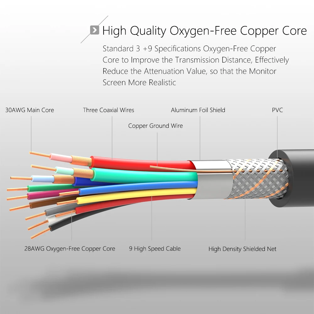

are there any ferrite beads (also known as ferrite rings or ferrite chokes) on your vga cable? if there is not, you should switch to a vga cable which has those on it, one on each end would be best but otherwise you want a ferrite bead just before the the video cable goes into your tv
https://en.wikipedia.org/wiki/Ferrite_bead
make sure the video cable is high quality shielded (meaning all the wires inside the cable are covered by an outer shield, such as a braid shield (plus a foil shield for extra protection is a good idea), and that shielding should be connected to ground so any interference trying to get in is dealt with properly (killed)).  for even higher quality cables you will find that some of the wires inside the cable such as the R, G, and B wires, are also individually shielded from each other/the other wires in the cable
https://ae01.alicdn.com/kf/HTB1S_lcRFXXXXa2XXXXq6xXFXXX5/SAMZHE-1080P-VGA-Cable-Aluminium-foil-braid-Gold-plated-Connector-1-5m-2m-3m-5m-10m.jpg
apart from that a little test you can do is if possible see if the interference changes depending on how close the pc is to your tv
another test is to try the tv plugged into one of your wall sockets in the house and the pc in a different wall socket of the house, so they are not sharing the same eg. 4-way power extension lead (you could use a long power extension lead to have either the tv or pc plugged into a mains socket in another room)

Hey,
I checked my VGA to SCART cable, which I bought from https://www.arcadexpress.com/ and it has zero shielding : no ferrite beads and just a black PVC casing. So I thought "great, I found the culprit !" and I was ready to make a better cable, but I wanted to confirm this first. So I got my old PS1 and plugged it in using a very high quality official RGB cable (which has a ferrite bead on both ends and very thick shielding) and unfortunately the exact same problems could be seen on the image :(
I even tried to plug the TV directly into a wall socket and in another part of the house, with no other electric equipment close to it : no change at all.
So these experiments pretty much confirm that the problem comes from the TV itself...
