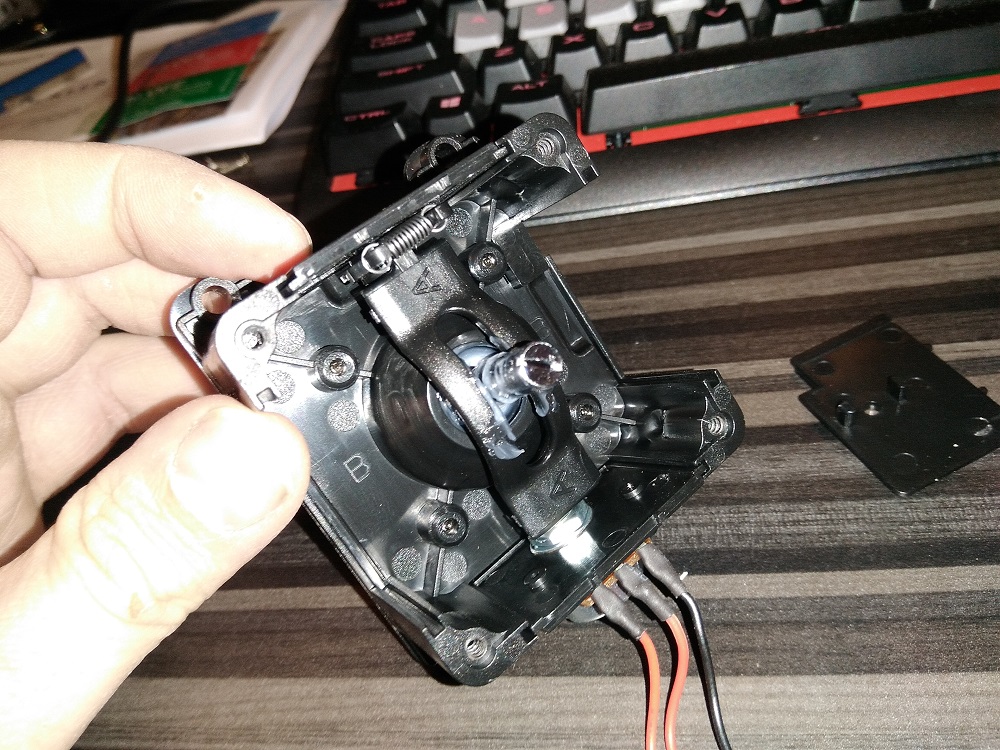

Took it apart.  Will attach pic. The springs are small but easily replaceable if they dont hold up over time.

 It seems the Return to Center spring system is not very robust.
 However, its not a dealbreaker.   The shaft is long enough,  that you devise a better center return system.

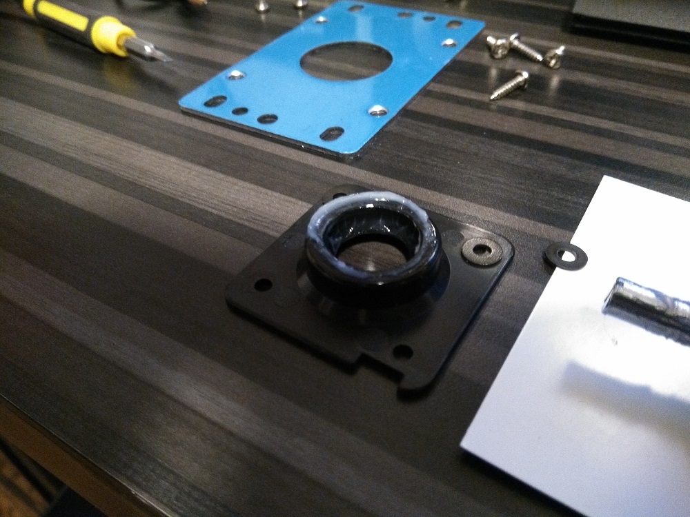

Mounting plate is slightly wider then a Sanwa JLF plate.  Mounting holes are the same....mostly.  The center and corner holes are the same, but the other two are backwards.  The Quimat/SJ@JX plate is a mirror image, not identical.  It's like the countersink for the mounting screws were drilled on the wrong side.  The mounting pattern that holds the plate to the plastic joystick body is completely different, so "S plates" for JLFs will not work on these.
I orderd from Quimat, but my joystick says SJ@JX.  Seems to be another seller account on Amazon.
The little peg above the logo is the end of the guide for an axis.  Bothers me a little bit that it's so small, but all the real abuse should be handled by the ball and socket.
Pots have no markings.  They look like cheap pots to me, but who knows.  They are 4.4k Ohm (and some change).  They are limited deflection which means they cover their entire range over the throw of the joystick (which is good).  Center measured around 3k, but I was able to adjust it to 2.2k by  loosening the adjustment screw and moving the adjustment bracket.  The screw didn't feel like it had much bite going back in, so this isn't something you want to do more than once.
The wiring threw me at first because they used yellow for 5v (assumed 5v) and then switched to red to jumper it over to the other pot.  It appears to be set up as a standard voltage divider.  Power, ground, wiper, to each pot.
« Last Edit: December 08, 2018, 08:51:21 pm by BadMouth »
  • Posts: 9286
  • Last login:December 19, 2025, 12:23:29 pm
Re: Quimat analog arcade stick and controller $20?
« Reply #11 on: December 08, 2018, 08:16:11 pm »

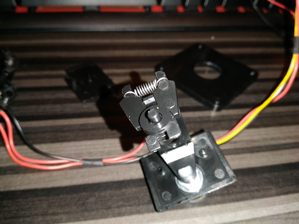

Pivot point is a ball and socket.  Pots are actuated by a guide for each axis.
Notice that the side panels are slotted.  They slide out for disassembly.

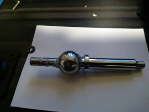

Here's that little post.  It wouldn't have hurt to put some superlube on there while it was apart, but I was too lazy to run down to the workshop and get it.
The joystick shaft is either one piece or the ball is press fit.  I didn't clean off all the lube to find out.
It is captured between the joystick body and a top piece that's screwed down.  I thought it was interesting that there were washers in between, like maybe it was too tight of a fit and they had to add spacers.
I'm also curious as to why there is a notch cut out.  Perhaps it's for wiring for a trigger stick to pass through.
Thoughts:
Since it's working as a voltage divider, it should work with xbox360 pad hacks (although I am not guaranteeing it since the pots are 4.4k instead of 10k).  I don't feel like hacking a pad to find out yet.
It will definitely need the center of the pots adjusted.  Even if not hacking pots, it wouldn't hurt to adjust the center to 2.2k for the sake of having the same range in both directions.
Movement feels pretty good.  It's subtle, but you do feel more resistance when moving diagonally than in primary directions because you are pushing against two springs instead of one.  It's subtle and most people probably wouldn't notice, but it is there.  Happ got around this by having one single huge centering spring underneath the joystick body.  While the happ feels the same in all directions, it does a lousy job of actually recentering.  It doesn't bother me enough to keep them out of my cab.  (the fact that there isn't enough joystick shaft protruding underneath to add rotary might stop me, but the feel of the joystick movement won't).
One upside is no clicking switches.  I have optical switches in my cab, so I'd forgotten how loud the JLFs are until I dug one out of the spare parts bin to compare mounting plates.  Definitely a positive there.
Overall it doesn't appear to be arcade duty,  but it was friggin' $23....with an analog encoder...and eleven buttons....and wiring!  For trying to hack arcade controls into analog gamepads, it's probably as good as it gets for less than $300.  How long they will last is still up in the air.  They are more hefty than the little Alps sticks I've used in the past.  They also don't have the crazy long throw of those.
