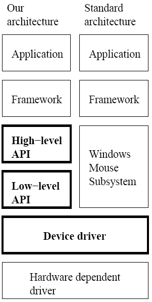

Here's an image taken out of the pdf document describing cpnmouse, if that helps to confuse you any:  ;D
But will it solve much over the current seperate solutions?  Other then getting it to one code base for both?
Ehhh, no not really - just the fact that there could be consistent support for nearly all versions of Windows.  Also, I sort of believe that having choices is a good thing.  If somebody has trouble getting one method to work, having a second method to try could be a good thing.  I know, that's not really the Windows Way, and for good reason - it makes things more complicated.  That's where I'm wondering if this solution is a good thing or not.  I'd love hear opinions on the matter.

I have gotten a response from the author:
> Is there any problem for people who normally have to
> use a specific mouse driver?
There shuold be no problems, as the normal mouse driver is still loaded, CPNMouse just loads above it in the driver stack, and filters out unwanted events.
When a completely new bus for mice appears, a new .inf file will have to be developed, but that should be all.
