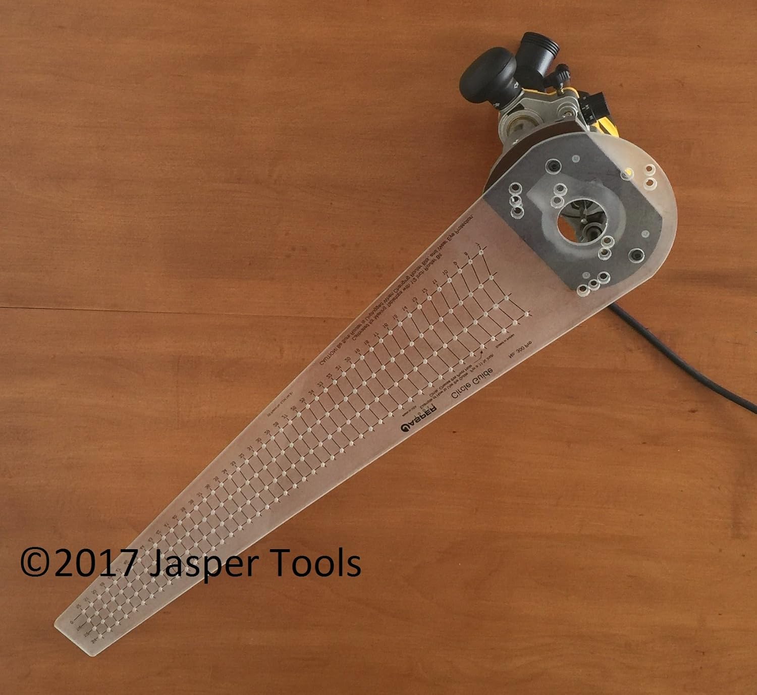

You can also make a DIY circle-cutting base for your full-sized router from hardboard or 1/4" plywood.

I've got a router but I'm tryin to cut a
4" radius inside curve along with a couple half inch radius outside curves.
I feel like the router is just to big, even with a jig. Might try the dremel withth shallow repeated shallow passes and a 561 bit.

Yeah, 1/2" curves are pretty small for a full-size router.
A 561 bit should work, but it might be a bit long.
I used a 115 bit for the U-Trak, but a 194 or 196 would also work well and make less dust.
