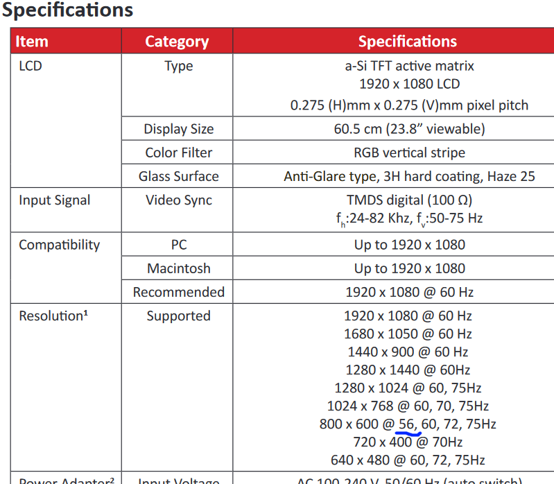

So if you 'go custom' with your LCD, what's a sure way to learn about all the modes it can really run at and that GM could successfully use ?
(edit: I mean as they are the nVidia and AMD control panels aren't exactly helpful, the other day I've set 1920x1080@58 on my R7 completely at random since I couldn't find all modes listed anywhere.
It seemed to accept and save it, yet apparently Win 7 Pro didn't, and my monitor still reported 60Hz, which GM followed but I wasn't on 'custom' anyway...quite puzzling still regarding W7)
Then when you know only a single crt_range line edited will suffice ?
« Last Edit: July 31, 2018, 04:41:02 pm by schmerzkaufen »

I haven't had the same luck so far, I'm still trying to figure how this can work for me.
Right now only using a 60Hz full-hd monitor, I've set three custom resolutions in the AMD control panel; 1920x1080@60, 1920x1080@58, 1920x1080@55 ...
The strange thing is that none of the off-60Hz seem to actually work, that is when selected the desktop is still running normally @60, this is what my monitor detects as well.
I suspect the AMD custom resolutions tool might be completely useless in that it must be reverting or converting back to 60 without telling you, dunno exactly what's going on.
Anyway I was wondering if maybe that would work only while an application is running in exclusive fullscreen, of course my goal being GM I've tried setting it like this;
Code: [Select]
# CORE SWITCHRES OPTIONS
modeline_generation       0
monitor                   custom
orientation               horizontal
connector                 auto
interlace                 1
doublescan                1
super_width               2560
changeres                 1
powerstrip                0
lock_system_modes         1
lock_unsupported_modes    1
refresh_dont_care         0
dotclock_min              0
sync_refresh_tolerance    2
frame_delay               0
vsync_offset              0
black_frame_insertion     0
modeline                  auto
ps_timing                 auto
lcd_range                 auto
crt_range0                49-61
Which of course will not work  :D
Guess I need to enter the full modeline but I don't know what to do from this point, I'm lost.

The thing with fixed refresh LCDs is they actually do support a certain *range*. E.g. a fixed 60 Hz LCD needs to be able to sync to at least a narrow range of refresh values around 60 Hz. This is because video cards never provide a perfect match for 60 Hz. So if monitors required exact 60 Hz they would be out of sync in 99% of cases. So the matter is, how narrow or wide this range is.
Yesterday doing some tests I've found that my current Dell can sync between 58.5 and 60.60 Hz. This covers many arcade systems.
It's super important not mistaking what refresh a monitor can accept and what it can actually sync to. My monitor accepts from 50 to 75(??)Hz but that doesn't mean it's synchronizing to those frequencies. You know when it's actually synchronizing because scrolling is perfectly smooth. Otherwise you'll notice the scroll stutters.
So you may find in your monitor specifications that it accepts 50-75 Hz as input but probably it will probably only sync to a small window within that range, or several small windows, that is never documented and you need to find it out yourself. Then of course if you're lucky enough it's possible that the monitor's board can sync to the whole range.

I'm connected using a DVI>HDMI cable because that's what I had under the arm, but I can use a normal HDMI one too if you want.
(Full-HD monitors never have DVI inputs btw)
I've asked the question of connectivity earlier because I thought it might count.
Using arcade osd I was indeed able to edit and save, only set the cyan mode to progressive and it worked (but i didn't touch the timing values)
EDIT: for the EDID: assume all Full-HD monitors and TVs are practically the same, flat panel displays definitely don't behave the same depending on their category, remember 1200p ones are a very small niche and definitely differ in terms of internals and standards.
BTW I think 4K monitors and TVs are of the same 'breed' as the Full-HD, afaik, they're consumer products expected to be used with consoles, broadcast, BR players etc
EDIT: after another restart for changing to HDMI>HDMI, went back to arcade osd and the cyan mode I had previously changed to progressive, went back to interlaced.
« Last Edit: August 09, 2018, 05:26:24 am by schmerzkaufen »
Calamity
  • Moderator
  • Posts: 7475
  • Last login:Yesterday at 05:13:44 pm
  • Quote me with care
Re: Clarification on using GroovyMAME on a LCD
« Reply #52 on: August 09, 2018, 05:28:39 am »
I'm using dual link DVI here because at the time this monitor was made it was the only connection to admit the required bandwidth. It shouldn't matter, I'm just trying to figure out the issue.
The fact that the AMD panel was able to insert the modes makes me wonder if the issue could be in VMMaker itself. I believe VMMaker uses the same mechanism as AMD panel to create new modes (I'm just using the AMD api). The difference could be AMD is using the vesa gtf/cvt standard while I'm trying to push the modes as custom.

I have attached a summary of top 25 refresh rates (resolution is irrelevant to you since you're using a fixed display).
The whole point of GroovyMAME is that, within the limits of your display, you can hit all those native refresh rates (and resolutions, for CRT) by simply feeding GroovyMAME the bandwidth limits of your monitor. One line of text (monitor specifications) versus creating hundreds of modelines by hand.

Thanks for helping me with the configuration, but sadly it is still not working
I installed the official 18.5.1 package and replaced the driver.
Under monitor settings I disabled freesync and I also made a custom profile for mame and disabled freesync there. The games still have speedup for me.
Maybe the control panel settings don't work? I'm on windows 7 btw.
Refreshrate switching itself seems perfectly fine, when looking at the log and machine information ingame.
Even when bfi is not enabled. The game has no framelimit at all and just goes max speed for me.
Is there anything else I can try to debug this?

If you can get your hands on a ViewSonic the chances are good with that manufacturer, I use one myself (check my signature).
There is a hint, if you download a ViewSonic model's user guide .pdf (not the comparison sheet or datasheet, use their downloads search engine or check their global site), then scroll down to the specifications and in the list of supported resolutions you see that uncommon 56Hz listed, then it probably means that it is a model similar to mine: compatible with any native refresh you throw at it and therefore fully supporting GroovyMAME whether using the dynamic or static method.
In regards to other brands, sorry IDK, my only other one compatible is a Maxdata/Belinea from 2007.
People will find that buying a G-Sync or FreeSync monitor to go with their GPU is much easier, of course.
But since some much cheaper monitors might support non-60Hz then naturally Groovy expands our choices and can save money.

Ok my daddy's LCD, a Samsung Syncmaster 930BF has that 56hz!
Please do not misunderstand, it doesn't have to be 56Hz, and I simply gave you the only example I know of a hint that ViewSonic monitors might be compatible with non-60Hz refreshes.
If whatever monitor from any other name brand has non-60Hz modes listed in the specs then yes, they might be like the ViewSonics, but again this is only a vague clue, not a solid indication.
