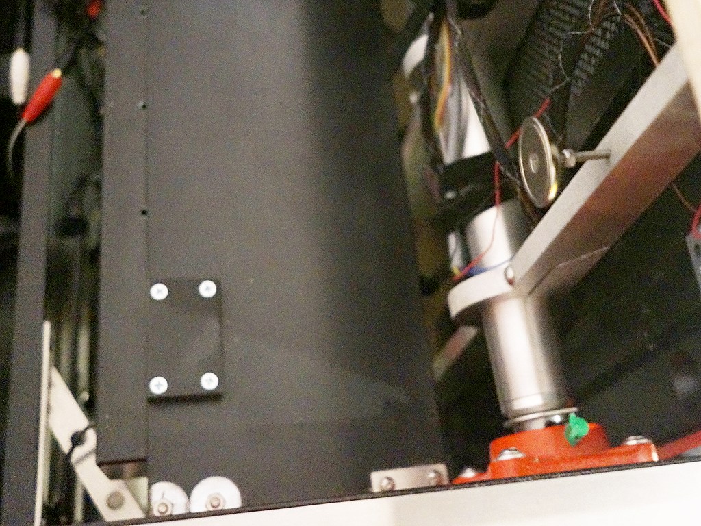

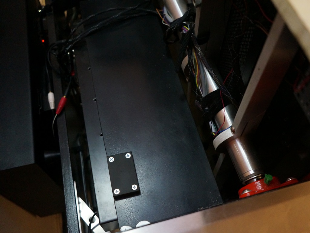

I've made some progress toward the side skirts.
First, I tapped the holes in the ends of the counterweight adjustment rail.
I was very careful when I mounted this rail, such that it is well centered and straight underneath the monitor... which of course makes it crooked on most of the rotating assembly it attaches to, due to all the 3' angles.  But, the important thing here is that each end of the rail is about 0.060" short of being flush with the sides of the playfield display.
This means that when I make 0.060" thick aluminum plates that pick up these two screws on each side and mount them,
the outside faces of the aluminum are precisely flush with the outside edges of the playfield display.  These will form half of my mounting brackets for the cosmetic side skirts.  The skirts will carry the pinball flipper buttons and some of the force feedback elements.
There will be 4 mounting screws per bracket, going out from the inside, through holes in these brackets into thread inserts into the 7/16" plywood skirts.  You can see centerpunch marks in the bracket where these screws will land.
Here's the initial layout for the side skirts.
You can see all the nudging around and remeasuring I did for the flipper button location prior to drilling it out.  These skirts are 4 3/4" high, about 41" long, and form a 6' parallelogram, with the incline of the table going to vertical ends to clear the front and back cabinet during rotation.  I've found the machinist angle blocks you can see by the pencil to be extremely handy for doing this kind of layout, that's a 4' and 2' stacked to make a reference 6' wedge.
I drilled the bracket holes, cut the skirts out, then carefully held the skirts exactly where I want them to land and transferred the four mount holes.  Took the brackets off, and transferred the center holes as well, because I don't have the ability to countersink these bracket screws completely, so there's going to be relief cuts in the skirts to clear the screwheads you saw holding the brackets on above.
Shapeshifter shouldn't have hardware showing on the outside of the skirts.  I am adamant about this.  The mounting screws are going to have the heads inside under the playfield, and be blind, into thread inserts that are also blind.  So, I drilled blind holes with the depth stop on my drill press.  Here's the side skirt, held up to a bright light behind it.
Thin, but it'll hold primer and paint.   :D
I ended up having to go to 6-32 hardware to get the thread inserts to be short enough not to blow through 7/16 plywood.
They are pretty small, but there will be 8 of them holding each skirt, and any impact loading from whacking the flipper buttons is going into the brackets, not out or side-loading.  I am confident these will be fine.
I sunk the thread inserts VERY CAREFULLY from the back side, got them just slightly below flush, and didn't have any protrusion on the user facing side.  Success!
Here's the mockup of what the skirts look like, installed.  The 1" aluminum angle set on top is just sitting there to give an idea of what this is going to look like, it still needs to be trimmed to angle and length.  Imagine that this bare plywood was the same bright red as the front and rear cabinets; that's going to be my last big painting job.
Currently, the skirts are only held on by the four screws in the rear brackets - I still have some fabrication to do to make the front brackets and anchors.

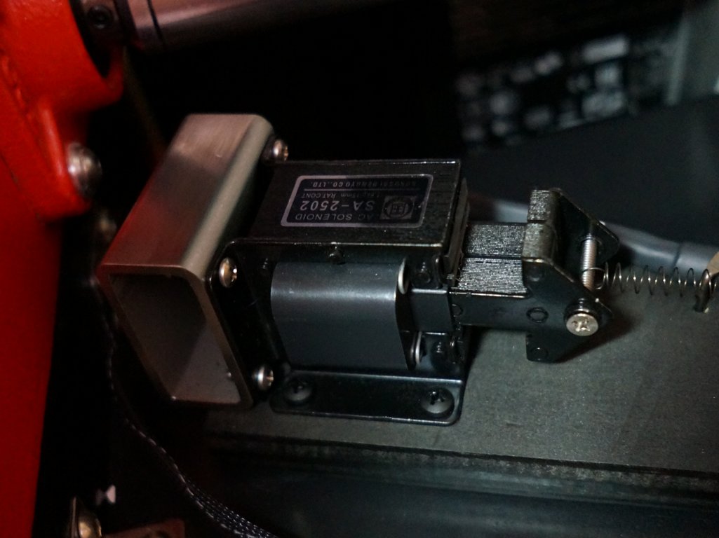

Spent a while working on one of the virtual pinball toys.  There is traditionally a loud knocker that fires when you win a free game.  This is often a solenoid whacking the inside of the plywood cabinet directly, using the whole cabinet as a giant sounding box - but I don't exactly have a solid box cabinet like a traditional pinball machine does, so I improvised a bit.
I found a relatively powerful 120vac solenoid, and mounted it to a small wooden subframe.  Cut a chunk of thick-wall stainless steel rectangular tube, bored a hole in one side of it for the solenoid striker to reach through the tube and strike the far side wall of.  Drilled it, tapped it, and screwed it tight to the face of the solenoid.  Mounted a very light spring to a cross pin on the moving plunger in tension to reset it.
Here's the result.
When the coil is charged from a very brief (10 millisecond) shot of 120v across a relay, the |-|> shape at the right of the solenoid tries to become ||>, but just slightly before the plates touch, the plunger inside strikes the far end of the stainless tubing with a good loud crack.  Then the spring pulls it back into this resting configuration.
This lives on the midshelf up near the rear cabinet.  Of course, when I went to test it, I then couldn't win a free game to save my life.   ::)
(Eventually managed to.  It works great.)

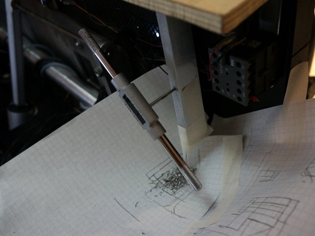

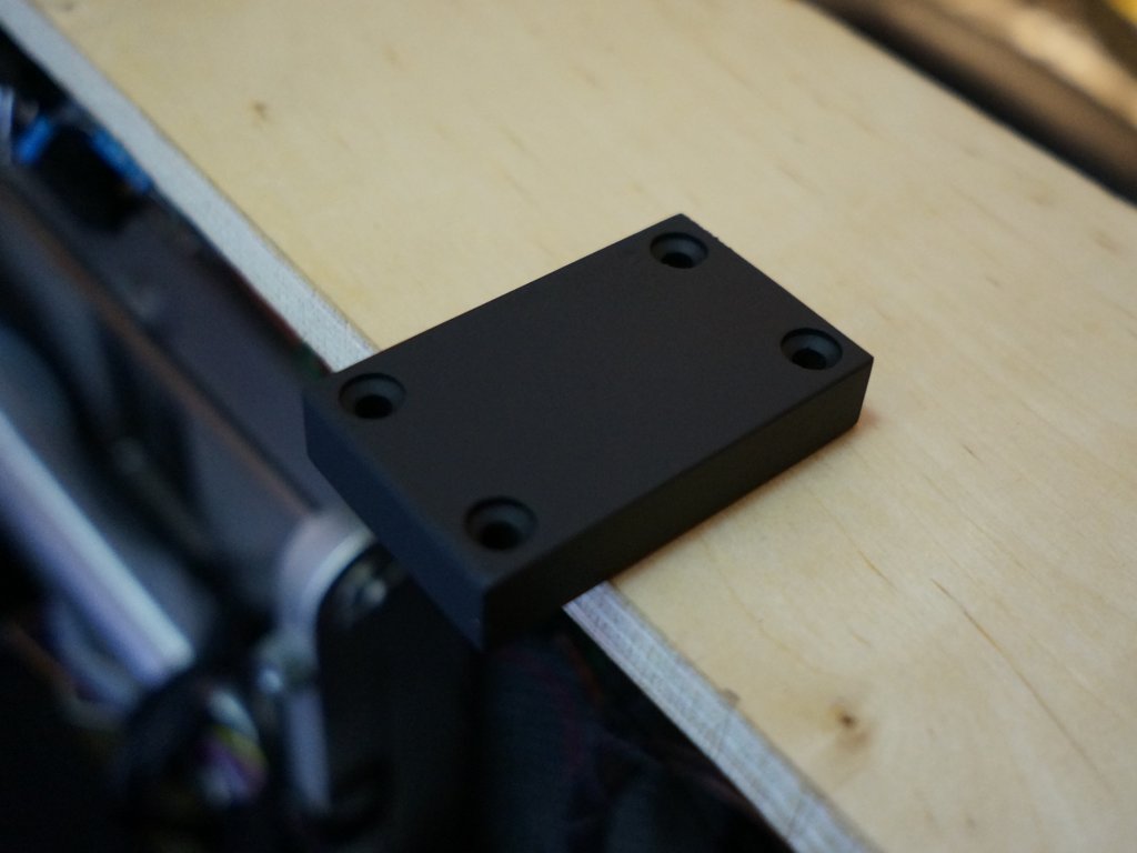

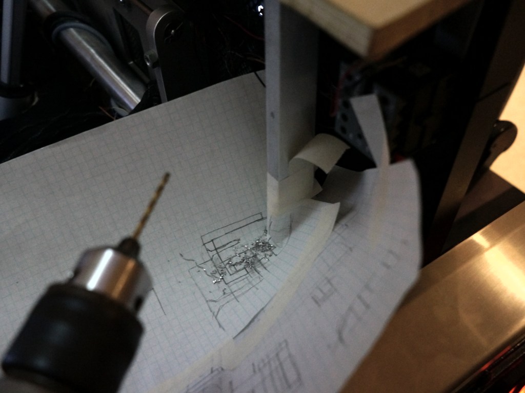

First up, a block of steel.  Mild steel this time, not stainless.  I hate having anything on Shapeshifter that can rust, so this is a steel block under about four layers of rustoleum flat black.  Four countersunk screw holes in the corners for mounting.
This gets screwed down to the top of the midshelf, right behind the front cabinet.  This is the view looking down just behind the lockdown bar, from the pinball player position, with the playfield monitor up in vertical driving mode.  Four screws clamp this block down.
This block will be one side of a strong magnetic latch.  I can only do this on the left side, where the playfield rotates away from it, because the right side has to swing through anything below it.  This is going to catch the giant aluminum bracket you see on the right, which also mounts the fronts of the skirts.  I've drawn a dot on this bracket where the magnet should mount to hit the middle of this steel block.
I'm doing all work from here on without disassembling the machine, so setting the magnet end requires drilling aluminum in situ.

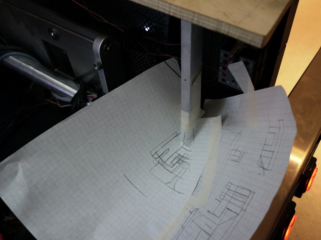

I took some now-no-longer-needed engineering drawings from making other parts of the machine, and masking taped them up to form a dam to keep aluminum shavings out of the rest of the electronics.
Used a hand drill with a number 36 bit in it, to laboriously peck drill a 1.25" deep hole into the bracket.
This took me a long time.  If you're playing the home game and building along, you should measure this out and do it in a drill press before you mount the whole thing together.  Me, I did it over the course of about 45 minutes wishing I could be using my drill press.
Once it's drilled to depth, then I tapped it 6-32.
Pro tip:  Don't break off a tap in the assembled machine.
Wisely, I didn't break off a tap in the assembled machine.
This gets a 95-pound-rated cup magnet on a countersunk 6-32 screw with a lock washer and a nut to pin the magnet hard against the countersink, then a reversed nylock nut to act as a jam nut up against the aluminum threaded bracket, then about an inch of 6-32 threads to be nice and strong in the bracket.

We're getting into the home stretch now.  I got the red paint on the side skirts to a point where I'm content with it.
Then, I marked up that aluminum angle that I'm making fake side rails out of, and got the exact dimensions transferred from the side skirt onto it.  Trimmed it roughly to length with the bandsaw, then milled the exact 6' matching face that makes up for my inclined playfield.
I set up a stack of angle blocks on the vise to equal 6', then just pushed the aluminum angle against that when I grabbed it in the machining vise, like so:
The side skirts are basically a parallelogram, mostly, less some clipped corners to make room for rotation.  The 6' angles align nicely, here's the resulting fit:
I put a little carbide burr in my dremel and just went to town roughing up the inside surfaces of the angle.  (For those of you who get the Joy Division reference in my resulting pattern, bravo!)
This, I figure, should give the construction adhesive something to hang on to.
I filled it with glue, and clamped it together.
While the glue was setting, I applied some clear mylar pinball flipper button protectors under the buttons.  They show a little, when the light is just right, but I figure they'll slow down me wearing through the paint in this area over the years to come.  Here's as much as I can make them show in reflected light.
Finally, when the glue dried, it was time to reassemble everything.
It now looks done.  It isn't done, but it looks done.
Now you can see my starting design idea.  I wanted the BRIGHT BRIGHT RED to trick the eye into visually completing the shape of a pinball cabinet over all the weird stuff that lives tucked in underneath that.  I think it works - you wouldn't ever mistake it for a real pinball table, but it clearly indicates what I was going for with all of this.  The illusion would work better if the skirts could be taller, but this is the absolute upper limit that still clears the internals when it rotates.
It may not be authentic, but I think it's cool - and that's the next best thing.
Still to do:  Build limit switch brackets and wire them, so that the machine can tell what configuration it's in, and so that I can script the full transform sequence safely.  I'm going to program it with both timeouts and expected results - it'll try to push the table out for, say, 4 seconds, and if it does NOT see the limit switch trip indicating that the control panel is fully extended, then it'll halt and throw an error on the DMD, instead of blindly spinning the table into a physical crash.
I'm going to wire these up in a neat way.  I'm using keystrokes on the Ultimate I/O board, and obviously holding keys for the limit switches ALL THE TIME would raise all kinds of trouble while booting the machine with "stuck keys" and in all other games and so on.  How to work around that?  Well, the UI/O detects switch inputs based on the input pin going to ground.  All your switches normally have a common ground, and when the switch is on, that's grounding the corresponding input.  The UI/O lighting controller works on a common +5v rail and switches grounds to light the LEDs.  This means if you wire the limit switches to a lighting controller pin and the input signal pin, instead of common ground and the input signal pin, then the switches are effectively enabled by turning that light on.    Light off = lighting pin floating = closing switch contacts leaves the input signal pins floating.   Light on = lighting pin grounded = closing switch contacts grounds the input signal pins.  So that one lighting controller pin becomes "Switches Active Enable", I can do that in my front end software whenever I need to know what their status is, and I can leave it off during boot, while playing games, or any other time that those keys being depressed continuously would cause problems.  Cute, eh?
Additional funny detail:  It turns out that if the throttle is all the way forward, it leans forward toward the screen enough that it could crash the rotating playfield as it swings by.  But, I can read the throttle's position in my software!  So I'm just going to write another check there, such that when you select the other game mode, if the throttle is too far forward, it prompts you with a big flashing "THROTTLE DOWN TO INITIATE TRANSFORMATION" message, and then delays until you comply into the safe area of throttle travel.
I'll have fun with the graphics for that.  I also thought of another randomly selected transform noise it should make - the Robotech/Macross VF-1 Valkyrie transform noise should be in the pool as well.  (grin)
