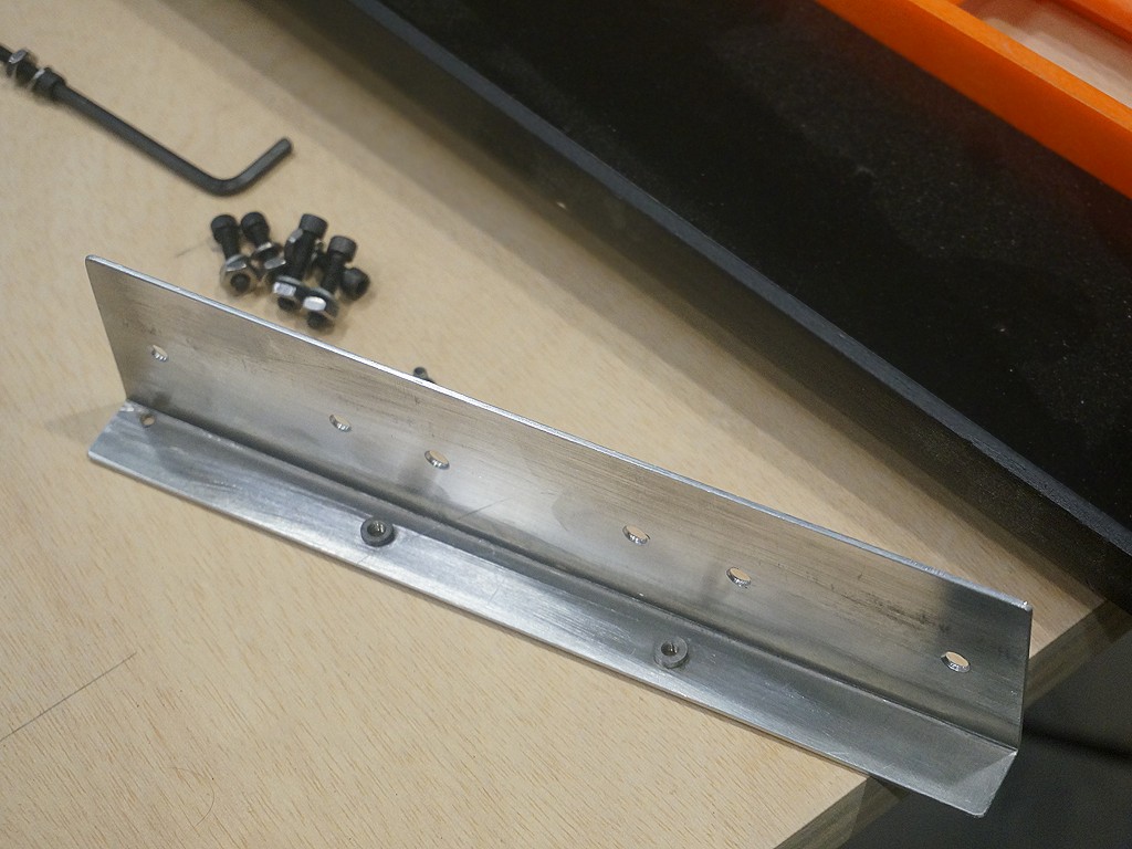

As of the current design, the chair base I made in the posts above is going to run on wheels on carpet.  The wheels will be spring loaded, lifting the skirts of the seat base just above the top of the carpet so it rolls, but lightly sprung such that he weight of a person sitting in the chair drops the skirts to the ground and those then take most of the weight so it becomes stable.  (Kind of like those rolling stepstools you used to see in libraries.)
I'm going to use the rear axle as one of the springs.  It is 8mm diameter surface hardened stainless shaft.  I figure it deflecting about half an inch over a foot of run shouldn't make it take a permanent set, and feels like it's about the right stiffness as a spring to do what I want.
I need a strong mount that attaches this axle to the center of the rear wall, offset by slightly more than the radius of the wheels, because the wheels are going to run inside the box and I want them not to quite hit the rear wall.  The wheels I liked best of about the right size turned out to be replacement wheels intended for those kick scooters - $9 with all bearings per pair of wheels, and they look nice.
I rummaged around my shop and found a block of aluminum.  Laid out the shape of the mount I have in mind on it with a pencil, and grabbed it in the mill.
The milling machine makes a really rigid drill press.  The working space is tight, so I still use my drill press most of the time - but if you have a small part you want *precise*, this is a good way to do it.  I wanted this axle hole to be VERY perpendicular to the faces, so that an almost two foot axle would have the right gaps between the wheels and the back skirt wall way out on the ends.  With the big face of the block flat on the machining vise, and the mill trammed and square, this hole should be dead on.
I drilled it out, and did a test assembly on my work table.
Aaaand it's wrong.  One of the wheels rubs on the table.
 :angry:
The hole is square to the face, alright.  But the bottom edge of the block wasn't actually square, and that makes the block lean.  If I squared the bottom of the block, it'd be squared to the low side, and it'd be too short.  I could make a spacer to shim it out, but... I'm all of five minutes into this part, let's start over.
Back to the drawing board.  Dykem layout fluid, scribe some lines, rotate the part 90' and give myself more room to square up the block later....
Tweaked the design a little to just miss that first hole, drilled the new axle hole, and life is good, this will work.
The clearance above the axle will be tight to fit under the brake pedal, so the bulk of the clamp is toward the bottom.  Two screws in the front (left edge) will bridge across the slit cut and squeeze the gap shut against the axle, which should make it lock up tight.  Flange on the right, for screwing it to the plywood of the back wall.
To my beloved little bandsaw it goes, to rough it out:
You might think 1.25" thick aluminum billet would be hard to saw.  Sure, with a hacksaw it would be.  But not with this.
I roughed it out with a little gap to the line, because I plan to mill it for fancy appearance.
Milled to contour, and with the front holes drilled, it does indeed look kind of fancy.
These holes in the front are 2" deep, and tapped 10/24 on the far side of the clamping slot.
I couldn't reach deep enough to tap the bottom of the hole, though, reaching through the front of the clamp to do it.  So, I was forced to shorten the cap screws a little bit; they still have a good inch and a half of aluminum threads, so they'll hold fine.
Shortening screws on the knife grinder is just fun.
Best done in short bursts with a water dip between so you don't screw up the heat treatment, but still, it's a sparkler.  It sparks joy, okay?
Here's the complete rear axle assembly sitting on a table.
When attached to the back wall of the plywood box through to-be-drilled holes in the flange, this will hold the axle and take in side load the weight of the human sitting in it, as the axle bows up, until the skirts hit the ground.  Takes maybe 30lb to do that, I think.
The front wheels can't work this way, though, because they need to straddle the pedal frame.  They are next.

I made some mounting plates that hold one LED module each, and extend several inches beyond them toward the centerline, fished them into place inside the extremely narrow front cabinet, and ran a screw up through the floor into each one.  You can remove the screw and remove the LED if you need the originally intended access to the leg bolts, but now if you lay on your back under the front cabinet and look straight up, you'll see this by each front leg:
(You can also see from this view that there's no floor to the VR button panel... but that might be how it ends up - I mean, who's really going to be looking at the machine from this angle?  This is the same logic that keeps me from feeling any need to diffuse these strobe LEDs.)

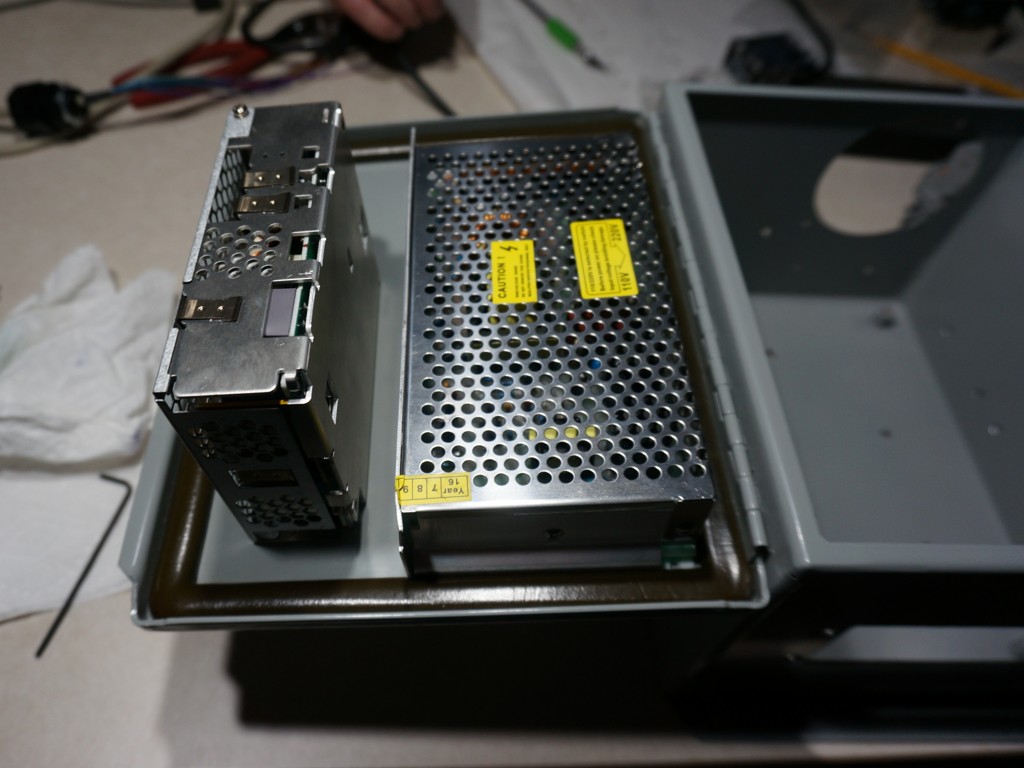

This weekend was about the power control box.  It's been pictured in a few prior updates; it lives on the floor behind the driving pedals, underneath the pushed in chair, in front of the back wall.
When I first proposed this project, rablack97 voiced a concern that there'd be insufficient volume to accommodate the parts and wiring necessary for a good vpin because of the design.  This box is one of the places those guts live.
First, I had to cut and drill a lot of holes in the steel box.
(Then I had to remove a whole lot of conductive steel shavings and swarf, because that's not something I want floating around in here.)
My dad gets the credit for the creative use of space that follows...
A 12v power supply mounts flat on the lid.  A 24v power supply mounts -edgewise- on the lid.
The 12v will be running the 9 amp (max) table rotating actuator,  the 9 amp (max) control panel sliding actuator, and the intake fan.
The 24v will be running the flipper contactors, the slingshot contactors, and the bumpers.

To help mount those, I fabricated a neat little bracket out of sheet aluminum.
Cut out a rectangle of .060 aluminum, folded it to 90' on my little 12" finger brake, drilled it, and pushed in some pem nut thread inserts.
This thing mounts 6 solid state relays back to back, and acts as a heat spreader for them - here's a test fit of the four on the ends.
That's not enough relays, though, so some get mounted to the walls, too.  Here's the DIN rail, with terminal blocks and three more relays, and four solid state relays mounted to the back and left walls.  On the left wall, an 80mm intake fan, which will blow out through the rectangular duct I showed in my last update out through the back wall.  In the center of the box is the two holes for the aluminum bracket shown above.
When the solid state relay bracket goes into those holes, it all looks like this:
The tall 24v power supply swings in over the aluminum bracket full of six solid state relays, with about a half inch of clearance, which is half the wind tunnel going from the intake fan out the back of the box.  The flat 12v power supply swings in over the top of the DIN rail, with about 3/4ths of an inch of clearance, forming the other half of that air channel.
This is most all the mounting that needs to go on to make the power control box mechanically complete.  It is likely to get disassembled again for wiring, of course, because getting into these spaces to wire it would be needlessly tricky.
As oriented from the pinball player's perspective,  the front wall of the box has the 120v power, fuse, and a connector out to the playfield.  The back wall of the box has the DB25 signal cable to the backbox, and connectors for 1) the control panel stowing actuator, 2) the playfield rotation actuator, 3) the replay knocker, and 4) the various limit switches that will confirm to the PC whether the TV is horizontal or vertical, and whether the control panel is stowed or retracted.
