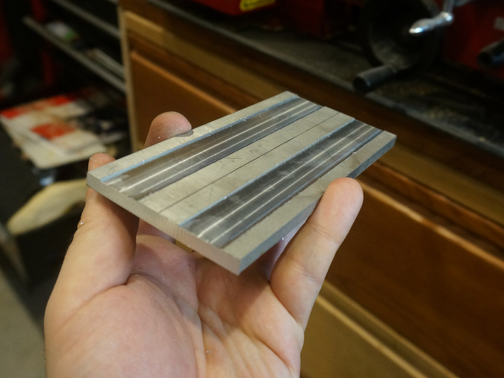

Next, I started making the side plates.
I used one big chunk of 1/4" aluminum plate to start, and milled two channels into it.
This produces a piece like so:

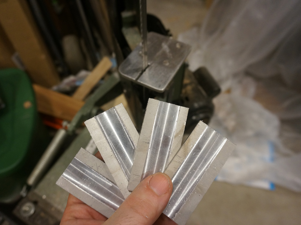

This big sheet contains all four of my side plates - I cut this plate into quarters on the bandsaw to liberate them from one another.
(Step right up!  Pick a sideplate, any sideplate!)
This completes the rough "build a clamp anchor" kit - 2 cores, 4 sideplates, and 4 1/4-20 clamping screws long enough to reach through the stack with nuts.

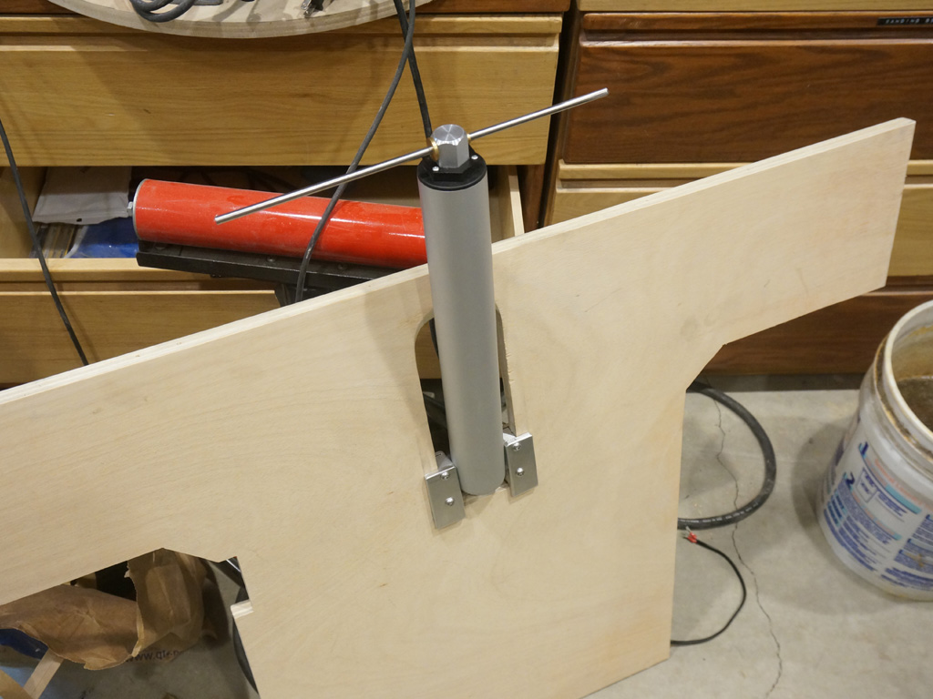

I drilled and tapped the angled faces crooked, tapped one side hole, threaded one end of a stainless axle, and assembled it with the actuator so that you can see the goal of all this:
This is the lowest position the actuator could be in, it almost hits the bottom of the plywood slot.  You can slide this clamp up from here and bolt it down anywhere along the slot.  The actuator body just fits between the clamps.  The axle is crooked 3', closer to us on the left, further from us on the right, but level in the slot.  The slot itself is crooked 3' in the plywood, counterclockwise from what would be "true" in this view.  Those two angles form the same compound 3' x 3' that the TV axle is on, so the actuator should run nicely perpendicular between parallel axles - this one on the back wall, and the other being that rod you've seen on the TV tray mount.
I slipped a spare piece of the 1/4" upper op rod through the actuator, to help illustrate.
There's the actuator with all my custom hardware on both ends.
From here I still need to mount the back wall (removably) into the machine, and build the counterweight arm for the playfield TV, but after those two big projects are done, it'll be time to test motorized transformation and that will hopefully be fun.

Once its all done - will you screw the clamps through the plywood?  I would think the plywood would compress over time and they may become loose.
Hah, yes.  Good thinking, there's room in the flanges for that.  I think they have more tightening throw than plywood has available compression - but one screw per side would nail them in place once I've got them tuned in to exactly the right place.
