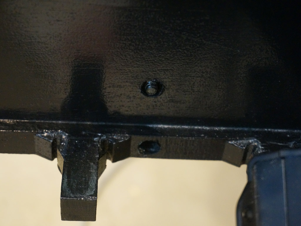

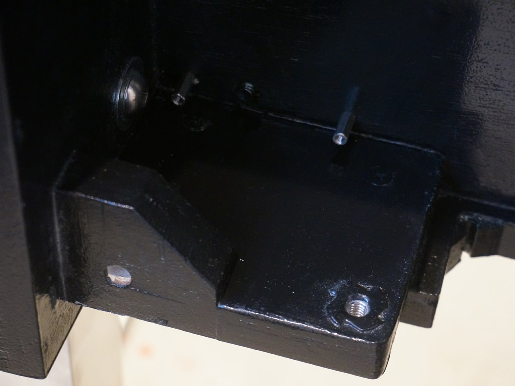

I'm about two thirds through the whole paint process I think.  I've test-assembled the back cabinet together to check that it fits once painted (it didn't, had to fix that).
The playfield table, in pinball mode, will be flush with the top of the lower fat red stripe.  In driving mode, the top of the main screen will be about halfway up the backbox, and the bottom edge will be just above the bottom of this cabinet.
I really like the way the black neck separating the pinball table from the backbox is turning out.  When you get the angle right, that it starts reflecting the red paint on the edge -
This neck under the backbox is not exactly an accurate pinball reproduction feature, but I think it's cool in lieu of the backbox being hinged.  It's my sci-fi futurist take on a pinball machine, anyway.
I've got the front cabinet ready to populate, and work is currently underway on that.

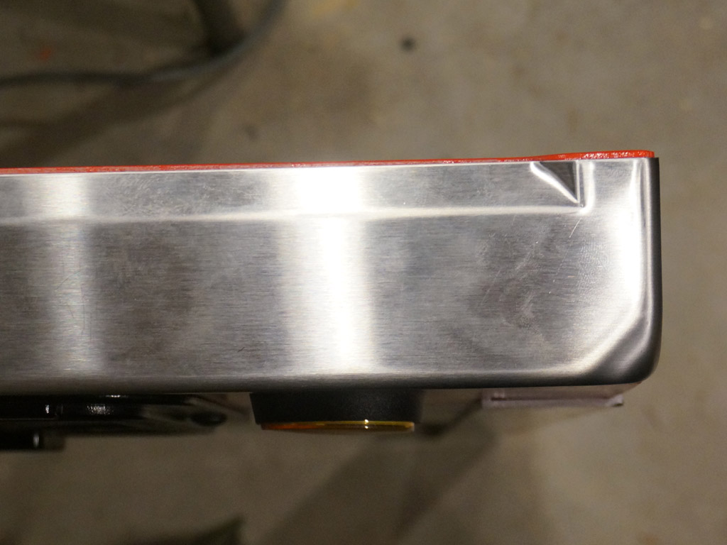

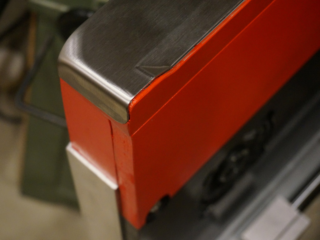

I haven't yet built a fascia to cover all this - I'm thinking about a thin waterjet cut acrylic gloss black bezel type panel, with holes for the screens and speakers, to tie the back box contents all together visually.
I'm planning to do the wiring next, with a goal of getting back to a working mockup with the playfield temporarily on a table between these two end cabinets.
Making it live again at that next level of incremental approximation should be encouraging.

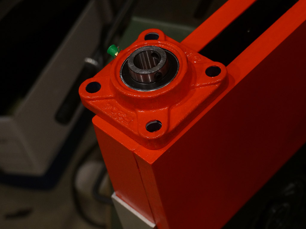

All up, here's the filled cabinet so far:
Ignore the one VGA cable off to the left, that's a temporary extension cable to make up for the PC being too far away from the backbox - it isn't correctly routed, but the rest of the wiring more or less is.  I'm trying to keep all the airflow up the center that I can.
Above the amplifier, you can see a chunk of DIN rail that contains the 12v power supply for the fans, and the audio switching relay that handles flipping the speakers from pinball mode (both in the backbox) to driving mode (left speaker in the front cabinet, right speaker just behind the amp).
The fans work, the relay works, the amp and speakers work;  I'm real close to being able to fire this thing up as a mockup in pinball mode and playing some games with the playfield on a table between the two end cabinets.
As Arroyo has correctly noticed, I'm not close to having the transformer half of the thing fabricated.  Yet.   :)

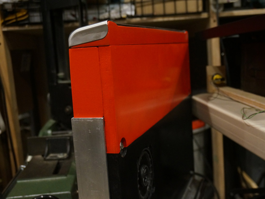

So, paintwork on the front and rear cabinet are close to done.
I drug them together and lashed up Mockup v2.0 to work on some system integration and give it a good test.
The distance between cabinets should be about 42".  I fouind I've got a 48" long folding table, and I built a setup on and around it, which means there's an extra 3" of dead space in the following photos that won't really exist when it's all done.
I built a temporary plywood frame to hold flipper buttons in roughly the right spot; it clips in under the lockdown bar assembly for now, but the real carrier for them will be part of the rotating playfield frame.
The entire front cabinet comes out on a 25-conductor cable to a DB25 plug, which attaches to the rear cabinet - this is designed to stay modular so that I can move it in pieces.
The rear cabinet is now mostly wired up, and I've got the painted access hatch properly fitting as a plug-in fit.
It fits well enough the bolts are kind of optional, though having the big 3/4" thick plywood hatch bolted in forming a back spine should further reinforce the backbox.
It takes some lifting and levering to get the hatch out, especially after the bolts have all pulled it in tight.  I also don't want anyone to ever back this machine up tight against a wall so tight the exhaust fans can't work.  To serve both ends, I found some industrial looking rack server handles and installed those on the hatch.  Slippyblade may appreciate that it's a strap away from being an adequate kite shield now.
I am stunned at how good the airflow is, with it buttoned up - it makes a wind tunnel in there.  Tried leaving the monitors both on for increasing durations with the fans running, and after a 6 hour test they weren't particularly warm - tiny bit of warmth coming off the glass in front, cold cases in back.  Not loud, but it's moving a ton of air up the slot.  Overkill, I'm sure, but it's hard to find replacement 2709WFPs these days.

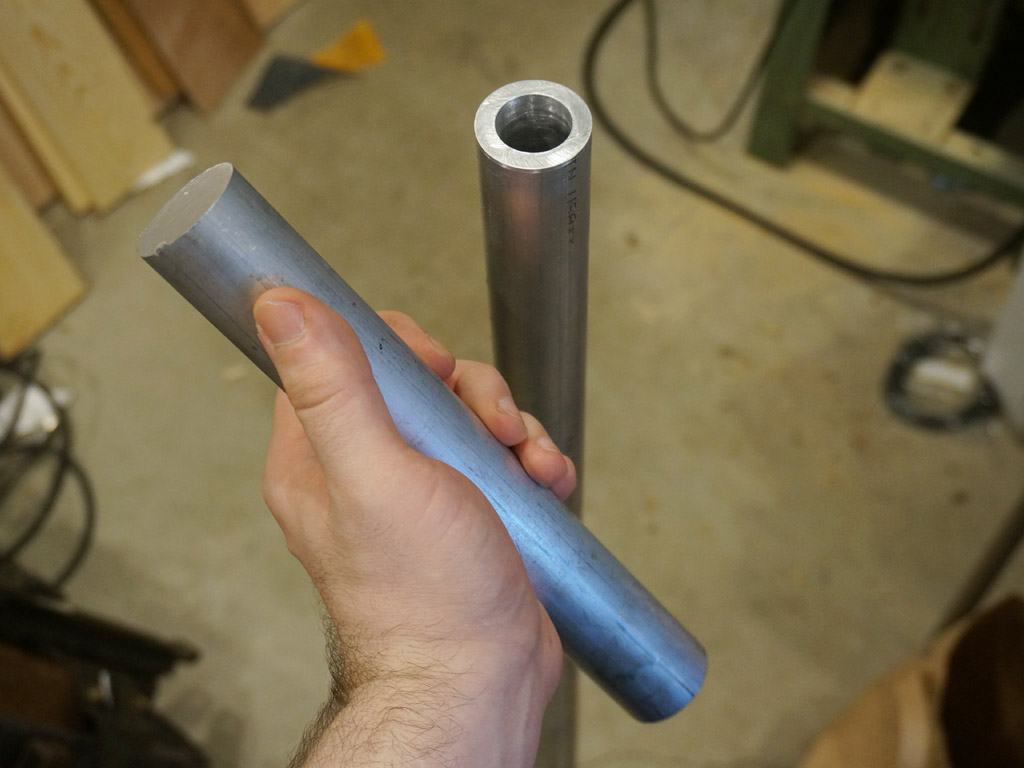

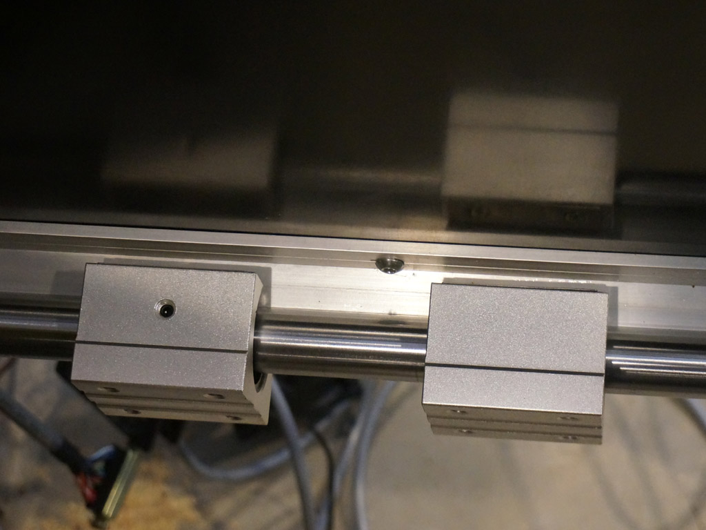

I've also acquired the linear bearings and rail that are going to support the sliding driving panel assembly.
These are 25mm hardened steel shaft rails, and ball bearing trucks for them.  They weigh about 5lb apiece, but the play and flex on them is minimal.  These are going to mount in this orientation along the bottom edges of the cabinets, and the still-to-be-built driving shelf on the blocks side then rises up about 6" from there and bridges across the center.  I'll need an actuator to move it, and locking pins to keep the drawer from moving along the rail or rotating on the plane of the rails when deployed - but these rails should do a very beefy job of keeping the wheel and sticks solid versus the other 4 degrees of freedom.
The main purpose of this lashup, though, was to further develop the software stack, tinker with table settinggs, and build and test the wiring of the modular assemblies so far.
HAHA, IT'S ALIVE.
Well, this half of it is alive.  Mostly.
I've got a few bugs to fix here and there, I think I'm going to have to write a couple AHK scripts to slap VPX into working the way I want it to - the playfield doesn't always get the focus, and you have to alt-tab into it about half the time.  But my custom front-end is coming along well.  As of last night's work, you can now push the button above the amp to power it all up and end up in a game selection menu.  You can also do a graceful shutdown using the same button, or pick "power off" from the game menu, and that all now works.

So, back when I made the wooden piece that accepts a normal 25" Williams widebody lockdown bar, I figured I'd just slice in from the ends to cut out some of the clearance holes on my bandsaw.
Unfortunately, over time, these fingers released some pent-up stresses and warped a bit, and the bottom ceased to be flat across the gap.  Additionally, I found that the lockdown would look better if it was just a touch wider - if you flush it on the back edge of the front cabinet, you can see a step under the lockdown bar on the front, and if you flush it to where the lockdown bar looks nice in front, there's a step in the back.  Some adjustments were called for.
I drilled and pinned it on both sides.  I could have used a dowel, but I had some 1/4" stainless round stock handy, and nothing says "STAY" quite like a steel pin.
Drilled 1/4 holes in from the back wall, while tweaking the floor level with my other hand, then tapped the pins in with a pin punch.
From beneath, you can see the pin bridging across the saw kerf.
The back face that I drilled through shows in driving mode - but that's okay, because I also cut a few pieces of thin hobby plywood to face over it all with.
Pinning it straightened out all the warping nonsense quite thoroughly - dig the flatness of the bottom now.
Hobby plywood over the top of it all hides and makes captive the pins, and nudges up the width of the lockdown bar assembly to where it fits the depth of the front cabinet better.
Had to use two pieces, because my pieces came in 24"s and the lockdown bar is a 25", but I've established to myself by this point that I can do the bodywork to hide the seam later on in the next round of filling, sanding, priming, painting, and complaining.
I smeared some wood glue and floated the two pieces where they belong:
Then I looked at it and said, "Man, I better put a clamp on that!"
DONE.   NEXT.

The rear cabinet now has the matching rail to go along with the front cabinet.  These will carry the sliding control panel between them.
There are six thread inserts placed in the plywood to carry the rail.  These were trickier than in the front cabinet for three reasons.  One, the structure is a lot more complicated.  Two, when you take the rear hatch off, you can see the backs of the thread inserts and screws, so I cared more about them coming out somewhat clean.  Three, there's a lot of electronics and stuff in there, so I had to take all that out before drilling.
Overall, it went pretty well.  The drill scuffed the paint on the leftmost upper one -
I'll have to touch that up with a little more black.
The middle ones are kind of funny, because the lower screw and insert goes through the web that the intake fans mount in.
But, the fan will hide the lower hole.
On the right, they go behind the power relay input box.
The hardware doesn't protrude beyond flush, though, so the relay will slide back in over the top of these.
I tried setting the front and rear cabinet together so the rail trucks touch, and they appear to track real nice - these rails are flat to each other when the legs are flat to the floor.
The rails did prompt an interesting discovery, though.  My back cabinet isn't actually flat, it's got some dish to it.  As you can kind of see in this picture:
The ends of the rail are tight to the plywood, and there's a gap of maybe 1/8" in the center between the aluminum extrusion and the plywood face.  I'm going to make a spacer to fill this space, because I trust the linear rail to be straight a lot more than I trust my carpentry to.  This shouldn't hurt anything, but it was a surprise to discover.

Back on the outside front of the rear cabinet, I spent a while looking at and thinking about the gap I had in the center of the 25mm linear rail due to the cabinetry being a bit cupped.  I wondered what the relative stiffness was, between that roughly inch sized hardened steel rod and the 3/4" plywood structure.  I tried setting my camera up on a tripod, looking down at it, and recording video, then tightening all the screws down to pull the gap out.
Reviewed the video.  It didn't look like the rail flexed.  It looked like the plywood flexed.
Hmm.
I set up a ridiculous lashup to set the dial indicator I use on my lathe and mill to reference on the center of the rail, and then very carefully worked the screws back and forth, from slacked out such that the gap was as big as it gets, to totally tight with the gap pulled flush.
Conclusion:  Under full screw tension, at the center, the plywood structure pulls about 0.2" out, and the rail pulls about 0.006" in.
I think I can live with six thou of possible curve over a 24" long run.  I think that's as nothing.  So heck with building spacers to go under it - I'm just going to crank it down and let the steel bar be the truss that straightens out the wooden box here.  I'll revisit that if the control panel balks moving across it, but given the panel is going to be a wooden structure about 42" long between the rails, I think it's fine.
I got my hands on the materials I'm going to be constructing the playfield axle from.
1.5" OD, 1" ID, 0.25" wall thickness 6061 aluminum tubing will be the spine of the axle, with lathe turned endcaps made out of 1.5" solid round stock.
I think this'll be a strong enough axle to support the big panel and the flipper buttons (they end up pointing pretty much through it's centerline) and the TV mount assembly while being motorized.  Opinions welcome!
I plan to make the endcaps a three-section spigot.  In my head, they'll have a 1" diameter spud that fits inside the tube, then out to a short fat 1.5" diameter flange that matches the OD of the tube, and then back in to a 0.75" diameter spigot that goes into the bearings.  The bearings have two set screws to grab the spigot, and I'll drill through the tubing to countersink some small screws, tapped into the spud side.

I also got the first coat of red paint on the lockdown bar assembly.  Needs another couple coats, sanding, polishing, etc - but here's roughly how it'll look on the machine.
Sorry for all the seamlines, but these three pieces disassemble for service.  Also, the top is just set on for the photo, I think I can finagle the fit a little better.
A need for another small detail like the red stripes on the rear hatch arises here.  Looking down on the profile of the lockdown bar, you can see the red part matches the front-back depth of the front cabinet, which is slightly deeper than the lockdown bar is...
This means it sticks out the back a bit.  Looking down on it from the pinball player perspective, that red is far too conspicuous - that's going to show a lot in the necessary gap between the lockdown bar and the pinball playfield.  (Some gap has absolutely got to be there for the rotation of the playfield to clear the front cabinet.)
I plan to fix this by painting the top edge - basically, the whole part you can see red in the above picture - black.  That shouldn't look bad from the side when you are in the cockpit, and should fix the problem when looking down at it as a pinball player.
Lastly, I also got the first coat of red on the axle bearing pillow blocks.
Needs more coats, but they are going to match nice.
It looks like the actual position for both bearing blocks lands wholly within the red parts of the front and rear cabinets, so they don't have to get a fiddly black lower section at all, they just go solid red.
I'll need to take the monitors out of the back cabinet for drilling and mounting the bearing blocks, and I'm triple and quadruple checking my math for where they land on the surfaces to get a 3' horizontal yaw and a 3' vertical pitch and the correct rotational centerline... that part is going to be kind of scary, I gotta admit.  :)
