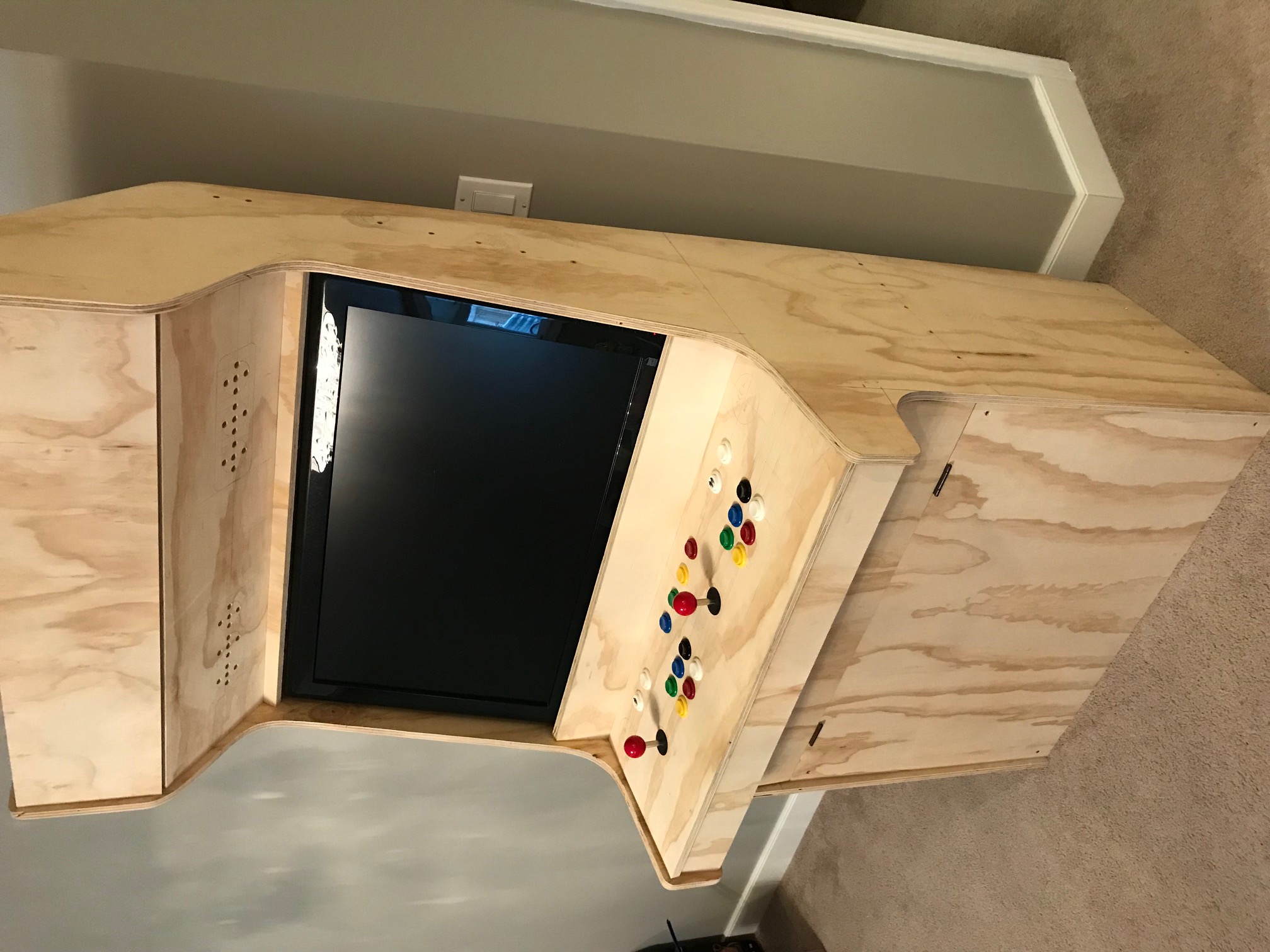

End Result:

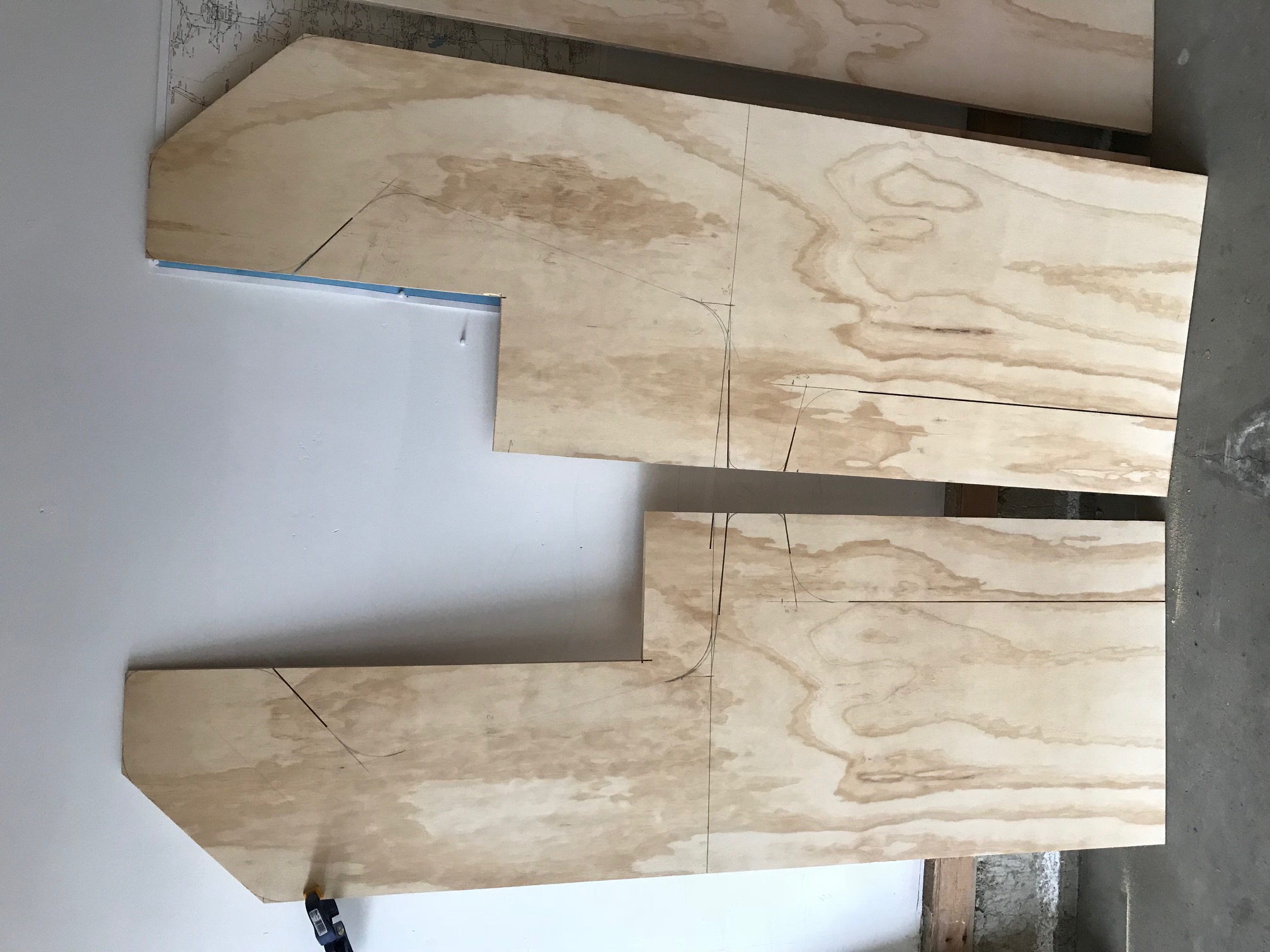

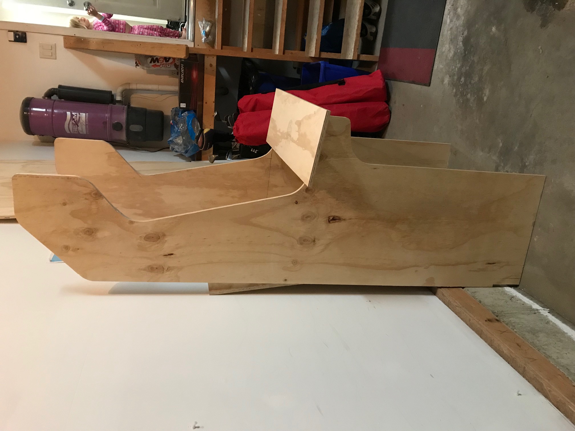

Design:

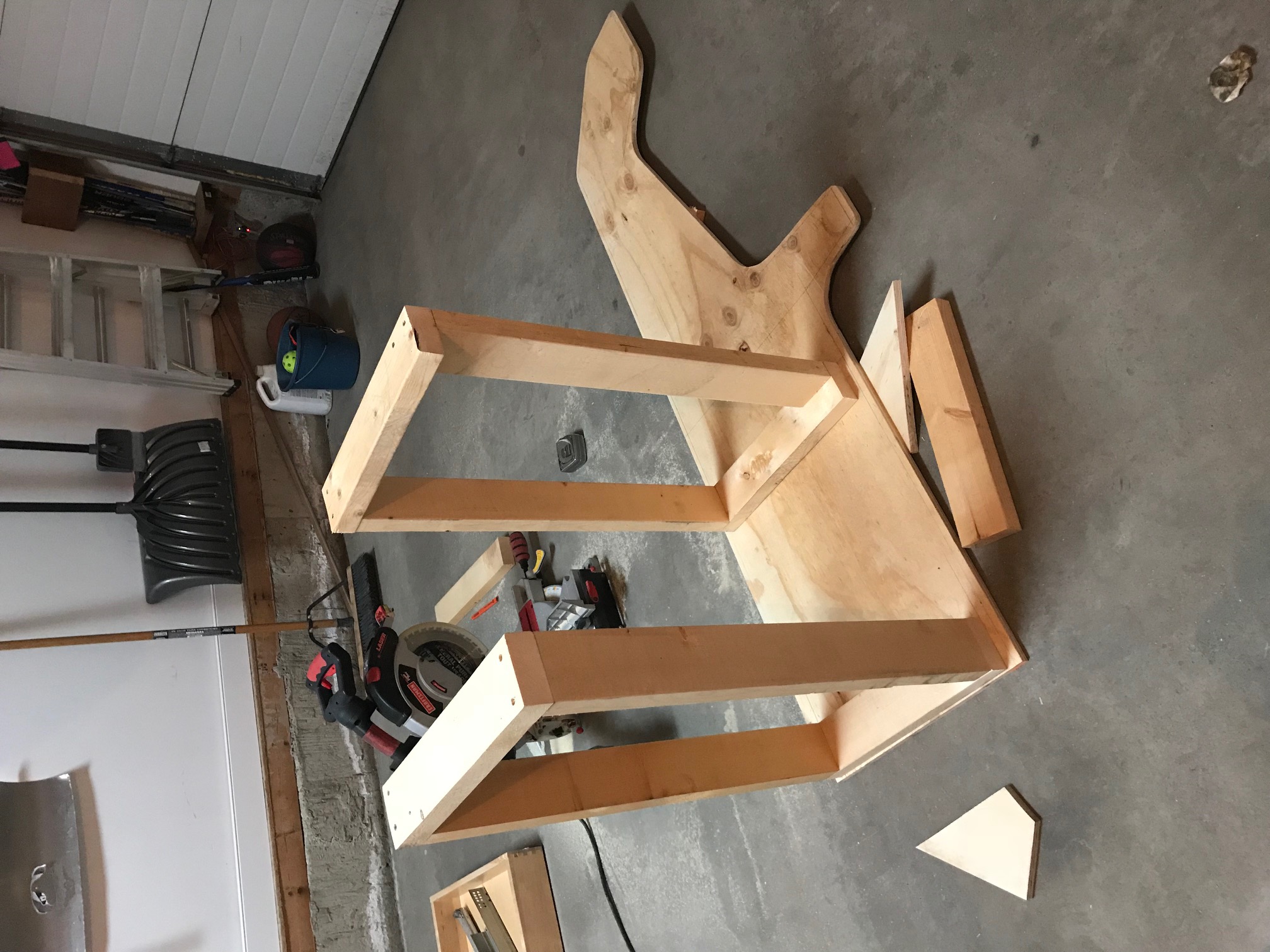

Profile was based on ChanceKJ Overambitious build plans with slight modifications for monitor height. Plywood is 5/8 one side sanded with takes it down to 19/32nds.

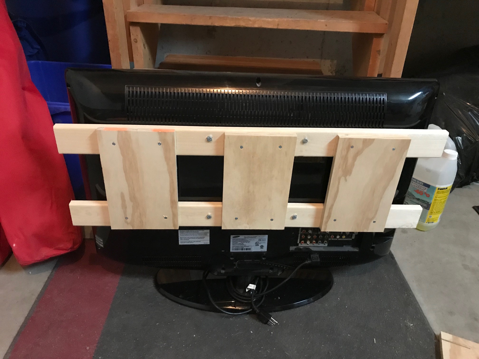

Monitor mount - it is an old Samsung 32 inch 720p lcd circa 2008. Mounted using cheap ledger board and plywood.
Frame is built by 2x4s

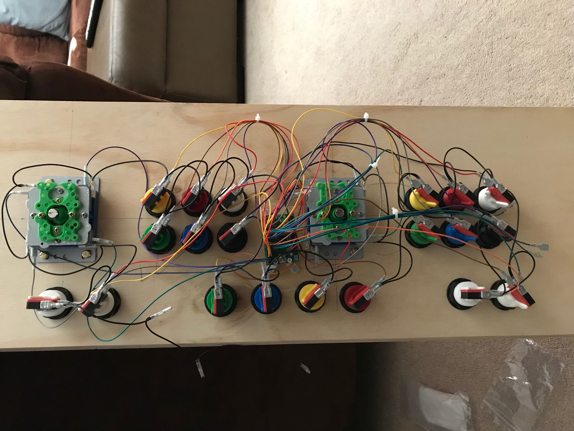

Controls are from RetroActive Arcade in Edmonton Alberta. http://retroactivearcade.ca/.

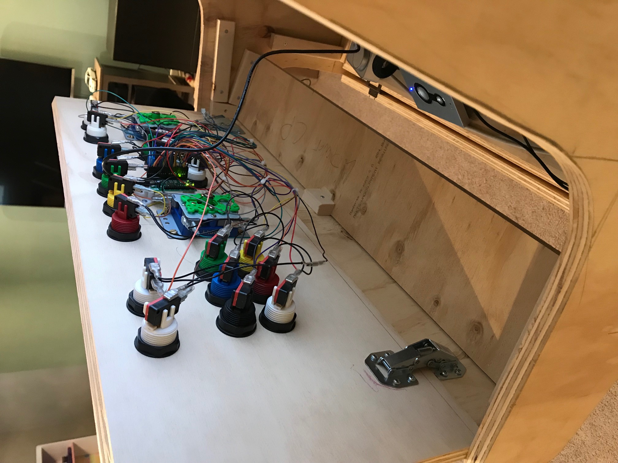

Controls are inexpensive zippy long joysticks and buttons.
I went with minipac controller. What a good upgrade for $12 to get the wiring harness instead of fussing around with wiring... and that is coming from an electrical engineer :-)

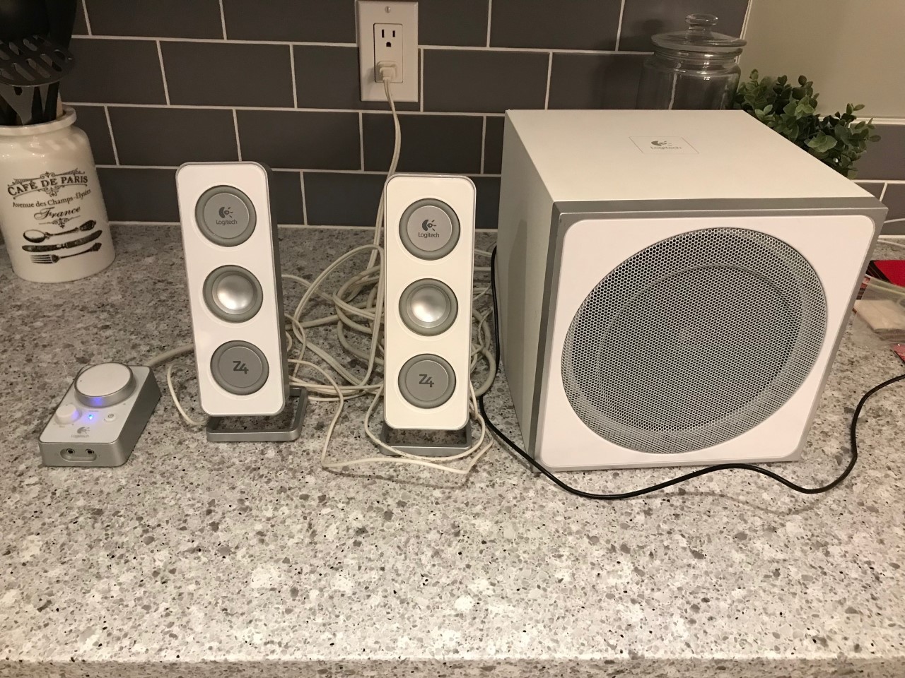

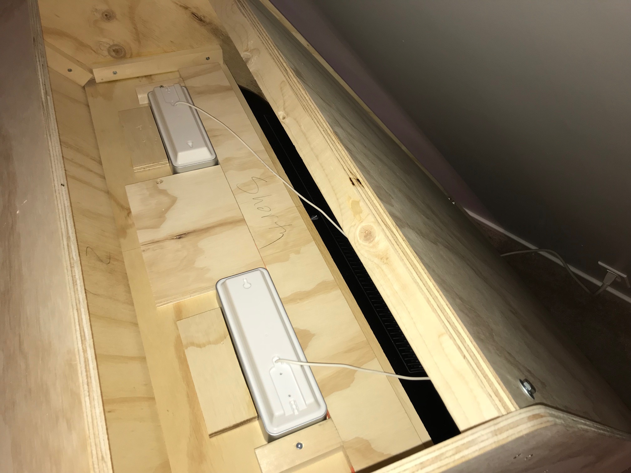

I scored a free set of ten year old speakers off of Kijiji.
Speakers are mounted above the monitor, sub is down below.

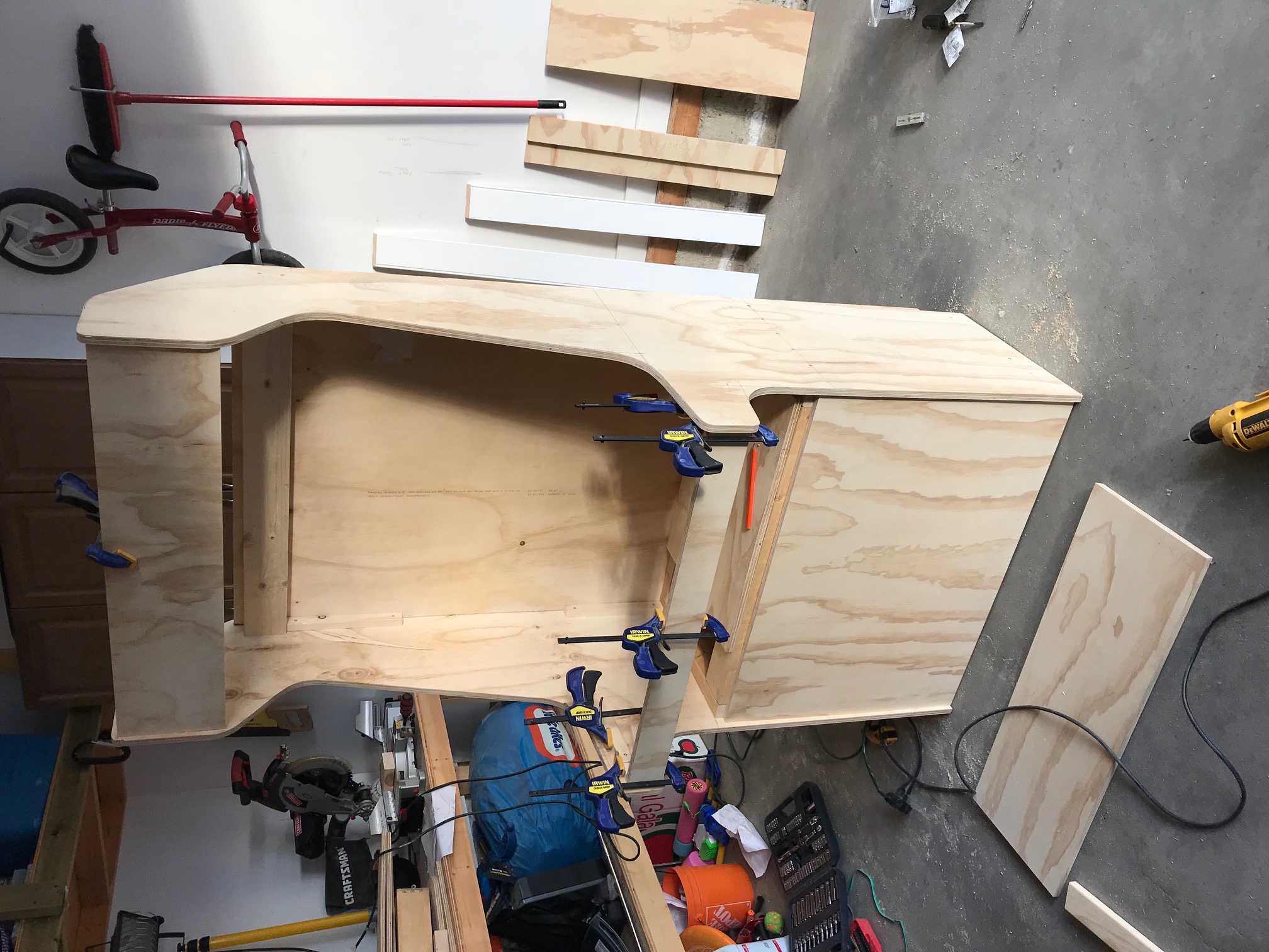

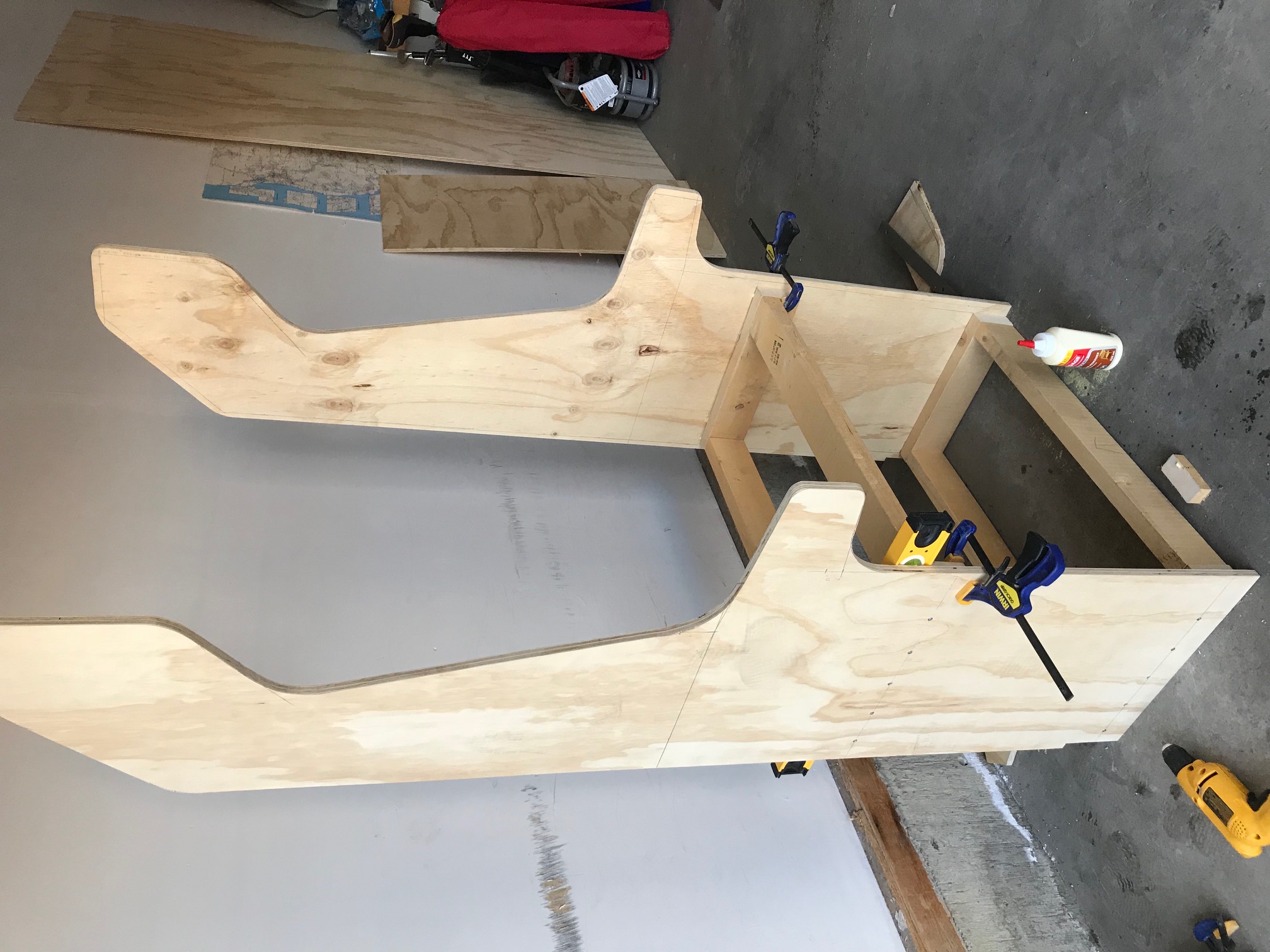

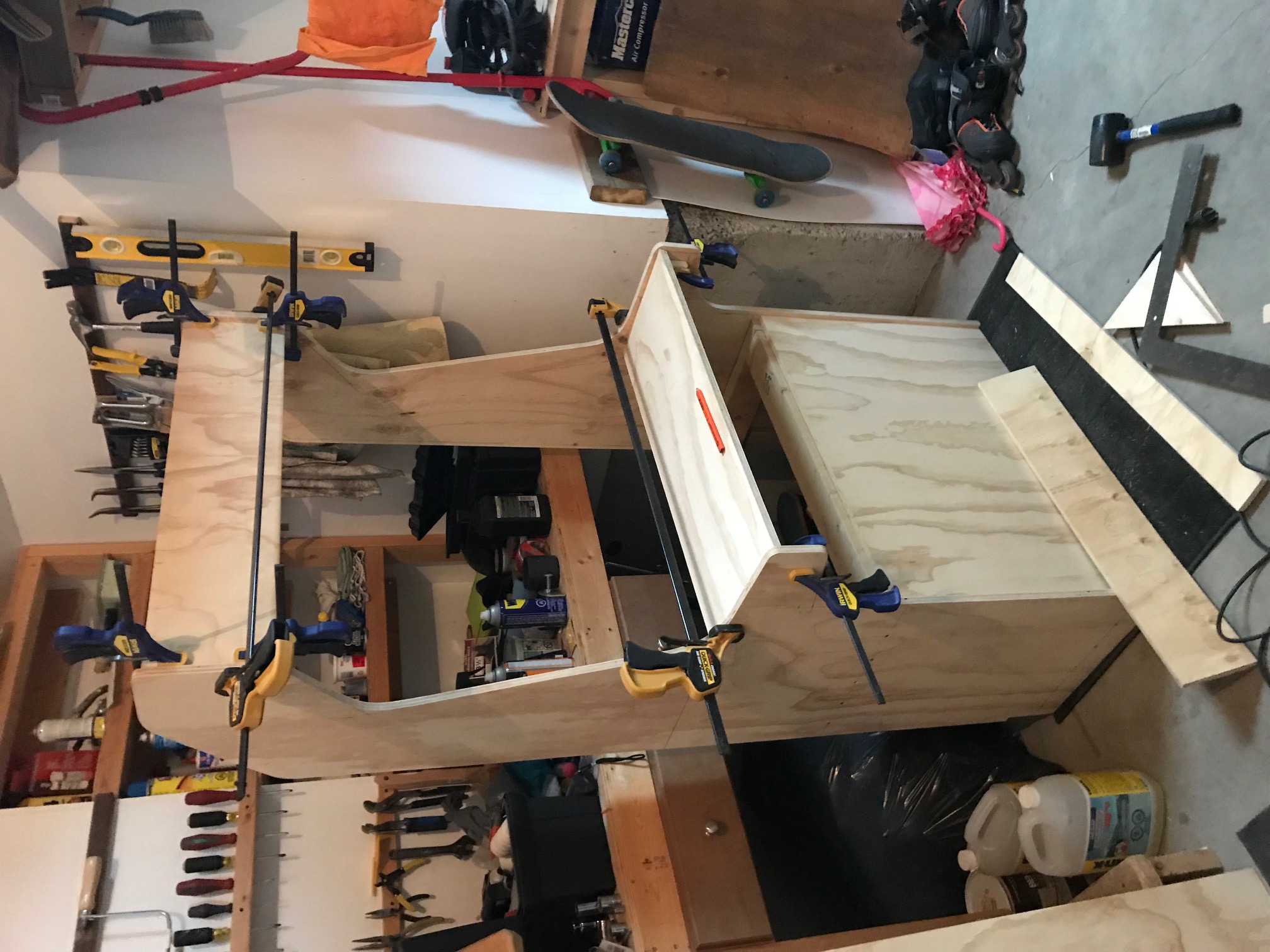

Construction:
I glued and screwed where possible. Otherwise only glued. I was trying to avoid screws fro mthe outsie but gave up on that goal.
Controls are mounted with no mortise hinges:
For now, I'm just running with MAME until I can figure out some other front end setups.
Computer is mounted without a case under the controls.
Kids love it!
