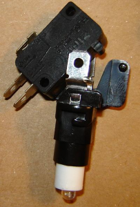

  • Posts: 9740
  • Last login:Today at 04:49:10 am

You keep saying "button".
You aren't connecting the LED wires to the microswitch, are you?  :banghead:
There should be no electrical connections between the microswitch and LED wiring.
The LED wiring goes to the 0.250" "stirrup" tabs. (pointing up in this pic)
One stirrup connects to the LED anode, the other to the LED cathode.
You can test which is which using the diode setting on your multimeter.
(LED will light dimly when the red lead is on the anode and the black lead is on the cathode)
You can pull the LED out of the socket and turn it 180 degrees if desired -- I always orient the LED so the cathode (-) is on the same side as the big black plastic tab that holds the microswitch.   ;D
Based on your pic:
Connect the red wire daisy chain to the anode (+) stirrup tabs for "common anode" configuration.
*** THE "RED WIRE" DAISY CHAIN NEEDS TO BE CONNECTED TO 5V (+), NOT GROUND. (-) ***
Ideally, the + pin (black line) would be daisy chained to the anodes of the three LEDs connected to the orange, gray, and yellow wires.
The orange (blue channel), gray (green channel) and yellow (red channel) wires go to the cathode (-) stirrup tab of three LEDs.
- Orange wire LED will light when RGB pins 49-51 are set to "blue".
- Gray wire LED will light when RGB pins 49-51 are set to "green".
- Yellow wire LED will light when RGB pins 49-51 are set to "red".
- Orange and yellow wire LEDs will both light when RGB pins 49-51 are set to "purple". (red and blue)
The Ultimate I/O lights the LEDs by applying ground to the R/G/B pins and turns them off by applying 5v to the pins.
It works like a spring-loaded, one-way plumbing valve.
If the voltage (water pressure) difference between the anode and cathode is enough to cause the LED (valve) to "forward bias", current will flow (water flows through the valve) and the LED will light.
If you install the LED (valve) backward, the voltage (water pressure) will "reverse bias" the LED. (push the valve closed)

If it does light one up your LED's polaritys are wrong so check they are in the holders correctly, I.E. + to + and - to -.
If they are the wrong way round they will not light.
