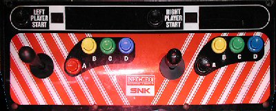

I'm just not sure of the layout. One can put 4 buttons in:
- a diamond shape
- a tilted diamond (like a square but then the right column is slightly higher)
- a square
- the neo geo layout (4 buttons in a row with the left button lower then the other three, and maybe button 2 slightly lowered too)
So far I seem to be on the neo-geo, but I need more playtesting ;)  Perhaps I will put in an extra button to allow both the diamond and neo geo layout.

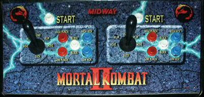

Re:Cabinet Style/Size Issues
« Reply #22 on: January 26, 2004, 08:13:06 pm »
OK, I did some quick and dirty cutouts of what I meant.
Tilted diamond (or skewed square) (image taken and butchered from motofish CPO):
Square layout (image again from motofish CPO):
(The diamond layout would be like a square rotated by 45 degrees)
Neo Geo with top 3 buttons in a row:
Neo Geo with top second (yellow B) button slightly lowered from the previous sample:
This is the one that seems to fit best with my hand
Neo geo with a diamond combo:
for good measure a Mortal Combat layout:

Recently built a 2-player Neo Geo layout on a 22" wide panel with no cramping issues at all.
Also, you guys, the majority of arcade games measured less than 24" between the sides, and many of them were still 2 player. Most of those Streetfighter 2 machines you used to play were conversions in early 80s cabinets.
You make some excellent points. When I think of SFII I always think of bigger CPs, but in retrospect you are correct.
