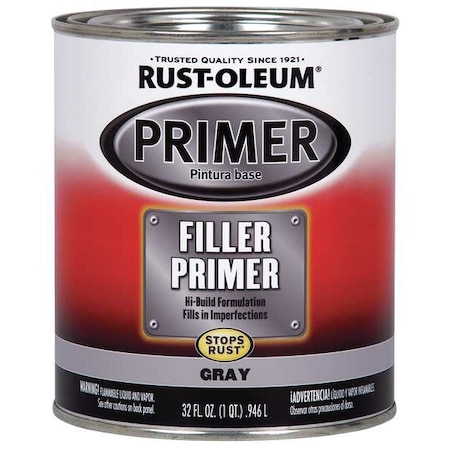

Re: Painting particle board
« Reply #11 on: February 22, 2017, 01:17:47 pm »
Just get "Filler Primer".  It's like giving it a skim coat of bondo but built in.   :applaud:
https://www.zoro.com/rust-oleum-filler-primer-gray-1-qt-254863/i/G3558651/?gclid=CLj5kN2npNICFR5YDQodzwIN7Q&gclsrc=aw.ds

« Reply #12 on: February 22, 2017, 01:40:49 pm »
I tried some of that filler primer in a spray can version but it didn't lay it on thick enough, so that is why I went the oil-based primer route. If that doesn't work, maybe I'll try rolling it on. Thanks for the suggestion.

« Reply #15 on: February 23, 2017, 11:39:37 am »
That high build primer Del mentioned is the solution. Applied in several coats sanding in between - like in my videos.  Use bondo to fill in larger pits.  Drywall compound, high build primer etc all do the same thing.  For large areas use a mechanical sander (like in my videos).  Wet sanding, if used at all is only for the final finish.  Elvis's very nice finish will be due to the initial surface prep and then final coat roller application.

« Reply #18 on: February 23, 2017, 02:50:42 pm »
It may also be that you're sanding too much.  Give it a coat of that stuff I recommended.  Sand LIGHTLY.  You don't want it to be super smooth at first.  Give it another coat.  Sand.  Rinse and repeat.  Eventually all the pits will get filled.  Then you can sand it to a smooth finish.  If you sand too much in between it won't work as well (in my experience).  You need it to build up first.
