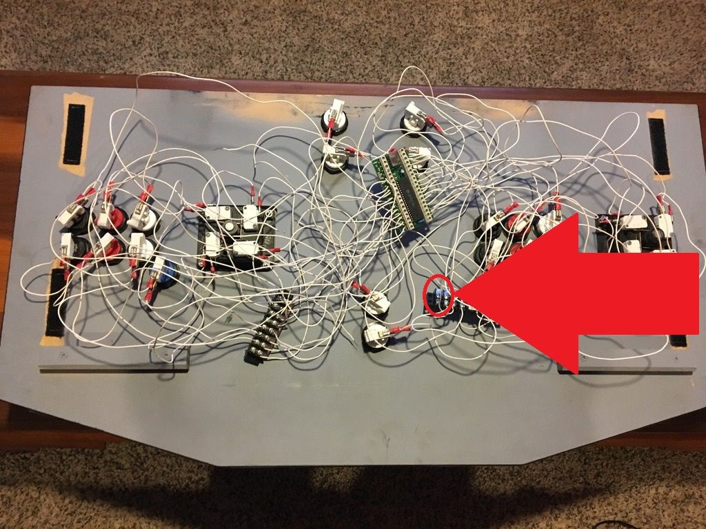

As per the image below (see the GIANT YELLOW ARROW pointing to the red box on the left), my JOY STICK on the left has all 4 of
the ground wires connected to each other, BUT THE NONE OF THE JOYSTICK GROUNDS ARE CONNECTED TO ANY OTHER BUTTONS
OR JOYSTICKS ON THE CONTROL PANEL.
As per the link below for my "Project Anouncement" introduction (and see images below) this CP is something I purchase from
another guy on Craigslist so I am trying to "get this CP right".
As per DeLuSiOnAl's youtube video below, he says "ALL GROUNDS NEED TO BE CONNECTED TO EACH OTHER".  Doesn't
that mean that my JOYSTICK ON THE LEFT IS SUPPOSED TO BE SOME HOW CONNECTED (VIA GROUND WIRE) TO ANOTHER JOYSTICK OR
BUTTON IN SOME WAY?
In other words, don't I have to find a way to connect one of the GROUND wires on the Joystick on the left (see giant yellow arrow and red box) to another button GROUND WIRE or the other joystick GROUND WIRE???
In the photos below, are also photos of my CP which show that some sort of connecting box is used to help connect the wires
but the JOYSTICK ON THE LEFT IS NOT CONNECTED TO ANY OF THE TWO "CONNECTING BLOCKS", much less anything else on the CP.
Here is the "connecting block" (which by the way none of the joystick ground buttons are connected to, obviously).

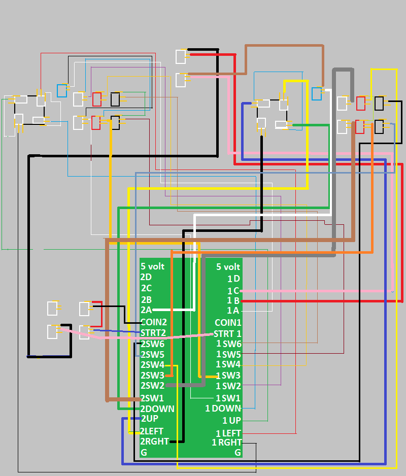

(the tiny red arrows throughout the CP wiring diagram below are connection points that have not wire attached to them ie I have
to figure out which wire should go to them)
Here is a view of the entire CP wiring (you can see there are a lot of wires NOT CONNECTED if you look closely)
Is my joystick on the left OK the way it is as far as the GROUND WIRES are concerned, or should I somehow connect
one of the ground wires to another button/joystick ground wire on the CP?

n3wt0n
  • Posts: 540
the grounds don't HAVE to be all connected to another ground but it is the most efficient way of doing the job. I cant see exactly what is going on in those pictures but what I would do is daisy-chain grounds to all the buttons and joysticks on the player one side and then run that to the player one side ground on the ipac. Then do the same for player 2 side. I hope that makes sense.
Loopey1
  • Posts: 74
  • Last login:December 08, 2025, 08:39:10 pm
Big Question in my eyes is why the hell are you using barrier Strips? That just makes a mess outa everything IMO.  Mount the ipac right in the Center of the CP (Hot Glue if you have to)
then run each wire to its switch. Nice Simple SHORT clean wires. Run P1 Grounds in a daisy chain on ALL the P1 controls and Joystick, to the Ipac P1 Ground, then do the exact same thing for P2, but ground it to ipac P2 side.

Titchgamer
  • Posts: 4222
Ide be worried if it was connected to the mains! LOL
As for your question.
They wont work simple as that :p
rip all the ---smurfing--- wiring out.
buy a cheap jamma loom on ebay, cut jamma connector off
wire the swtiches to the IPAC, jamma loom comes with ground loop.
all the grounds on all the switches for all the buttons and sticks should loop together.

Question: What is the negative affect on your CP if you forget to ground a button or joystick or NONE of your buttons or joy sticks? Will any of those said buttons/joysticks work at
all?
IF they are not grounded the circuit can not complete so pressing a button will do nothing ! If the grounds are hooked together and never connected the entire circuit will not be able to complete and none of the buttons will work.

Yes on both -- the encoder would be the ipac2 if that is what you are using and the jamma harness will have a ground loop connection that has several quick disconnects wired to a single long black wire and you use it for the ground side of all the buttons and joystick switches and then use the labelled wire for the other side of each as labelled on the harness.
SO each button switch will have 2 connections going to the ipac - 1 for the ground (which also goes to the other buttons in a loop) and 1 from the NO (normally open) connection on the button switch back to the specific input on the ipac2 (ie. joy1 up goes from the joystick up button back to the joy1 up connection on the ipac - etc. etc. etc.
It's really pretty simple once you get going - just go from one connection to the next and you'll have it done in no time.
you're over thinking this. getting the jamma loom/harness is just so you dont have to crimp wires, and you can color code if you want.
all the grounds "loop", just go take a look at any project thread
