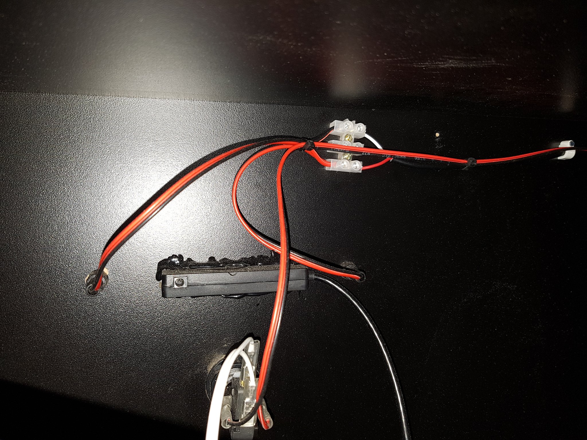

It was delivered all setup with a USB hub (4 port) and DC power sockets (x2) on the front of the cabinet to connect the guns.  The guns all work as does the recoil.  I'm just trying to get them all setup with MAME and HOTD etc.  Getting there (I think).
I looked inside the cabinet and there is a single PSU for the Aimtraks rated at 36V / 3A.
A single DC cable comes from the PSU and has been split open to reveal a red and white wire.  These two wires have been fed into separate sections on one side of a terminal block.  Two wires (red/black) have been connected to the other side of the terminal block, i.e., 1 red/black wire connected facing the original red wire and another facing the original white wire.  Each red/black wire is then connected to the back of the DC socket on the front of the cabinet.  As shown below:
(ignore the other red/black wire shown in the photo, that is fed from elsewhere and connects to the power button on the front of the cabinet to turn it all on)
  • Firstly, is that wiring legit? I am no electrician  :P but I'm just not sure if each independent DC socket can be powered from 1 cable from the original PSU like that.  As I say, it does all work!
  • Secondly, I thought that two guns would mean you would need two separate PSUs, i.e., both 36V /3A, one for each?
  • Would I get better performance from two separate PSUs (i.e., better recoil)?
  • Finally, I actually want to keep the guns connected all of the time so want to have them connected directly to my PC and route the cables around the back, so I will probably get two USB extension tables and maybe some additional DC sockets and two DC extension cables.  Any thoughts on what I would need?
1: you stated "A single DC cable comes from the PSU and has been split open to reveal a red and white wire." would this not be 2 wires then? just because it has a plastic cover on the outside and appears as a single cable, it may in fact have 2,3,4,310 wires inside it. you have 2 wires... a positive and a negative. this is what your red/black barrel connections are using.
2: the aimtrak power requirement is really only about 2 amps (it's recommended 4 but that's neither here nor there). sharing the power between 2 guns at a point when they both have to trigger simultaneously might result in a slight decrease in the motion felt on both guns.
3: it's possible. if the perceived motion of the gun is considerably different than when fired independently, then sure go ahead and use a larger supply, or like you mentioned, 2 separate supplies.
4: I would advise against powering the guns from the computer's power supply, the noise and ripple introduced by the firing can cause havoc on a running computer causing all kinds of crashing, lockups, or even corrupted data. a solenoid coil is a very dirty thing to operate and without proper suppression, the back EMP from the coil magnetic field collapsing... it can cause dips and surges in the power supply... something computer REALLY don't like. on a dedicated power supply, this is not an issue.
the power supply is only used to power the coil, nothing else on the gun. the gun itself is powered from the USB cable.
I would absolutely suggest powering the coils from a separate power supply. if you must, switch the AC power to the power supplies using a relay and a 12 power supply from the PC so that the power supplies are turned on when the PC is. (I use this setup to switch on a wall mounted 32 inch TV connected to my PC.)

Thanks for your reply.  Yes, you are right about the cable from the PSU.  It is a black wire containing two inner wires.
I looked more closely at the wiring because the way I described it did not make electrical sense, even to someone with my limited knowledge.  The picture doesn't show it, but it seems that the terminal block is not wired how I originally described it.  It is like this (which makes more sense to me):
Positive to left socket
--------------------------Positive from PSU
Positive to right socket
Negative to left socket
--------------------------Negative from PSU
Negative to right socket
So I'm happy that it is legit and I understand how it is able to work!
