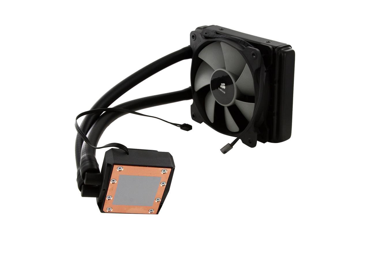

WHat CPU is it ?? THe highest rated Athlon x3 I see is the x3 460 @3.4Ghz. or do you actually mean 2.7Ghz. (x3 425 CPU) ?
FIgure the X3 460 is rated at a max temp of 167F - so they do tend to run a bit hot and if you are overclocking it to 3.7Ghz. you are also pushing extra wattage into it to keep it stable - so will likely be running fairly hot at all times.
What CPU cooler are you using ? Figure if using the stock cooler and over clocking the CPU the heatsink is probably not adequate to dissipate the heat due to the extra wattage the overclock is supplying - SO getting a better aftermarket cooler (or even adding a enclosed liquid based cooler) might help - since the liquid based system would move the radiator and fan away from the MOBO and other internals so the heat could be dissipated easier and faster so the heat build up lessens.
Something like the Corsair h60 for example

the athlon x2 is a pretty hot CPU for what it does (95 watts TDP for only a squeek over 3 ghz.) . from your description, it sounds like you have an AM3 motherboard, in which case, i would look into a CPU with a better architecture and a little less power dissipation needs or a better cooler and a solution to get that heat out of the cabinet.
like mentioned, an all in 1 liquid cooler like the corsair H series can get that heat out of the cabinet, exhausting the air out the back.
but even a simple solution such as a 120mm fan mounted in the back blowing out might be enough to keep the air in the cabinet from getting saturated with heat.
