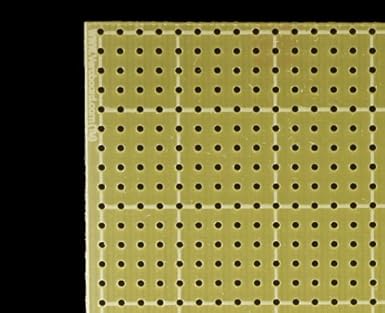

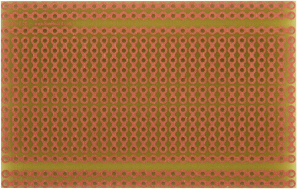

While you're waiting for them to arrive, do you have perfboard, a solderable breadboard, or something similar for mounting the relays?   ;D
I would have loved to had some and do a proper job instead of soldering wires straight on to the relay legs
Trouble is i'm 150 miles away from anywhere I could buy this (West coast of Scotland) :)
Then you can use zip-ties (red) or fishing line to secure the relays (blue) legs-up on a board (brown) with a notch (yellow) and use another zip-tie or two as strain relief for the wires.
