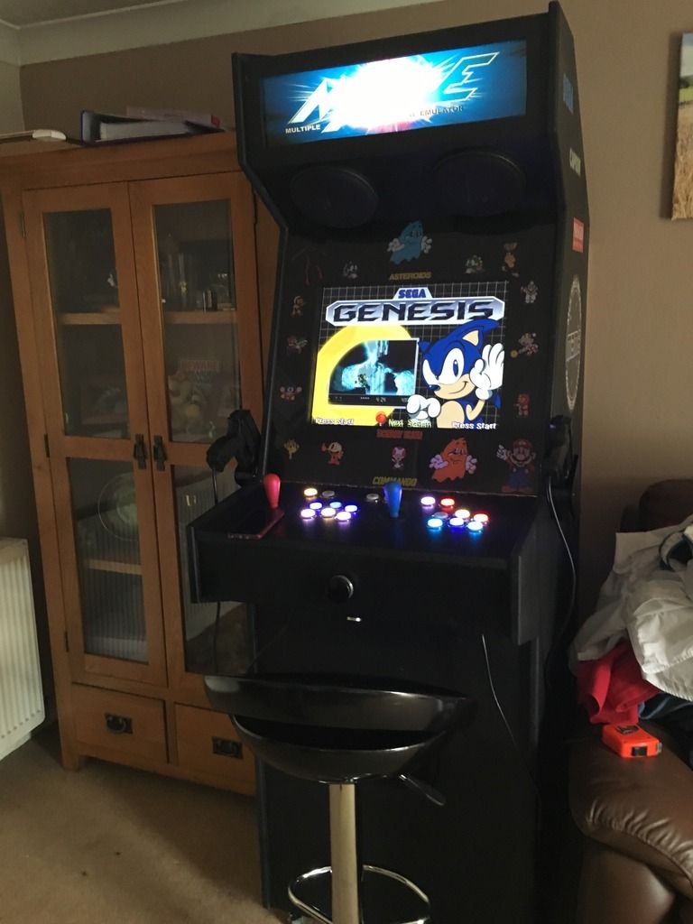

Re: Opinion on my machine
« Reply #42 on: July 22, 2016, 03:14:47 pm »
My opinion? rotate the pics prior to posting... ;D ;D ;D ;D
A;ll kidding aside, looks nice. Will the CP be a separate unit that sits on top? If so, you should be fine. Based on the height to wheel base ration though, you may have some issues with it tilting backward due to the center of gravity being shifted back due to the angle. But if it is against a wall, you should be fine.
This was the first thing that my brain rebelled against when I saw the profile.  As a general rule, the base depth should be at least the same as the top part of the cabinet, especially at this height where there is a fair amount of weight toward the top.  I noticed in the video that one view showed it an inch or so from the wall, and another view looked like it had been pushed against it.  Purely conjecture, but it appears that he found out that it was tippy and pushed it back to make contact.  Even if the cabinet is designed to rest against the wall, it doesn't make a whole lot of sense to make the base shallower.  The room footprint will be the same regardless.  But I guess if the form is more important than inherent stability, one could always sandbag the bottom to add ballast.
I also have to wonder about using such a large screen, so close to the players.  Mine has a 27" 4:3, and for horizontal games, that even feels pretty large.  I tend to favor the showcase-style cabs for big screens, but if you've mocked it up and like the big screen, that's fine too.  I had people tell me a 27" was too big, but you get used to it.

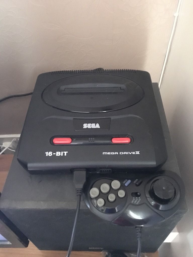

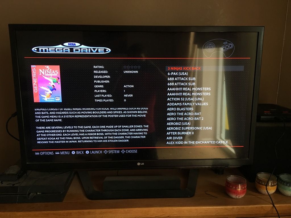

As I said before though I prefer Pi now for smaller projects like my Mega Drive i did.
Runs a Rpi 3 with retro pie front end and accepts original joy pads.
Simple and effective with little consideration towards cooling required.
Admitidly no good for heavier games but hell I dont really play alot of those kind of games on cabinets etc so personally not a problem for me.

I'll reserve comments until you have finished the cab, except of course, it is too low.
