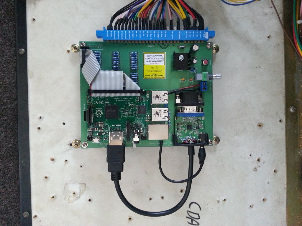

« on: October 08, 2015, 08:51:11 pm »
I got one of these recently, I really like it.

^This -- looks like a nice little add-on board - well designed and laid out. Any info on what they will be charging for them if/when they increase production beyond the 24 ?  :cheers:

It runs AdvanceMAME, you can obviously add what ROMs you want, it can be setup for vertical or horizontal cabs.
It's approx $250 Aussie dollars all up, he has ten boards left.
If you want to know more of them there is a thread over at Aussie Arcade: http://www.aussiearcade.com.au/showthread.php/67986-JAMMA-board-from-Raspberry-PI?highlight=Raspberry+Pi
I think you need to sign up on the forum to access it.

Hi, I make this board!  Sorry to drag up an old thread but I had no idea this post was here.
Wanted to let the thread know the new version is cheaper than the old.  Complete setup with rpi2 is AU$205 +delivery.

This is cab focused, the default output is 768x240 through HDMI.  It has AdvanceMAME, MAME4ALL, and retroarch emulator cores MAME2003 and FBA_next, it does not have roms.  I have made it as friendly to Windows users as possible, all rom and image dirs are on the boot partition to make them accessable from Windows with the sd card plugged into your desktop.
It will work without the JAMMA adaptor I make but if you have anything plugged into the GPIO except buttons probably best to unplug it (as I don't know what will happen), it's only been tested on pi2 as I haven't used a pi1 for ages.  I'll update with results if I end up testing it on a pi1.
Theres 14 parts which decompress into one 7z which decompresses into a .img file.  If anyone feels like hosting the single .7z file somewhere else (public) I would really apreciate it, you have no idea how bad my internet connection is.  Last time the software was taken down after about a week, hope it lasts longer this time.

And... about SD card corruption...   this actually hasn't been an issue.  The only writes in normal use are returning to the menu from a game (high score, etc.).  As long as you return to the menu before switching your cab/pi off it shouldn't cause any problems.  I fit the adaptor with a reset button in case you happen to make the setup unstable while getting it how you want it, the hardware reset cleanly unmounts the card or something like that (I forget the details).  Also this setup is not overclocked by default, unstable overclocks and early kinda crap drivers are the main cause of the pis rep for killing SD images.  The software behind the scenes has improved though, so I think the main culprit is settings these days.  If you play with settings files or add or remove games etc I would recommend a clean shutdown or reboot, thats about it.
That said, always have a backup.

I've actually had one of these for a bit. It's the brain of my Badlands conversion cab.
I went ahead and built an RGB amp into mine. I picked up a kit designed for an N64 off of eBay, as a breakout plus external components and the amplifier IC itself totaled up to more than I was willing to deadbug. It's a simple TI THS7314 RGB amp at heart, real popular in the console world it seems (for dealing with Non-TTL video signals).
And installed with it's Opti-Wiz.
The cab only runs Champ Sprint, Super Sprint, Super Off Road, Super Off Road Track Pak, and Danny Sullivan's Indy Heat.
As a note, nothing was harmed. Badlands is a JAMMA board. :)
