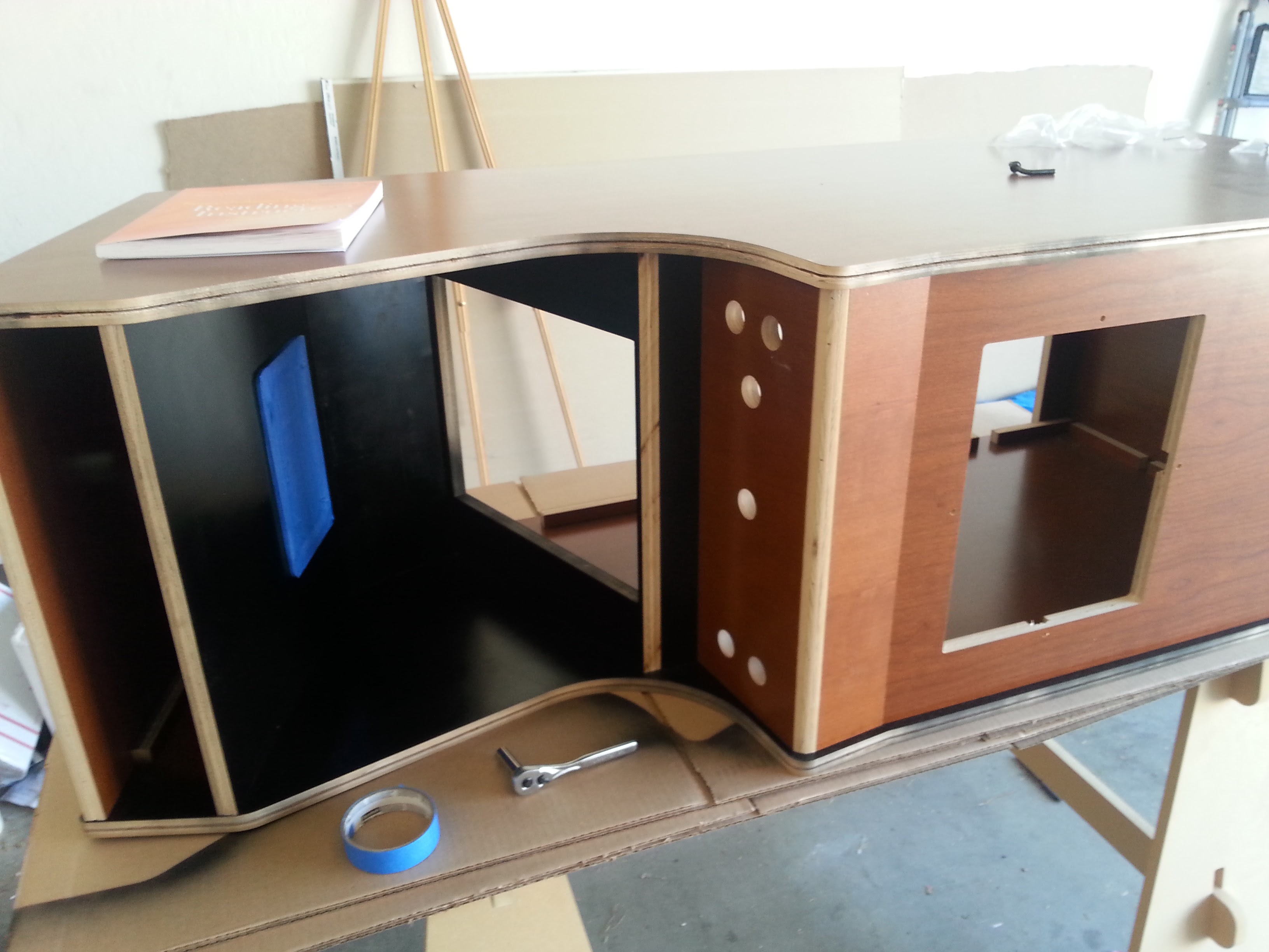

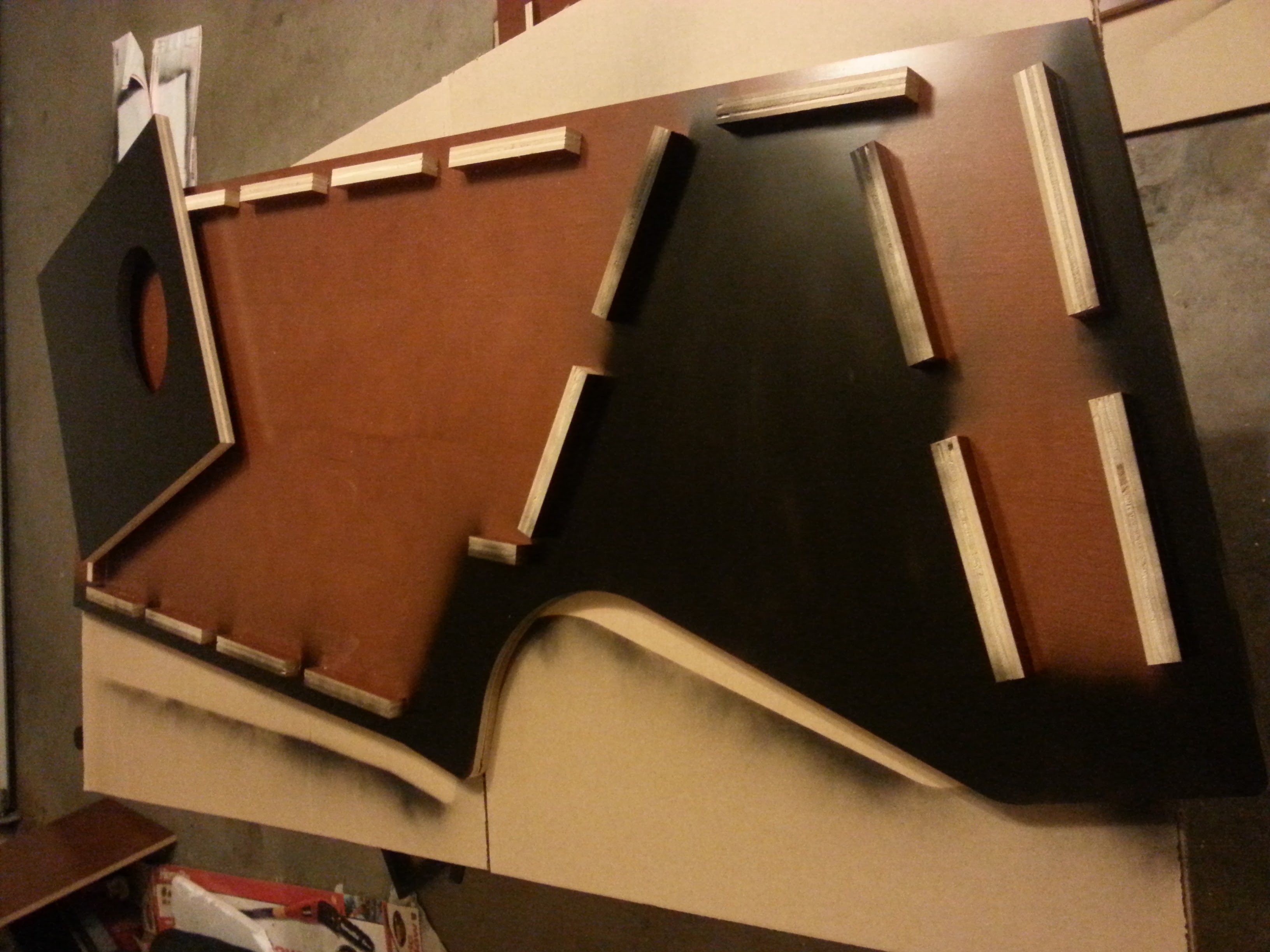

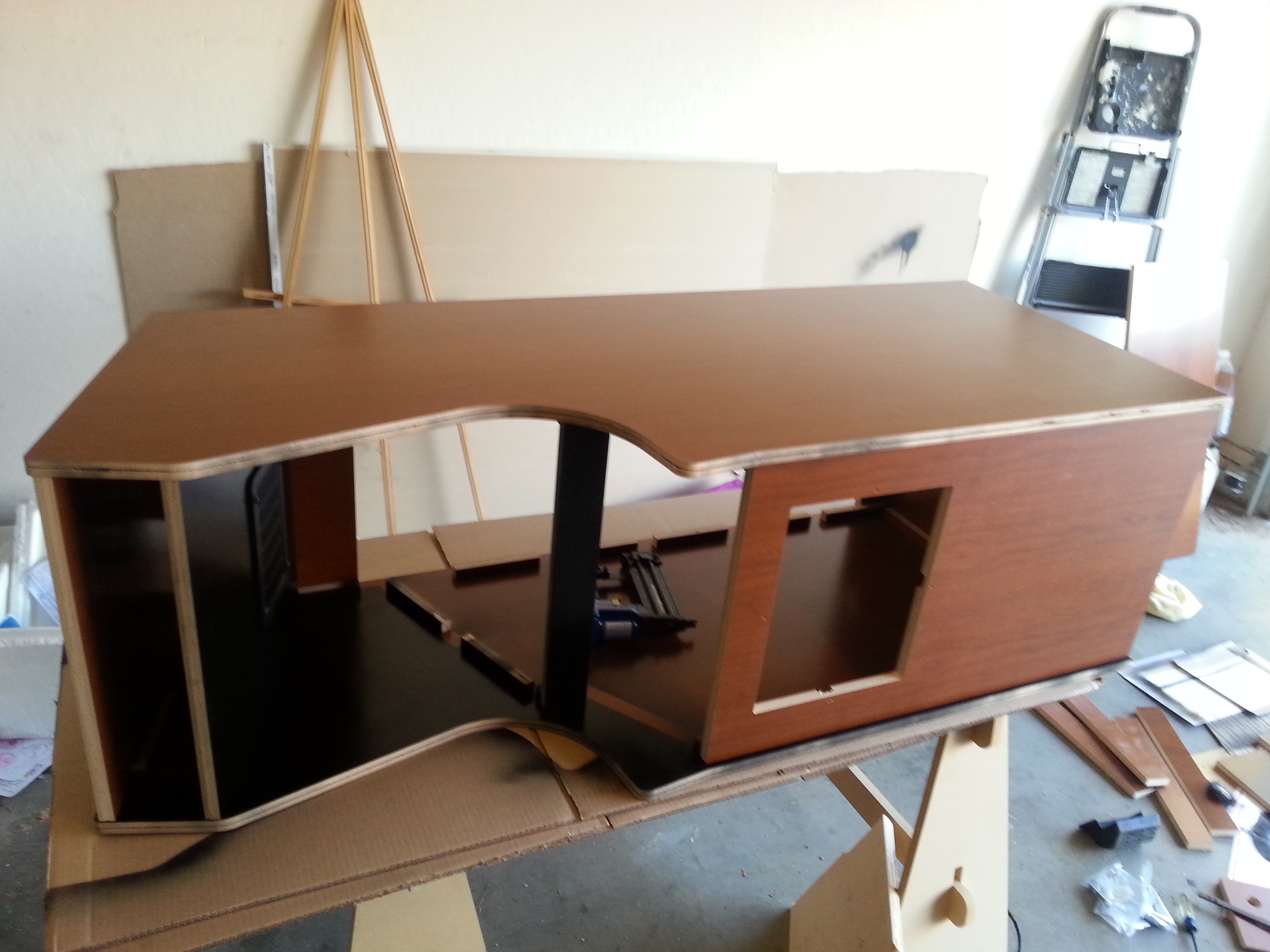

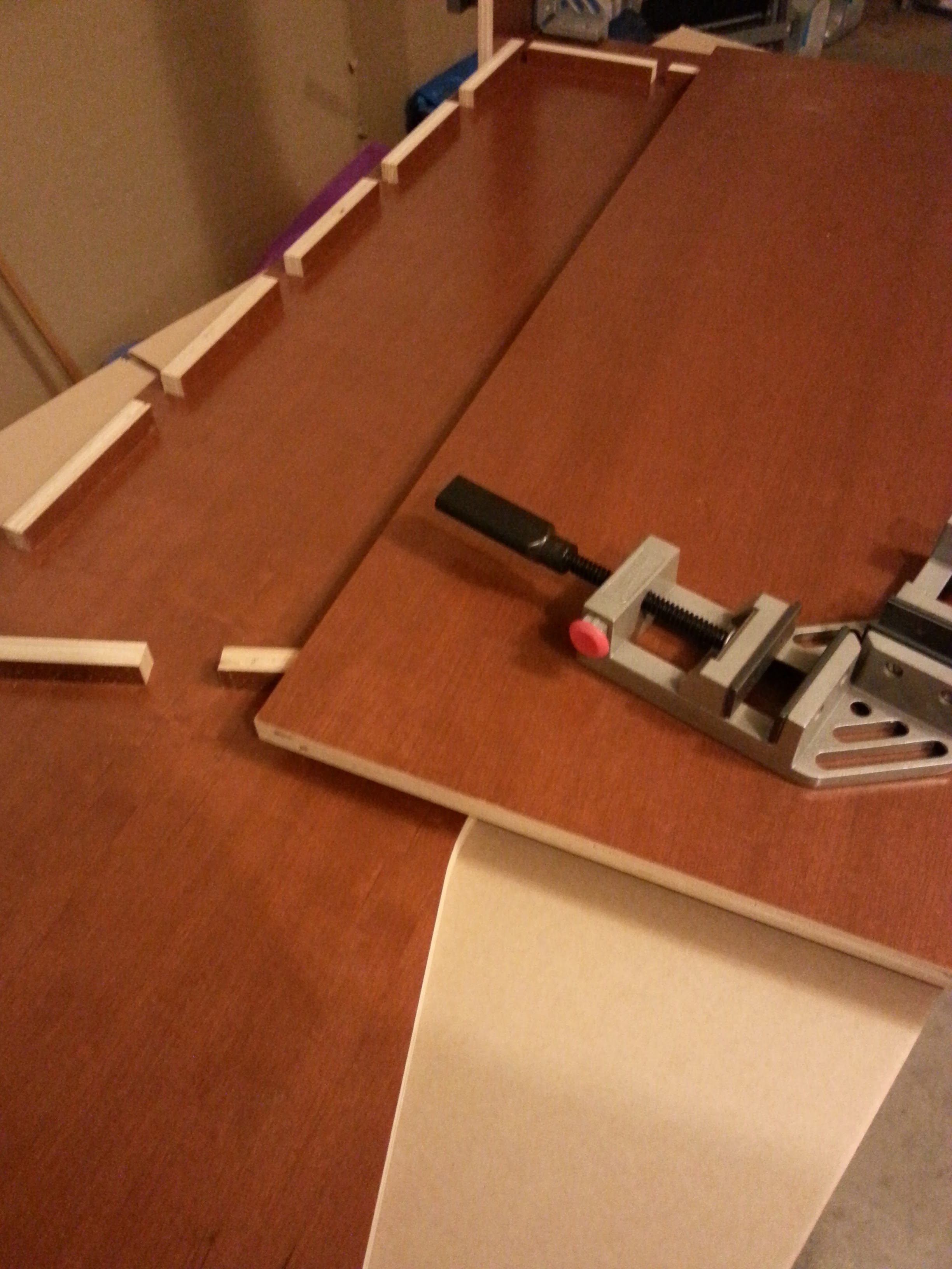

Long overdue update, cabinet is finished, got a TON of play at ZapCon, including a guy scoring 2.4 million on Galaga, followed by another guy rolling Galaga over and scoring 4 million before giving up (with 11 fighters left over).   :applaud:
Batons installed (wood glue):
Painted some parts black, just used a couple coats of satin black rustoleum:
Started assembly.  Simply used the nailgun to pop nails through the batons and into the panels:

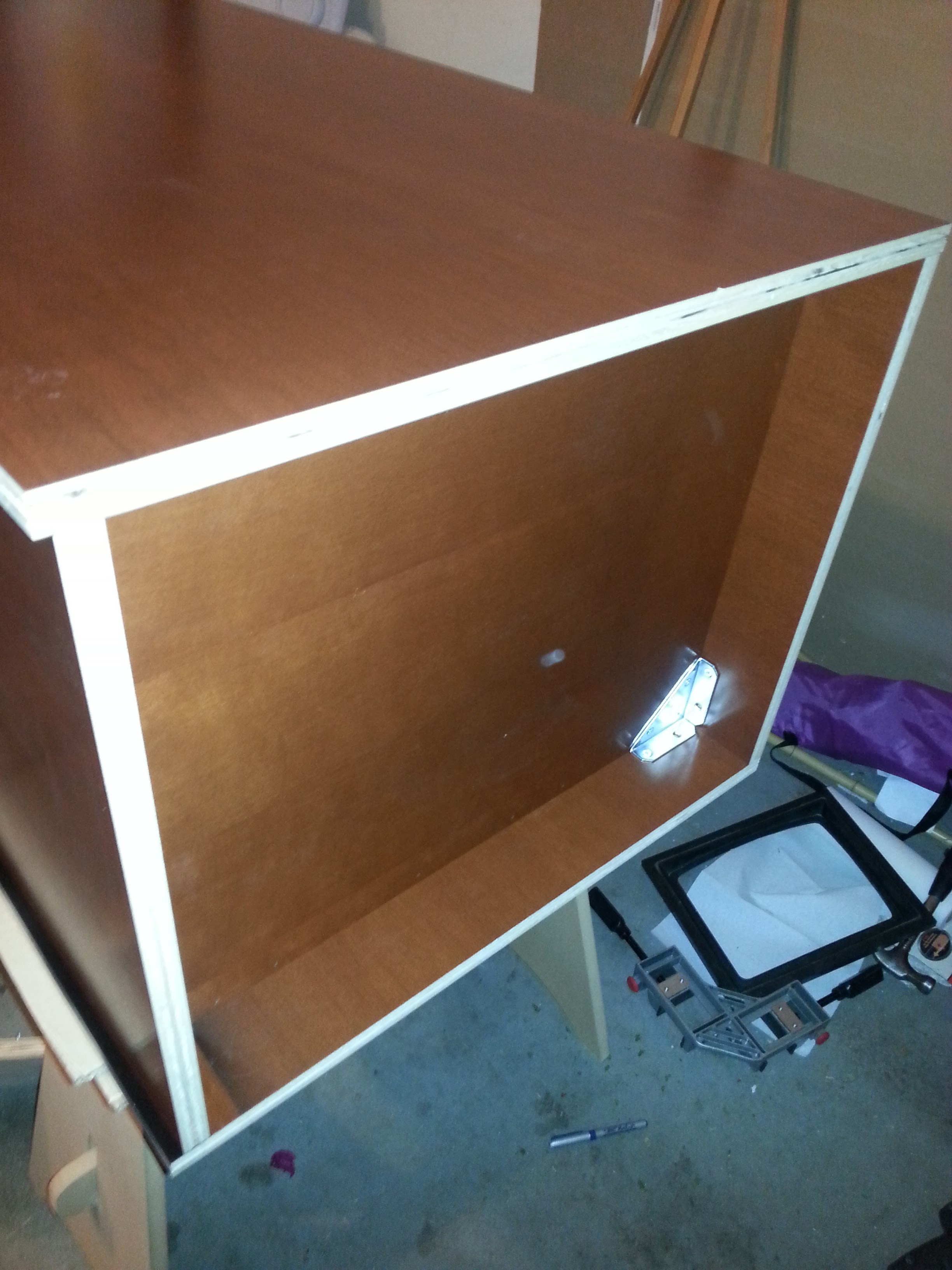

Added corner braces to the bottom for stability:
Test fit the control panel, taped off the speaker cover so I could do another round of paint:
