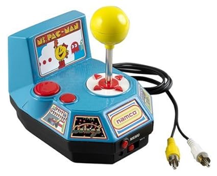

Personally I'd like to see the MAME Devs hack it or someone to release an alternative build of MAME hacked to make it playable with limited rotation wheels.
in this Jakks Pacific TV game
the game Pole Position  is playable with only a rotation of like 90 degrees, maybe one can use something like that??  :dunno
