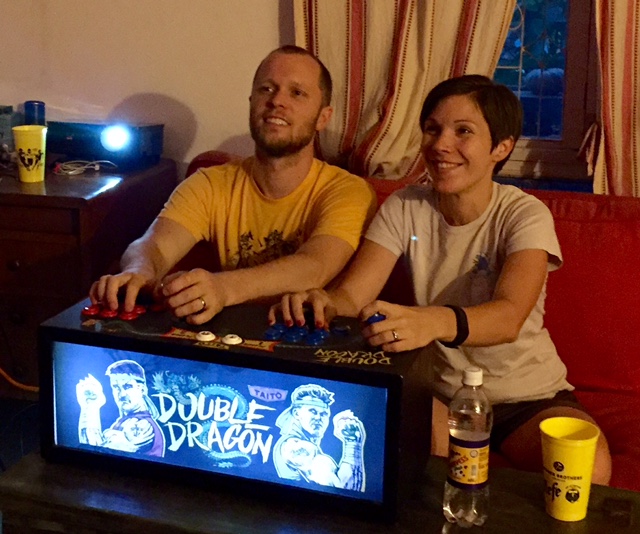

Double Dragon Marquee cade (FINISHED)
« on: January 25, 2016, 09:57:58 am »
Photos added of the completed cab.
Original first post below.

I picked up the box from the carpenters today. I think it came out well.
I noticed that all my buttons dimensions were slightly off on my CP art/plans. It's a good thing I found mistake before getting my guide printed. For standard Happ buttons is a 1.3 diameter safe for planning my art? I know the hole is 1 1/8'' (1.25 inch) but I'm looking for clearances of the lip around the button for the CP art.

Finished. Well actually it's been done for a while but I had to travel to South India for work and am just now getting to posting. Anyway, I was at the cab's new home last night so I could take some photos of her in action. We ended up playing through The Simpsons. It's a big hit and has been getting near daily use.
Here is the new owner's enjoying the build. (Note: the Marquee looks better in person)
The only thing that might change at this point is if the Pandoras box 3 ever arrives it will be swiped in. I worked out a deal with the vendor that if they sent the Pandora's box 3 then I would approve the payment. That was over two months ago and I won't feel to bad if it does not show up and the vender gets nothing.
Please feel free to let me know what you like, disliked, would have done differently, or what ever. I appreciate honest feedback to help me improve future builds.

Fixed the light bleed on the left and right edges of that marquee.

Will do. I have to show him how to remove coins from the box anyway.

That looks like a 70s catalogue advert for the new magical world of arcade games in your own home. Soon, they say, controls will get so compact that they'll sit in the palm of your hand.
