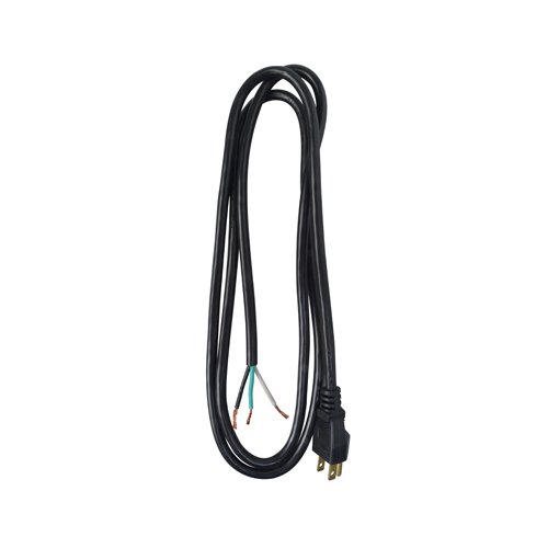

Hi everyone,
I was wondering if anyone can send me clear image instructions on how to power up the Jamma Power Supply that comes with the 60 in 1 board, I recently purchased one and just realized there is no cable to power up the power supply box that comes with it.
Can anyone tell me if possible with a clear picture which cables go on the FG, AC & AC screws areas ? As you see J have already connected the 12v, 5v and Ground
I saw s YouTube video and noticed someone used a computer power supply but not sure how He did it, he doesn't exactly explain which wires he used.
Any information will be greatly appreciated.
See image attached

Standard US AC power wiring colors.
FG = Frame Ground = Green wire
AC/N = AC Neutral = White wire
AC/L = AC Live (a.k.a. Hot) = Black wire
« Last Edit: January 18, 2016, 07:39:53 pm by PL1 »

Thanks so much Scott!!! Just the answer I was waiting for, I guess I can get this cable at Radio Schack or any other power cable. Thanks!
  • Posts: 9720
  • Last login:Today at 04:11:49 am
Re: Jamma Power Supply Power Cable Help Please
« Reply #3 on: January 18, 2016, 07:56:29 pm »
. . . or Lowes . . . or Home Depot . . . or Walmart . . . or pull one from a dead appliance . . .
Any 3-conductor power cable will do the trick as long as it's in good shape (no abrasion, corrosion, etc.) and can handle the current draw.

The 60 in 1 draws so little power that you won't be able to find a power cord for the power supply that can't handle the current draw.
