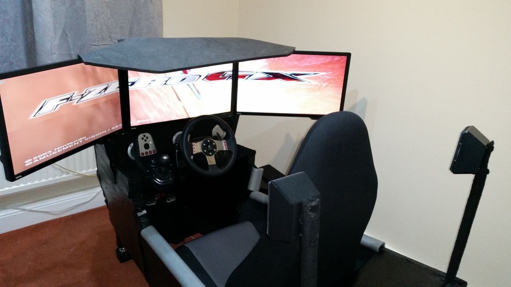

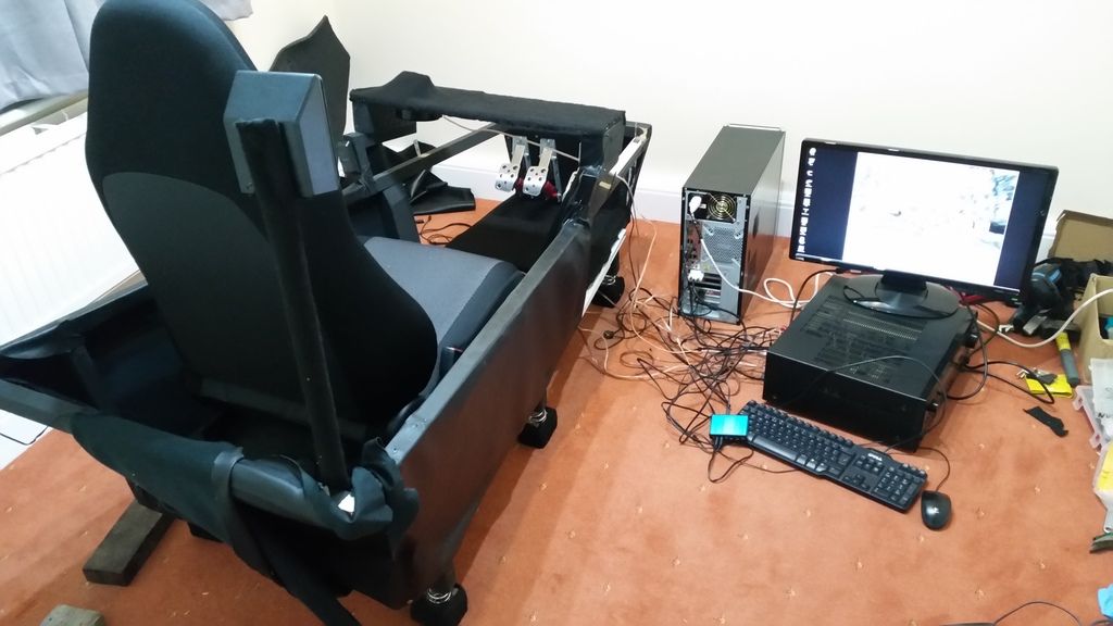

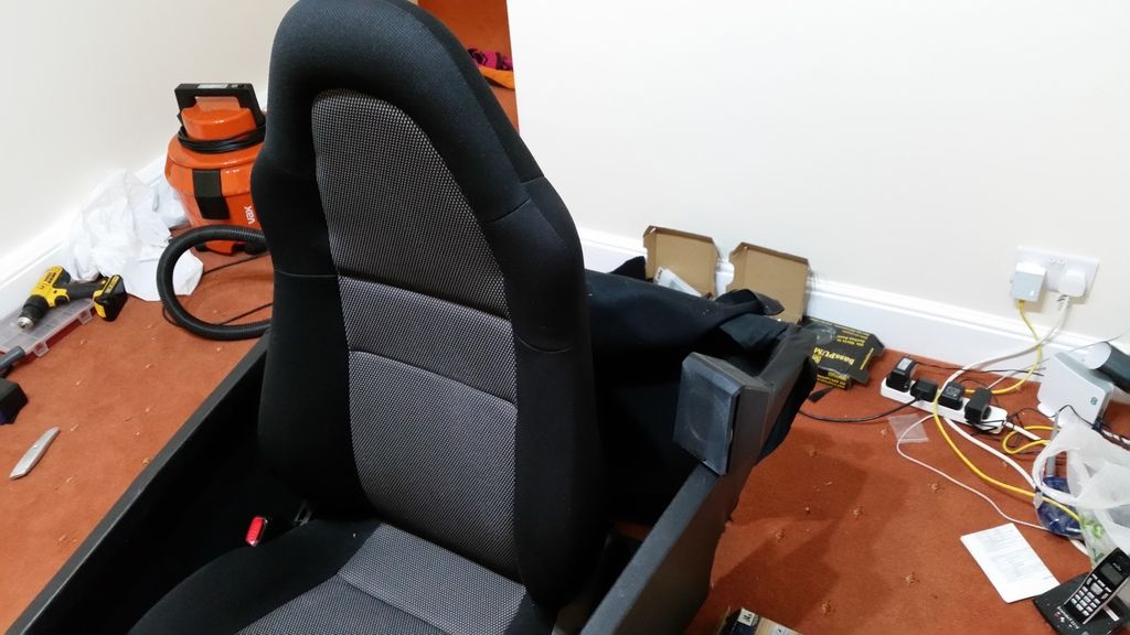

Finally had a chance to start rebuilding the rig.
This is some of the work i have been doing over the last few weeks.
Current transducer set up.
2x clark synthesis transducers

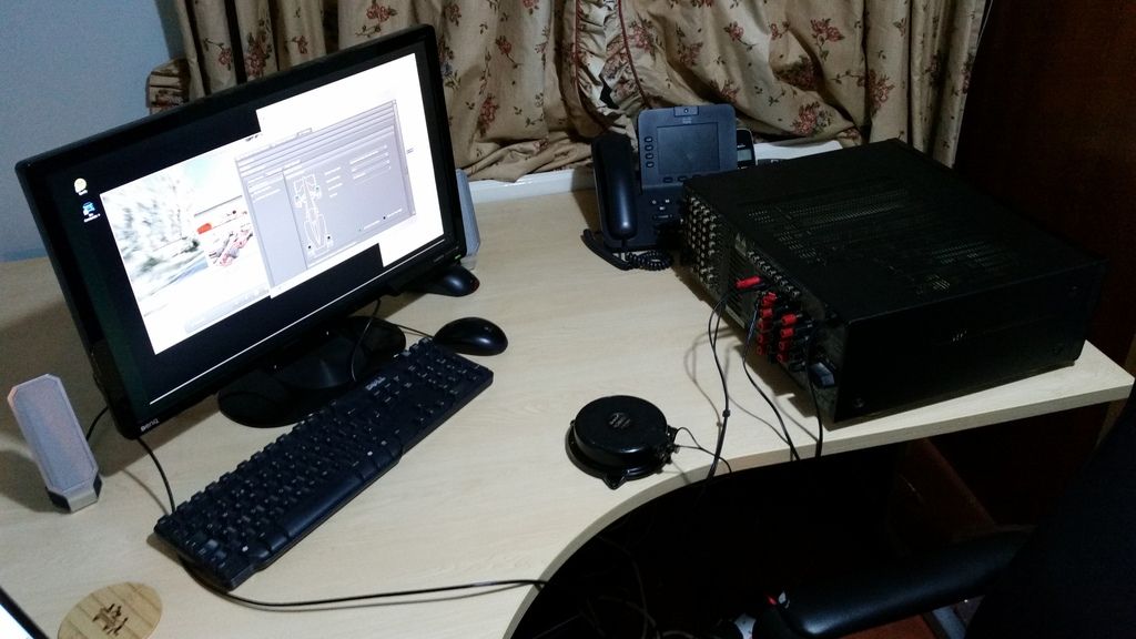

Testing out my denon 7.1 amp and 1 transducer with simvibe.
Amp is going to power 6x 50w 8ohmz sinus live bass pumps running via simvibe.

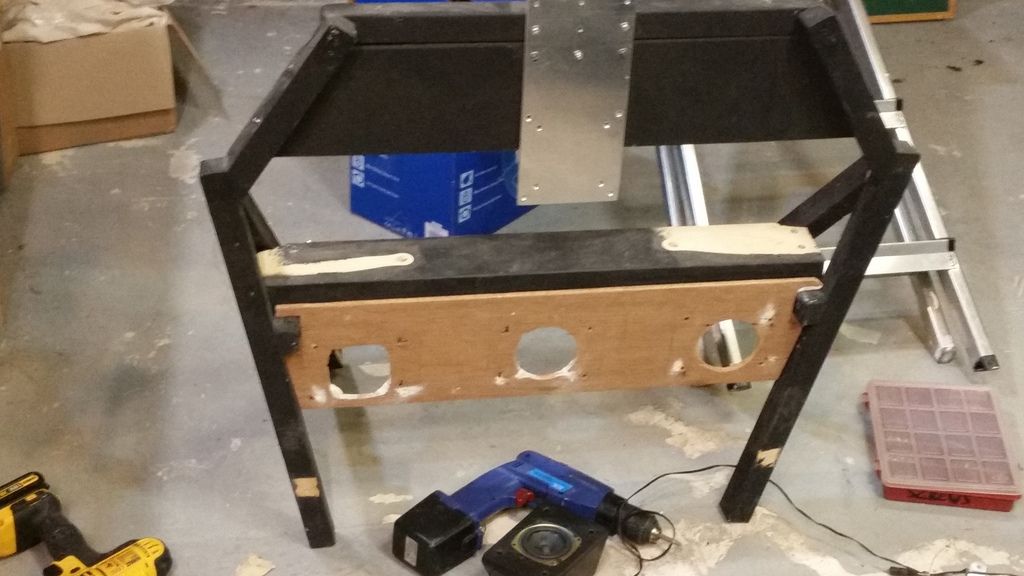

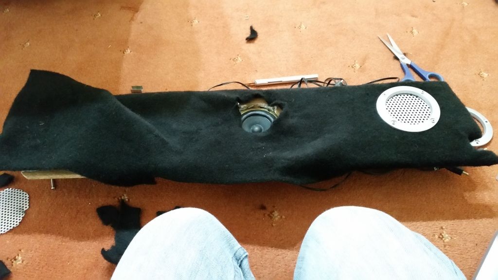

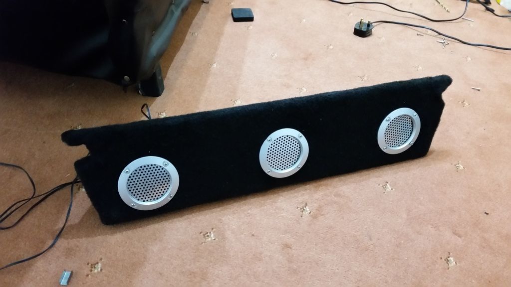

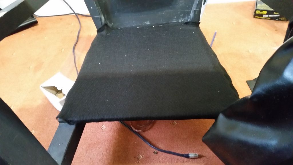

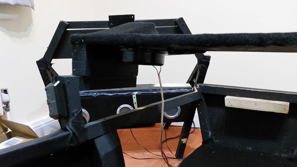

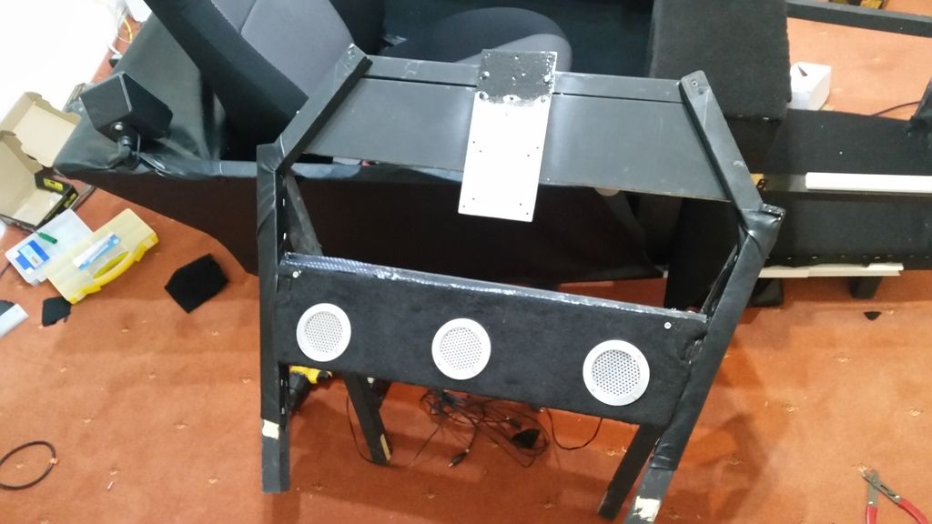

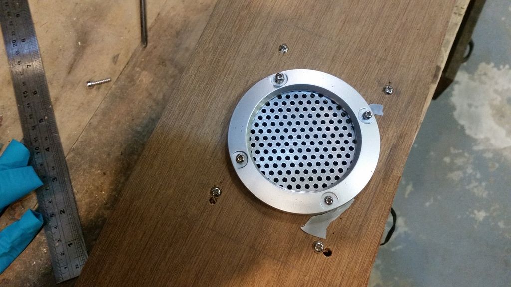

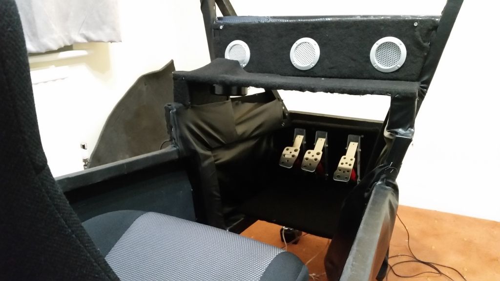

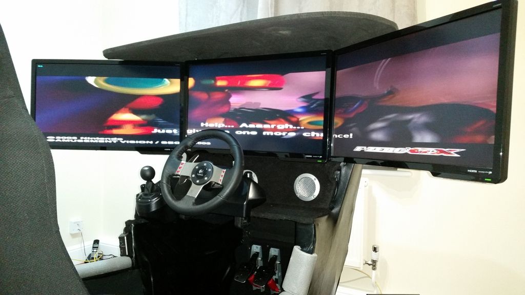

My front and center speakers were mounted on brackets behind the wheel.
I have built a dash enclosure to house them instead, screwed directly to the wood. Then i got some metal to make speaker grills.
Test fitting speaker. Getting everything to line up, cut the holes etc took forever
Carpeting fun
All carpeted, screwed in and speakers tested

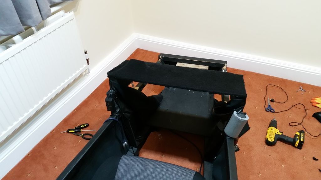

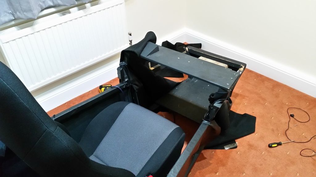

Wheel and gearstick are mounted to this base
Carpetted
ant2
  • Posts: 227
  • Last login:June 02, 2024, 07:05:47 am
Re: triple screen rig

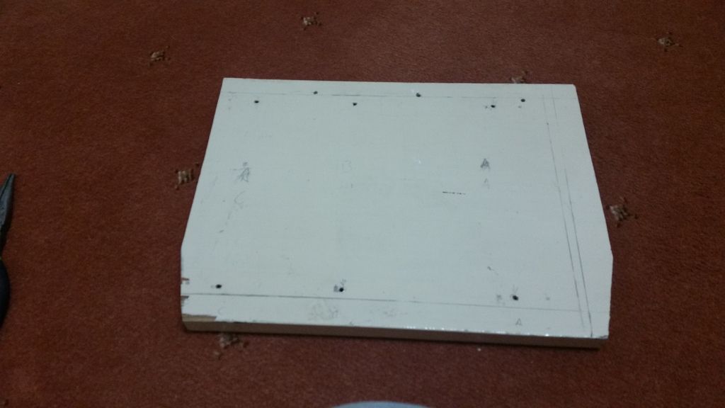

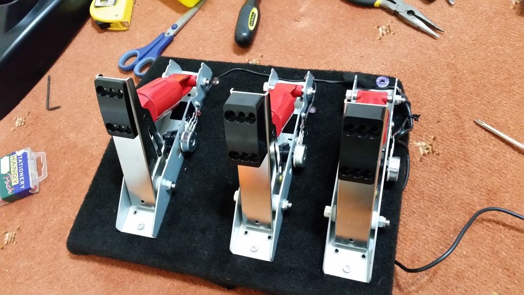

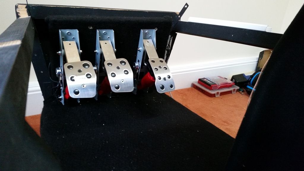

« Reply #4 on: December 10, 2015, 12:30:16 pm »

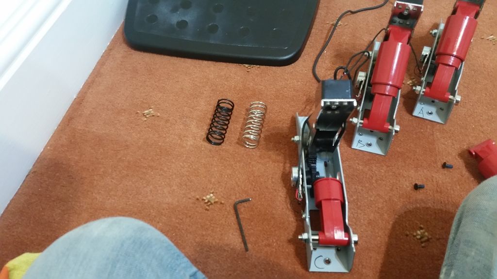

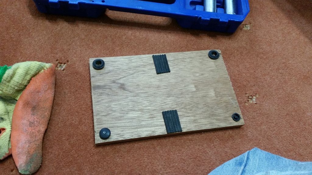

I wanted to reverse mount the g27 wheels. I made a base out of really thick wood.
Upgraded the brake spring from gt eye (thinks the name) and switched the old brake spring to the clutch:
Carpetted and refitted, picture is missing the pedal plates.
This screws in to the block of wood at the front of the rig (see pictures above) will carpet this wood. This puts the pedals at a nice angle.

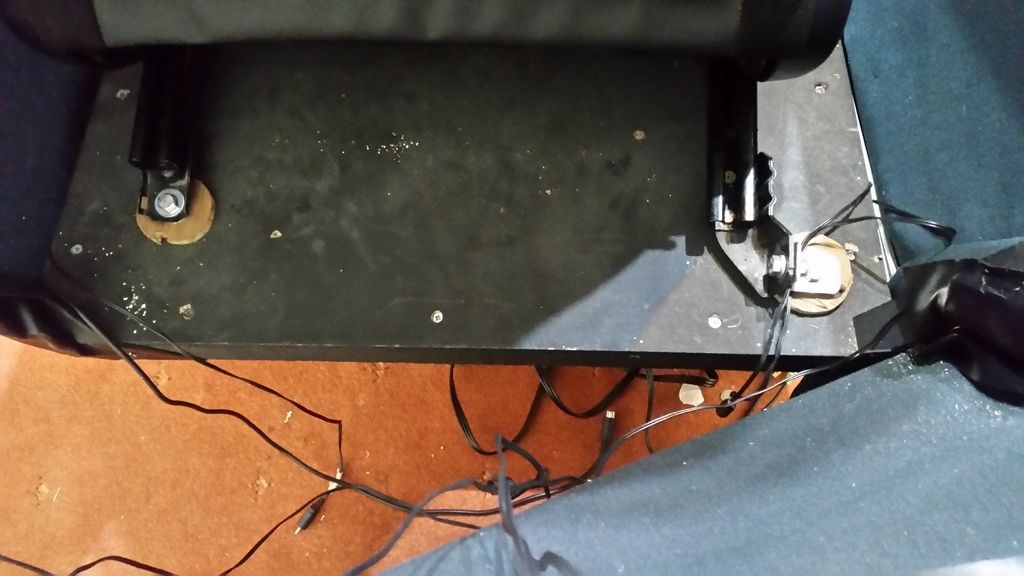

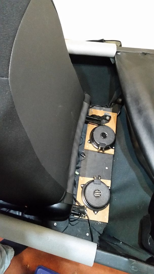

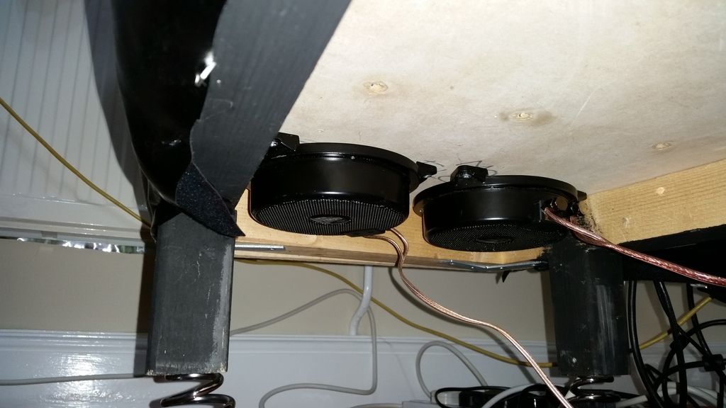

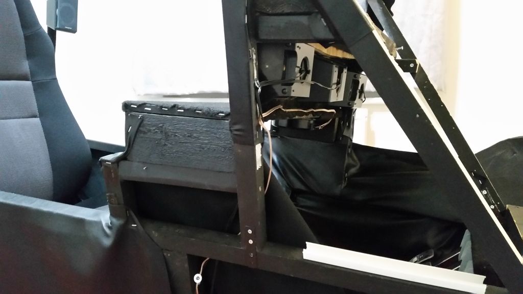

In progress: mounting 4 transducers at all 4 corners and wiring up.
Install transducer behind pedals.
Install transducer under gear stick mount.
Carpet front of rig.

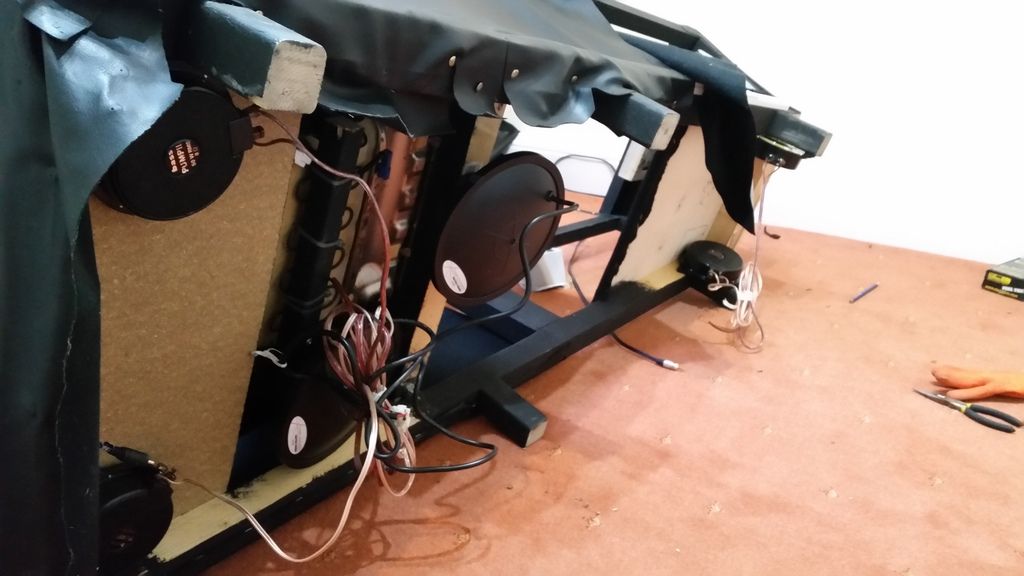

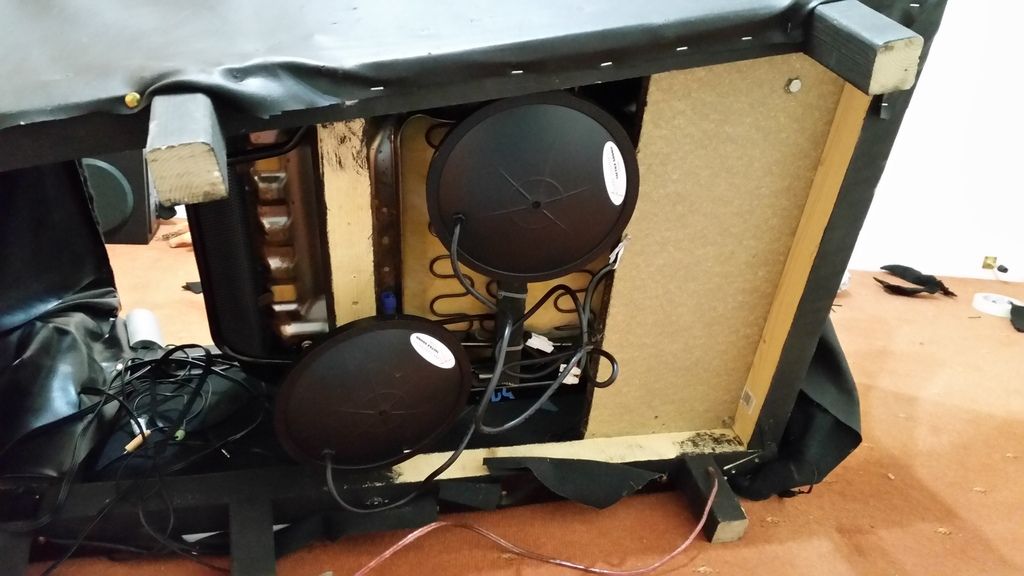

4 extra transducers installed at all 4 corners:

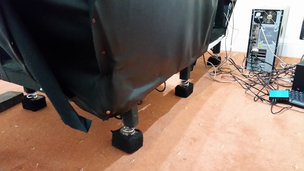

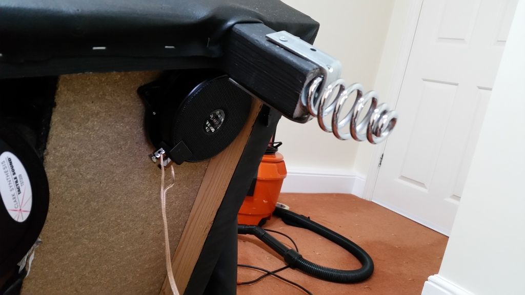

Springs are to improve the tactile. A lot of tactile usually gets lost with it going in to the floor.  I previously isolated the seat well and had rubber on each of the feet for my 2x clarka,  but now im going with the 4 corners etc, the best way to isolate is with the springs.
Love to go with a movement rig, but they are alot of money. Going with these 6 springs,  hoping they will support my weight as they are saddle springs and im only 76kg. I load tested 2 and it seemed very adequate.
Got them really cheap from china, circa  £16 for all 6, so thought if give it a go.
There was a guy using springs units from one of the simracing forums, the ones he bought were from a u.s company and would of cost me £200 odd with all the taxes. But anyway the tactile effects were crazy enhanced, so even if i only get a small boost it'll be worth it.

You might want to consider locking the bass shakers to the actual frame.. and not just the top panels.
 You could try to place some flat 2x4 boards that span the bottom,  and lock in to the frame on the left and right.   You then could screw the shakers onto them,  giving a stronger connection to the entire frame.

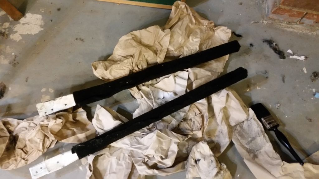

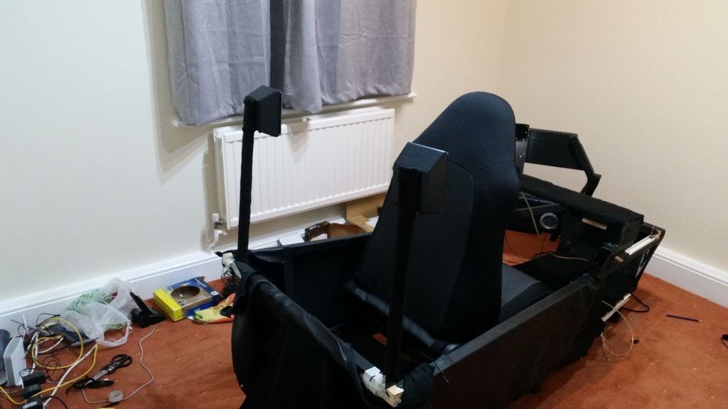

Transducer for shifter fitted:
Started mounting speaker panels, more vinyl covering under way:

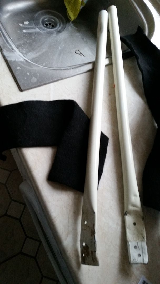

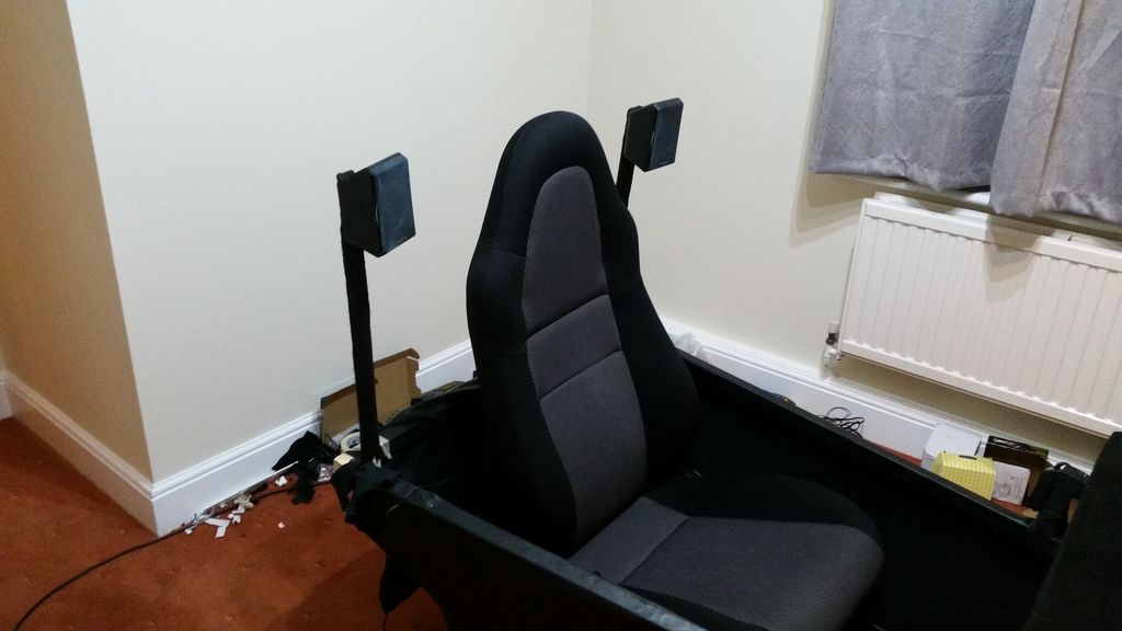

Rear speakers were bolted to the rig:
I wanted these raised up so they were ear level.
Got some old unused metal poles, beat the bottom to make them flat, drilled some holes to screw to the rear corners of the rig.
Covered, just need to cut off excess, thread speaker wires, bolt everything together :
To do:
Finish off rear speaker mounting
More covering
More spring test mounting. -
« Last Edit: December 19, 2015, 07:19:55 am by ant2 »

Rear speakers poles finished.

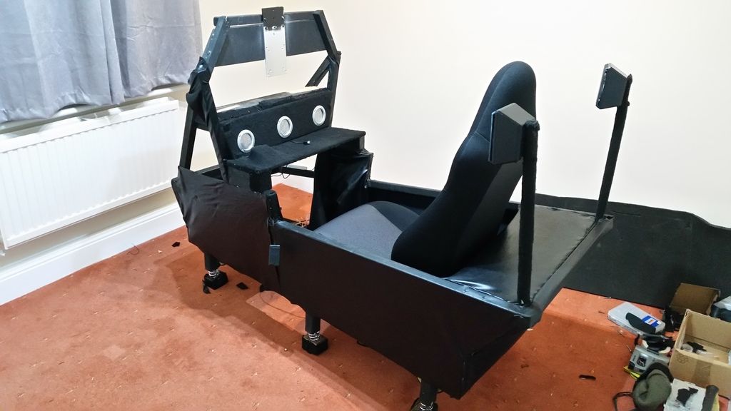

Blocks that the springs will sit in.
Took ages to work out the right hole sizes. - the top was actually bored  out again after this picture from 42mm to 50mm
Finally got it all mounted up. So my rig now has suspension.
The springs started to slightly coil at 70kg. There's 6 on the rig and it feels perfect. Not too firm and not saggy at all.
Spent another 4+ hours getting the sound cards working with simvibe, ensuring all outputs work, levels etc.
Re mounted rear transducers on the feet at the corners like i did at the front. As it was losing too much vibration on the floor and i can't up the volume with this cinema amp wheb using the rca inputs.

 I read someone say, that if transducers are placed horizontally... it will feel and react completely wrong, due to the forces being applied in the wrong vector.
 I suggest keeping them locked to the corners of the frame... but instead of vertically,  mount them on the exact frames corners.
 Screw in a diagonal 2x4 piece,  so that the shakers can mount to both corners, and the diagonal frame section that you add.
That should keep the vibrations strong on the frame.    (not getting absorbed into a flexible seat panel)

Edit:  To further increase the transmitted forces,  You might consider making the frame even more Rigid,  by adding second (or even third) set of long frame 2x4s,  to the main frame.     Glue then Screw them to the main frame, like every 8 inches.
 The more rigid the frame is.. the less likely any vibration will be lost to wood flexing.   Especially now that its suspended in the air on springs.

« Reply #26 on: December 29, 2015, 02:21:23 pm »
Removed rubber dampers since the rig is now suspended and more transducers added.
Pedals mounted in place
Speaker surround in, speaker wiring done
More leather going back in

Where did you read that mounting vertically was not a good idea?
From what i read others have found vertically at the corners was more effective,  apparently the wheel vibrations should then feel up and down, like a real car,  rather than side to side.
 Thats what I read.   That the simulation is designed for vertical changes... not side to side changes.
 Im guessing these is confusion on the mounting terms:
 This Orientation fires / vibrates horizontally:
 (Incorrect Mounting for the Simulation application.   With movies, music...etc... it wouldnt matter)
 ___
 I    I
 I    I
 I__I
 This Orientation fires / vibrates vertically:
 (Correct Mounting orientation for the Simulation)
  ______
 I          I
I have a cross mount in the middle for my sear transducers and i didn't want another bar going across just 6inches back from that, as i won't be able to differentiate the two.
 The cross mount should not matter at all.   The feel is transmitted via the actual vibration (Transducer)  location.    Just like a real car,  Childrens Pull Wagon,  Skateboard... etc.
 Think about the standard Console controllers that have dual motor vibrations...   they are literally inches apart... and yet, the effect of running them at different speeds, creates various effects.   These motors are actually much more limited, compared to a transducer...
 And even more simply and more fully explained:
 If you sat blindfolded, ears covered, and then placed both of your hands on a thick butchers block (only 3 inches apart) ... then had someone drop a marbles on either sides of your hands, as well as in the middle... you would feel where the marbles had hit.
 The location of the Incident, is what tells you.
 The solidity of the surface, is what conducts that force clearly... to allow you to feel it.
 If you tried the same experiment on a rubber mat... you would have a lot more difficult of a time to feel where the marbles landed, how far, and maybe even have difficulty knowing the location.
 Vibrations are much the same as actual audible sound.   If a marble falls in a room... your ears can discern the position of where that sound came from, due to where the soundwaves came from.   However, with soundwaves... its easier, because air is an easy conductor.   If there were no air... then you would have no audible sound.   In a Transducer... its not using sound... its using vibrations.   So the only way it can get those vibrations to you... is via a very rigid material.  A good conductor.    And even then, as said... you will know where that vibration came from,  by its effect and incident location.
 All that said...
 I have heard, that to have a more pronounced and realistic effect... some have placed their transducers further away from their rigs... on outboard frame extensions, extending a foot or more away from the cabinets sides.    This more realistically represents the distance of real tires, away from your central seat location... in the middle.   The vibrational waves thus then take longer to arrive at your location... similar to the timing that it would be for the real event... thus, it feels more like the real thing.
It's worked out quite well in the corners. Ive removed my rubber dampers from the seat mounts today, now that the rig is elevated and i have the four corners.
 Not sure why you would have put those in there... as that absorbs a lot of the vibrations... as rubber is a very bad vibration conductor.

« Reply #30 on: January 04, 2016, 05:53:01 pm »
Transducers at the back still weren't strong enough.  You really need to attach them to the panel you want to move directly or you need a very powerful amp.
I've put the rears on hardwood and mounted them behind the seat,  beneath the rear seat runners. I then elevated the wood with rubber to isolate the vibrations. It's 10 times better now
Mounted
I then moved the fronts directly to the front floor.
Sides were then covered.
Monitors mounted, took hours to get the right heights.
Gear shifter mounted, no longer fitted in original place, so had to cut out some of the sides etc,,annoying.
Steering wheel mounted.
Sub relocated to under the chassis,  cables re run..

« Reply #31 on: January 04, 2016, 06:00:23 pm »
13 months later, it's finally rebuilt and playable again-  I'm loving it:
ant2
  • Posts: 227
« Reply #32 on: January 04, 2016, 06:04:55 pm »
Got fzerogx to play smoothly and set up/tubed up rfactor with simvibe and I'm very impressed, the software is well worth while, even if you only have the one transducer!

Good job.
 Initially, the seat rubber dampeners were isolating the vibrations from getting to the seat.
 Now you have the shakers delivering right to the chairs frame.. which makes a lot more sense.   Dense Hardwood was a very good choice for mounting them on to as well.
 The only suggestion I would make, is possibly to add another set of side speakers.. or rebuild the front box..  as the one speaker is blocked quite a bit, by the shifter assembly.
 A canopy top would be nice, as would an enclosed rear.   Would help keep the sounds inside the cabinet,  keep outside sonds from coming in, as well as keep glare out.. and add more immersion.. as it keeps your eyes from seeing your room.
 Thanks for sharing, and enjoy  :)
ant2
  • Posts: 227
« Reply #34 on: January 05, 2016, 04:28:28 pm »
Thanks.
I was quite upset that when i mounted the shifter that it ended up blocking that left speaker. Had i known i would of moved them all to the right and higher.
But to be honest i am not losing any sound, they were previously mounted even lower and set back, they are 10 times better and the rears sound anazing now, although only really the sims support surround sound.
I previously had side speakers attached to the monitors for 7.1. But i only had about 2 games that utilised them and they got in the way, so i actually removed them. Im not going to remake the front again as it's really not worth the effort, you wouldn't believe how long that took and i am more than happy with the sound now.
If I was going to be picky i might get a more poweful amp for the 2 floor speakers, but i really don't "need" it. My under the seat clarks are powered by a 300watt sub amp and can do all the hardwork.
Yeah I thought about enclosing it, a canopy is a good idea, thing is you have to step up on to the seat to get in now,  so it wont be as practical.  The foam thing is actually quite good with immersion and the monitors are so wide you really don't get any disturbance. Could always turn the lights off and shut the curtains if you wanted to get really in to it :)
