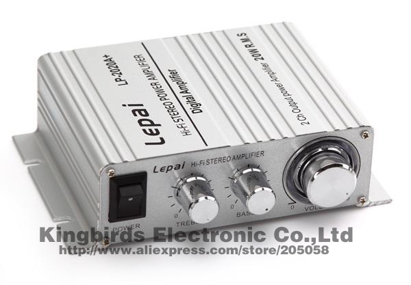

Hi everyone,
I'm building my own MAME cabinet from scratch and having a lot of fun.
I have purchased a pair of 4" Pioneer TS-G1031I dual cone speakers to use in the cabinet. They are 4 ohms, normal power 30W (max power 190W).
How can I connect these to a normal PC in the cabinet? The ends of the cables are not like any I've seen before. Do I need some sort of amp to connect them to before I connect them to the PC's sound card?
adder
  • Posts: 640
  • Location: Easy St.
Re: How to connect 4" car speakers to a PC
« Reply #1 on: October 19, 2015, 06:46:31 pm »
i would recommend a LEPAI 2020A+
i use one and they are great
(you use the MP3 socket on the rear of the amplifier to connect to your PC, using standard 3.5mm audio cable with regular male plugs both ends)

LEPAI changed their name to LVPIN; i would only purchase a LEPAI or LVPIN unit. i can't offer any advice on units with other names, you have would have to purchase at your own risk  :timebomb:
here you go:   ;)
http://www.ebay.co.uk/itm/291589670306
note: although it states to use a 12V 2A power adapter with these amplifiers, it is better to use around a 12V 5A power adapter

i think i heard about someone damaging his lepai amp by turning it on without any speakers, so make sure you never turn it on without speakers connected
ps. if you dont get enough bass out of those car speakers you are using, try using some old hi-fi speakers from eg. a car boot sale etc
you could just place them in the bottom of your arcade cab
it sounds really cool when you crank the bass in some of those old eighties games eg. scramble and have that low floor-shaking rumble sound going on  8)  (push in the tone knob on the lepai amp and set bass at max)

Running it without an amp sounds weak. I tried it with my son's cocktail cabinet (when testing) and it wasn't very loud at all, even with being cranked up 100%. His is running 6.5" Sony X-plod speakers. The onboard sound simply did not have the power to drive them. Sure it would probably take less power to run 4" speakers, but then you run the risk of over stressing the components. An UNDERPOWERED speaker is more dangerous to the components then an OVERPOWERED one, on an overpowered AMP, you can adjust the volume down. Underpowering can destroy the speaker. Any audiophile knows this. Standard speaker jacks on a PC can run maybe a set of headphones at best. I'd much rather do it right and without all the wire splicing/soldering and use a Lepai (Lepy) 2020A+ or equivalent..
You can get one here for about $25 (ships with a 3Amp power supply, which works fine)
http://www.newegg.com/Product/Product.aspx?Item=9SIA1HE2V64865
And if I was gonna do any splicing, I'd splice the 12v power connector and power it with my power supply and not the standard plugin adapter for it because of the previously mentioned issue of needing around 5A to drive it and not the weak 2A it ships with.
That's like trying to drive a huge Rockford Fosgate AMP with a motorcycle battery.
