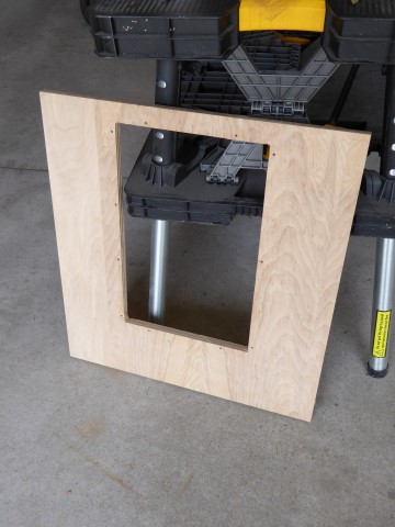

Since I'd like to put an arcade monitor in here eventually I decided to build a "frame" for the LCD and use the same monitor shelf I plan to use for the CRT.  That should hopefully make it easier to swap out in the future.
Similar to what I did on my Pac Man build I used the case to drill out the vesa-mount holes.
Using the Kreg jig it was pretty simple to throw together quickly.
I put a little lip on the front so it can rest at the top of the shelf.

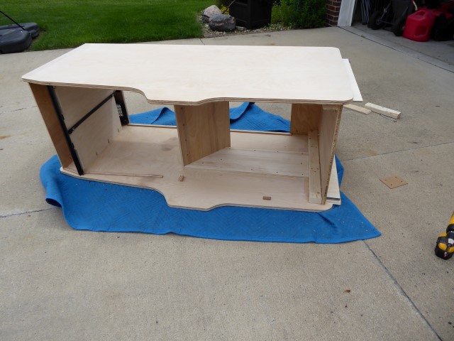

Since zinger found laminate that matches the DK blue we decided to go that direction instead of painting.
So that means pulling the cabinet back out of the basement.  A great side benefit is that I can now spray the black trim which is not something I was going to try in my basement.
Using a Kreg jig meant I could partially disassemble the cabinet to remove the front panel.  I could have applied the laminate with it still installed but it will go much easier this way.
I did have to remove part of the bottom skirting to get at the Kreg screws but that's okay.

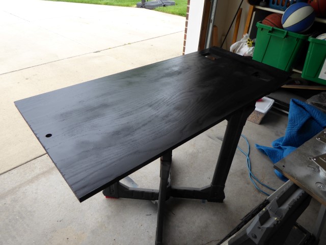

The coin mechs have been sand blasted and painted.  They may get replaced with new ones if I don't like the results.
The inside of the back door has been painted black.  It isn't perfect but it is the inside of the back door so it will be fine.  Also Nintendo back doors aren't all that nice looking anyway.

I was able to get the inside and top primed over the weekend but it has either been windy or rainy since then---when I've had time to paint anyway.   Hopefully I can get a couple of coats of black sprayed tonight.
