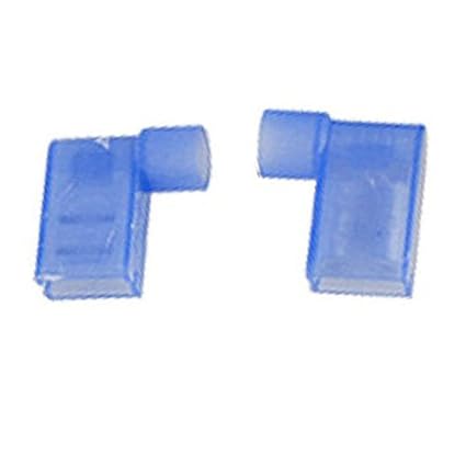

I'm willing to bet it was the gauge of the jumper wire you used. I always use the wire from a computer power cord, extension cord or solid copper 12 or 14 AWG.
Also, I prefer insulated spade terminals vs soldering for this application. You shouldn't have those kinds of terminals exposed.  Here is a picture of the one I just did. (I wired mine differently than yours. I wanted to turn on my marquee light separate from my arcade.)

Yea i'm unsure as to what gage the wire is. I am pretty sure it's the same wire from the power supply which i would assume is thick enough. I'll probably have to buy a new inlet and make sure that I get better wire. I'll try some 14ga to make sure it's enough. I don't think the fuse blew as the power was still connected until i shut down. I will take it out and look at it tonight.
I originally had quick connects on there, but because of space constraints, I had to solder them directly. They would slam into the subwoofer...

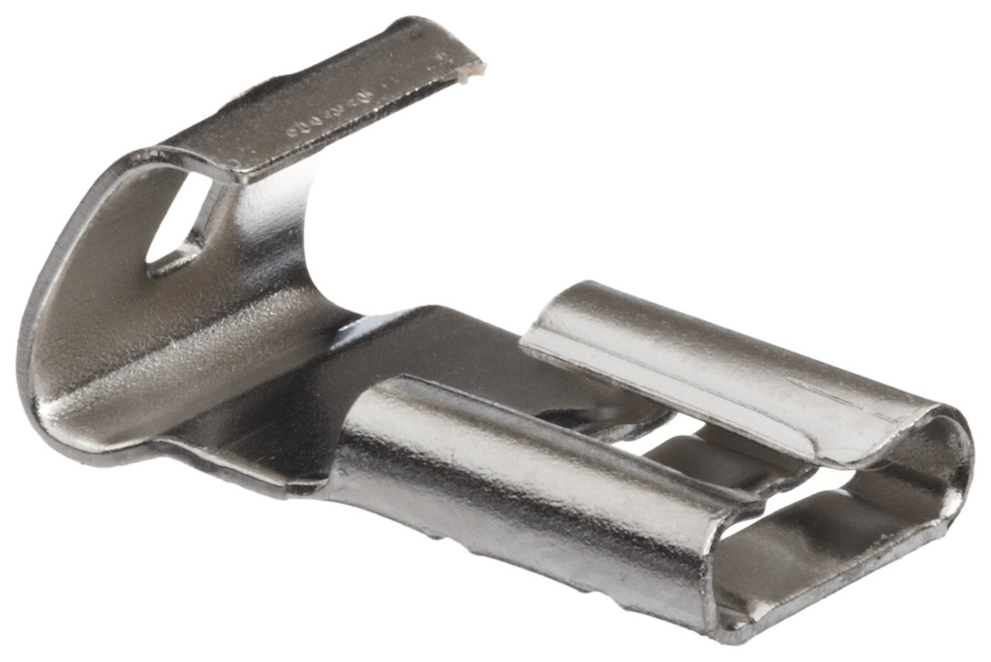

Make sure you have a good mechanical as well as a good electrical connection when you solder in the replacement inlet and wires.
If only a few strands of the power cable are making contact with the terminal, the connection will still ohm out OK, but those strands will have to carry the entire electrical load over that narrow connection.
This can lead to a vicious cycle where the current flowing through that narrow connection generates heat which causes the wire to corrode which increases the connection resistance which generates more heat . . .   :scared

your problem is likely 2 fold...
the wire, if cut from a power supply cable, could still be undersized for the load it's carrying. lots of those cables are "rated" for 10 or 12 amps, but the wire it contains is probably only rated for 5 at most. i've stripped back many a computer cable and even though they are stamped 18ga the wires it contains have been more like 24ga which can only handle about 2 or 3 amps.
secondly, I see you've soldered the wires. these copper wires don't take too kindly to being heated to high temperatures and will oxidise quickly when heated. the short length you have there exasperates this condition by having 2 points of entry for oxygen to get in after it's been soldered and put into service. the oxygen gets in there and eats at the copper...eventually the copper oxides through and the increased resistance caused by it causes the conductor to heat up, make the problem even worse.
you can reduce this issue by using a larger gauge loop of wire or even a piece of solid conductor like romex or best of all, using a IEC block that has the switch already hardwired to the power like so...
http://www.cpaltd.net/rip.php
basically has the IEC input and a tabbed output for a faston style push on connector. no farting around with the switch wiring or anything. it's all internally connected with bus bars.
i think you just have an unfortunate series of events occur that snowballed into your problem. no biggie. best you caught it now than leaving the machine on and going for lunch.

Are you able to use Quick Disconnects instead of soldering?
  • Posts: 9709
  • Last login:Today at 02:33:45 am
Re: Power Inlet problem - help me i'm melting!
« Reply #37 on: September 24, 2015, 04:28:55 pm »
Maybe if he used flag-style QDs.
There is only about a mm of space between the back of this inlet and the subwoofer.
Yes. Yes indeed. If only i'd known about those when I was fixing this up. I probably should have went to a true hardware or electronics store instead of just home depot to find my components. :dunno
