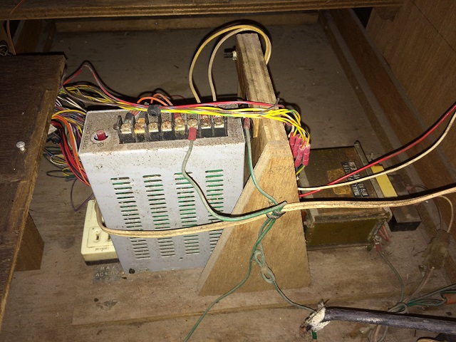

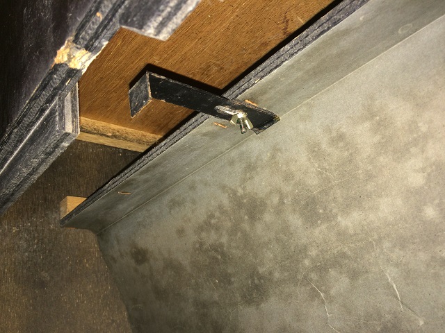

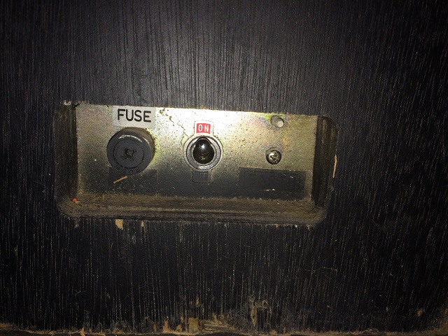

To me, it looked like someone sold it to the people I picked it up from and quickly "flipped it" to a multicade.  The horror!  It had a 60 in 1 in it!
Apparently the previous owner told me that it was under water at one point and it never got fixed.  Luckily for me this is a plywood Nintendo cabinet and not particle board, so there was no swelling and the base of it is in great shape.  :-)

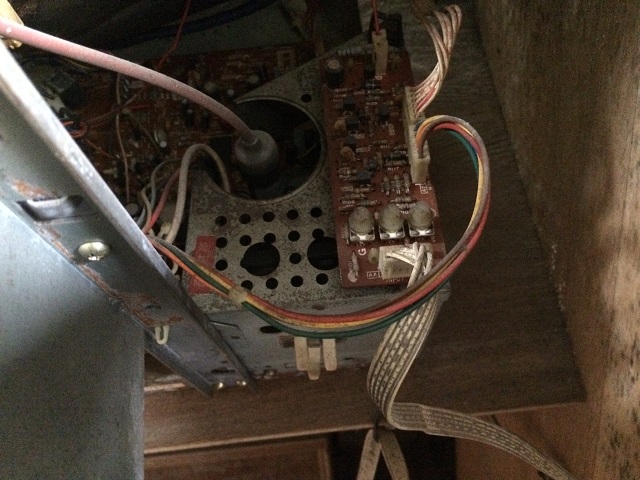

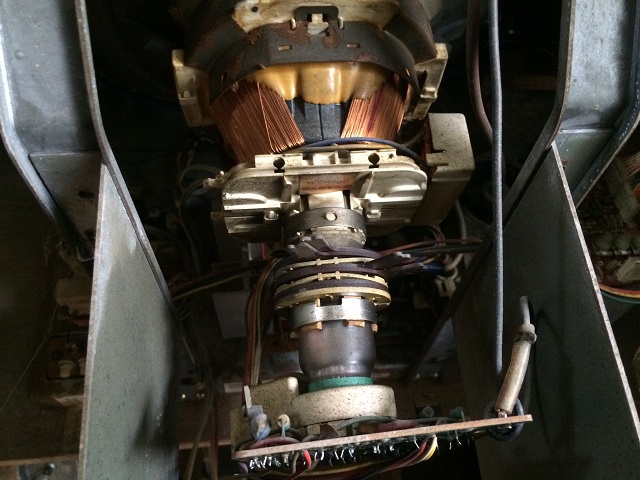

Here are a few pics of the cabinet once I got it home:

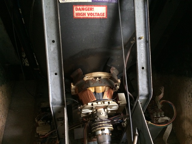

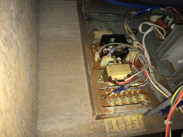

Unfortunately, the monitor is RUSTED.  Not sure if it will be OK, but I decided to clean it up by giving it a wash.  I also grabbed a cap kit from Ian Kellogg here:  https://iankellogg.com/index.php?main_page=index&cPath=1&zenid=7d2crbvoks2a6ecu1re254ohk1  I recommend his kits they are labeled for easy installation:
If all else fails I will throw a PC CRT monitor in there for now.
Here are the pics of the monitor:
Here's a video of me cleaning it with Simple Green and a garden hose:

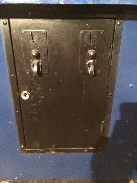

Coin door was painted (including coin mechs): :badmood:  I'll need to order new hardware (only the parts showing) from Mike's Arcade

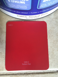

Paint:  I grabbed the same one recommended here by Buckethead for his Radar Scope Red DK restore.
Here's a pic of the color from Lowe's (I ended up using Valspar Signature paint with primer built in - I returned the one shown here because the idiot paint guy tainted the paint by putting an eggshell cover on my semi-gloss paint after mixing it).
