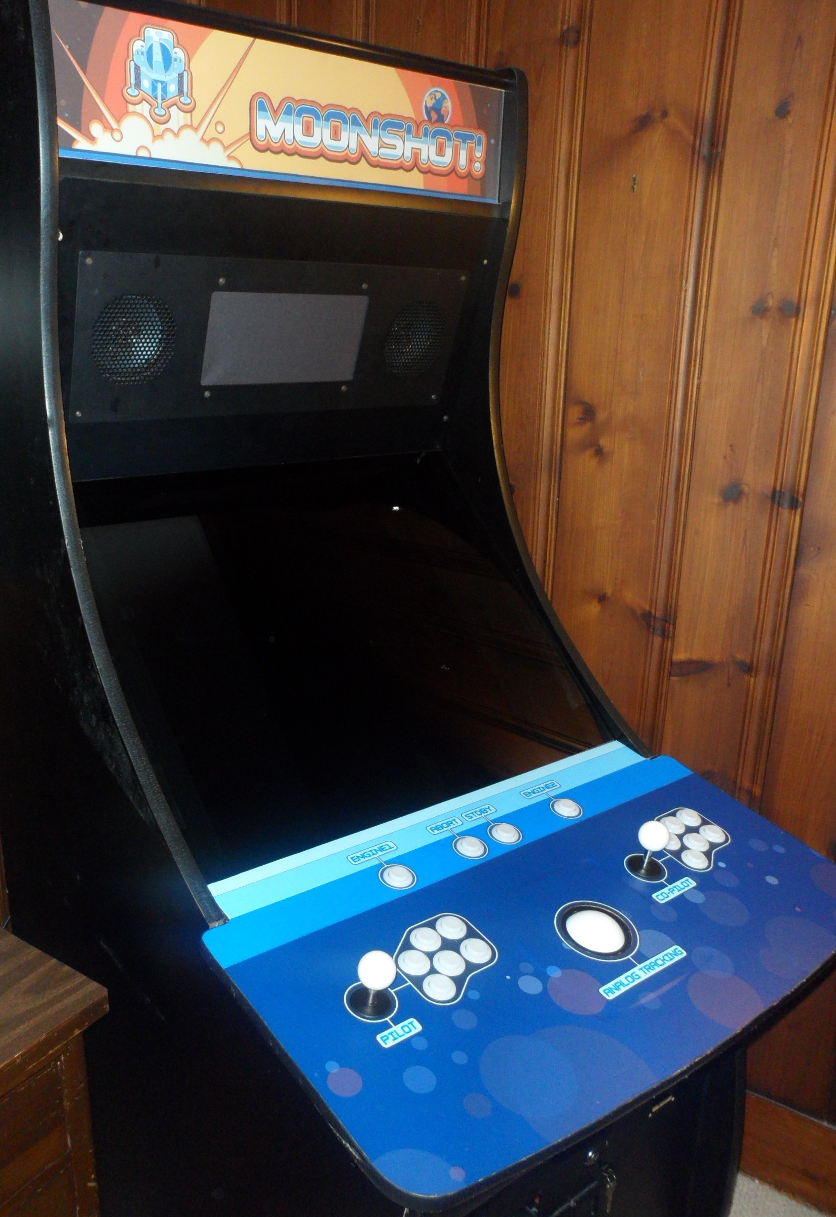

You want some pics, eh?
My goal was for the cab to have finished art installed before the family flew in for their Christmas visit. This year we hosted a total of 16 people for two weeks at our house. Lots of kiddos and a few game-loving adults. But the 2-day USPS delivery took 8 business days (and plenty of complaints to the USPS) to arrive. By that time the family was already here and playing on the cabinet. When art arrived, the cab was decommissioned for the art install.
A few caveats-
1) The T-molding was trashed when I acquired the cab. I will redo at some point in 2016. Your ideas for colors are much appreciated.  :cheers:
2) There are still quite a few finishing details to take care of. There is a hole in the coin door where a bill acceptor used to be. There is also a hole where the player's card reader used to be. There are also some chips and nicks here and there.
3) I really screwed up one area of the CPO install. When the CP was just sanded ply, the trackball mounting plate looked fine. Once I installed the art... well, you can see the plate is not perfectly flat and level. It shows through the art.
4) Yes, that is black construction paper in the back-lit instructions window (between the speakers). I know that is a perfect space for a second screen, but the more I think about installing one, the more I don't want one. Do I really want to run CPWizard? This cab has RGB LEDs and LEDBlinky for control instructions. Feel free to try to convince me one way or another about a second screen.
4) I suck at taking photos.
So the cab isn't 100% complete, but all software, hardware, wiring, controls, and artwork are done!
I can't say enough about BGoulette's artwork.  :applaud:
That is stpcore's printing. Marquee on translite (this pic shows it without the marquee light on and it still looks amazing!), and CPO on vinyl laminated with polycarbonate. This cabinet was used at least 4-6 hours a day for two weeks. The CPO stood up great.
Lots more pics in the next few posts!
« Last Edit: January 06, 2016, 11:24:08 pm by Token »

I think there are two things interesting about this project- BGoulette's retro line art, and the vertical mounted widescreen. Here are a couple pics showing under the hood of the screen is jammed in there.
Here the speaker/instruction card panel and the tinted glass have been removed. With the CP open, you can almost see the entire screen. Only the middle of the TV screen is visible when this is all closed up. The plywood near the top is to block the light from the marquee light from glaring on the TV screen below. Is that electrical tape on the TV frame?! Yes it is. It was a temporary way to black out the metal frame, but with the tinted glass you can't see it at all, so its staying put!  ;D
This TV is 42". It fits, barely, in this cab. Griff somehow jammed a 50" plasma into his build. He is also rich and insane. This pic shows one of the few pieces of interior framing that I kept from the original cab. It holds the glass and has a nifty cut-out for your finger. I had to cut it out and relocate it, which required some pocket holes (Kreg Jig  :cheers:).
For anyone trying to mount a vertical widescreen, the powerstrip utility is a must-have. Keep in mind that some emulators don't play nice with this set-up in full-screen mode, but Hyperspin and MAME do just fine.

I have neither the ability nor patience to wire a control panel like Chance. Here's the evidence--
What's in there? Two crappy Zippyy joysticks (with upgraded soft switches from GGG), 16 RGB Classic pushbuttons from Ultimarc, the original HAPP trackball, an Ultimarc I-Pac Ultimate, and a mess of wires.
Token
  • Posts: 490
Re: Moonshot!
« Reply #95 on: January 06, 2016, 10:54:11 pm »
You all convinced me to go with original art. You helped me layout the controls. Thank you! It turned out great.
I replaced the red balltops with GGG white replacements. Neither balltops nor trackball are LED backlit (like the buttons), but when the cab is off they all look like they were made to go together.
Yeah, see the trackball plate? BGoulette's art makes up for my mistake there.
And the control layout looks good and plays fantastic! Golden Tee and Street Fighter play equally well on this PGA Tour cab. I have no need for other admin buttons or even shifted keys. That's what this is for--
This pic does not do the marquee justice. It looks so nice backlit. And I can't remember who originally posted the pincushioned scanlined Williams S. Sessions splash-screen, but thanks because I love it as my windows background.

harveybirdman
  • Posts: 2540
  • SHMUP'EM
Re: Moonshot! - 95% completed
« Reply #106 on: January 08, 2016, 02:04:45 pm »
Nobody seems very interested in Shmups.
BLASPHEMY!
BGoulette
  • Posts: 192
    • lazerjoose.com
« Reply #107 on: January 08, 2016, 02:05:50 pm »
BLASPHEMY!
Yeah, you need better friends. And family!  >:D
harveybirdman
  • Posts: 2540
  • SHMUP'EM
« Reply #108 on: January 08, 2016, 02:30:18 pm »
yeah I mean... Surely there's SOMEBODY that said, "Yeah, but can it play Galaga?"
Token
  • Posts: 490
« Reply #109 on: January 08, 2016, 02:34:06 pm »
BLASPHEMY!
My youngest daughter loves Bells & Whistles, the cutest Shmup ever, so I guess there's that...   :-\
Yeah, it got played. Lots of other classics too. But nobody camped out on those games.
« Reply #110 on: January 10, 2016, 03:24:12 pm »
Rule #22 in this hobby: No one gives a crap about your favorite games/genres, they just want to play Galaga.
Peabo
  • Posts: 167
  • Pinball junkie
    • Virtual Pinball Build
« Reply #111 on: January 12, 2016, 01:42:49 pm »
Very nice build!  Love the use of the vertical tv
scoodidabop
  • Posts: 143
« Reply #112 on: January 19, 2016, 10:09:17 pm »
lol! Totally accurate.
Token
  • Posts: 490
« Reply #113 on: February 12, 2016, 08:57:05 am »
It's time to set-up a power-button.
I want it to fit the cabinet thematically. I'd really like it to have a cover.
Feel free to chime in with ideas/suggestions.
As cool as the covered toggle switches are, I think it needs to be a pushbutton.
That hazard tape is terrible, but something along these lines might work.
vwalbridge
  • Posts: 2082
« Reply #116 on: February 12, 2016, 11:10:02 am »
Those are interesting. Most people hide the power button out of sight.
Token
  • Posts: 490
« Reply #117 on: February 12, 2016, 02:01:41 pm »
Yeah, that's the backup plan. I would like to find something that will nicely cover up the player's card reader hole in the front of my cab.
A little pricey, but another option:
Those are ridiculously good looking. Thanks!
vwalbridge
  • Posts: 2082
« Reply #118 on: February 22, 2016, 08:39:33 pm »
Hey Token,
2 Questions:
1. How are you powering on your TV inside of Moonshot right now?
2. Does powerstrip allow you to set very precise windows resolutions...like say 1800x1080? And then only have that portion shifted directly to the left or right of the screen? Does that make sense?
Token
  • Posts: 490
« Reply #119 on: February 23, 2016, 08:26:14 am »
I have a hole in the front of the cab where the players' card reader used to be. I mounted the old Dell's power button inside there.
Yes, very precise windows resolutions are doable. However, they are automatically centered. You can adjust the position on screen, but in my experience if I try to move it around too far off-center everything crashes. YMMV. My TV is mounted almost centered, so my custom resolution is only a couple inches off center.
